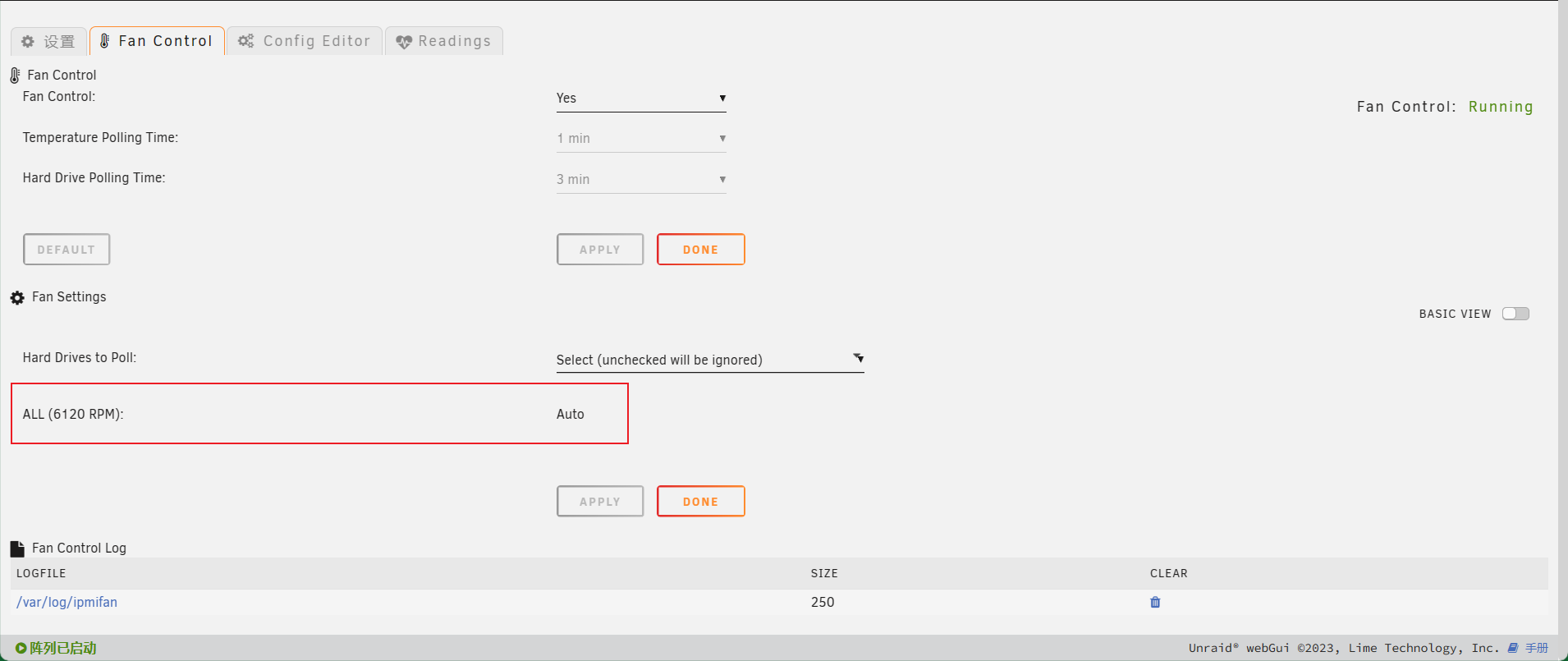

Thank you for reminding me,but seems to be different? it shows  “Auto” ?

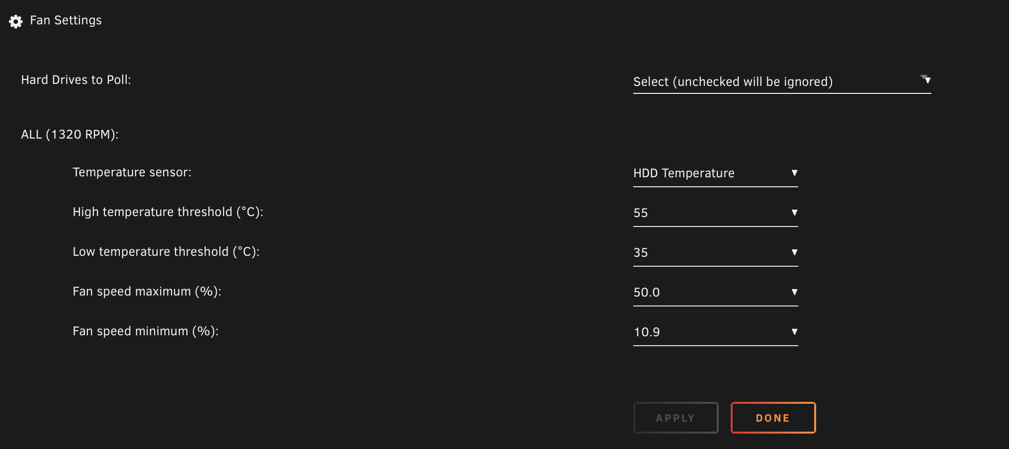

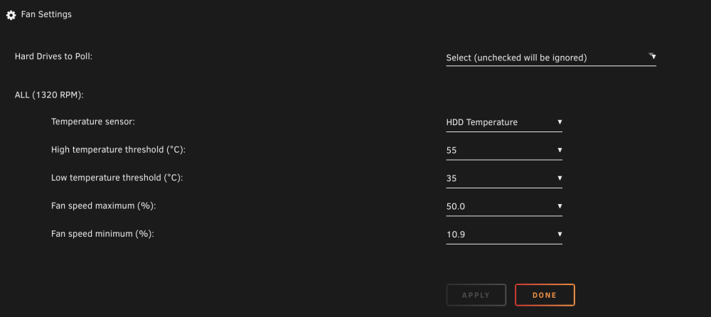

set fan control to no and hit apply, the change auto to hdd temp and set you hi and low. you can not change settings while it is running
Edited by spl147

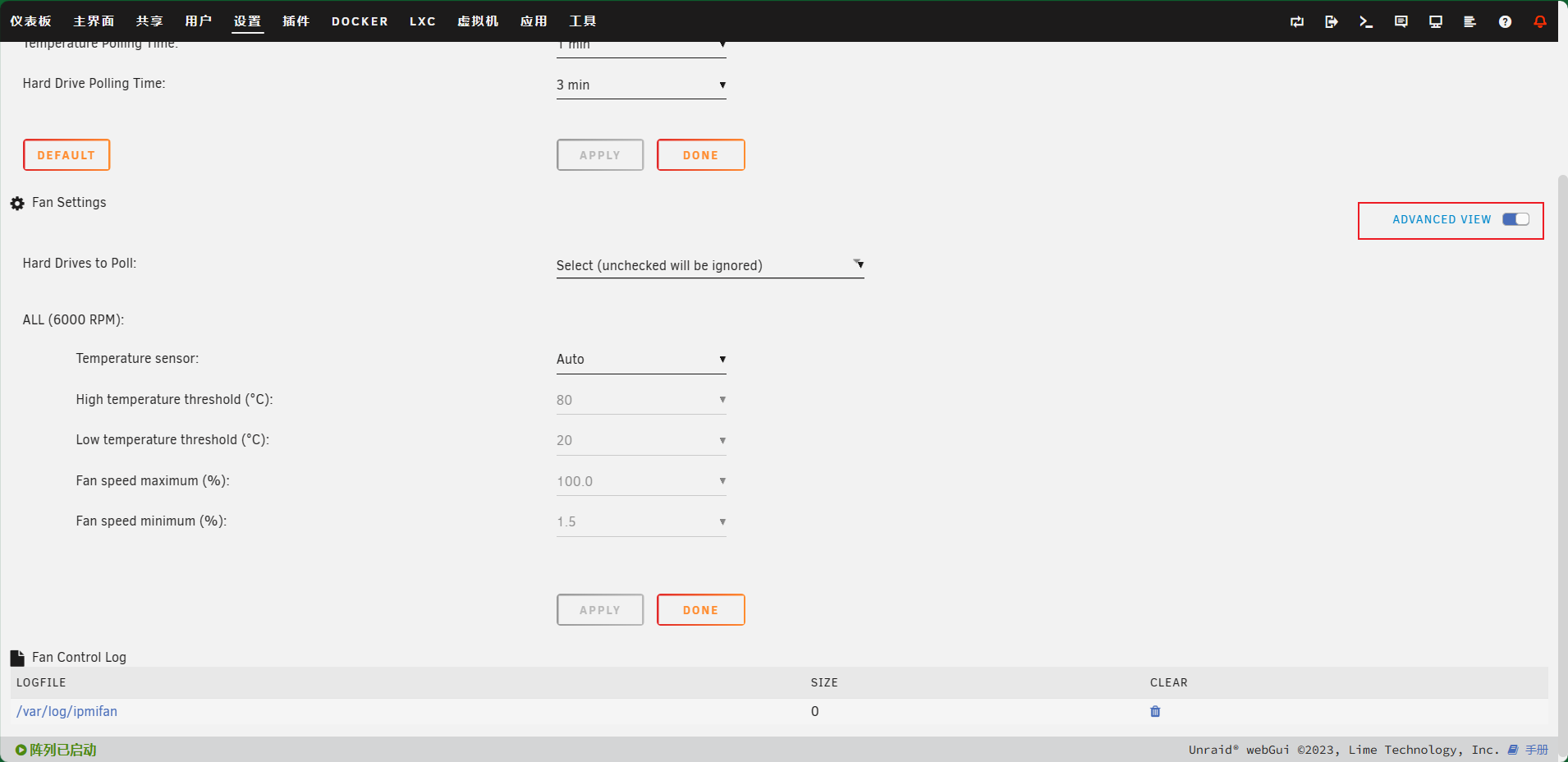

thanks . my mistake ,i found it in “ADVANCED VIEW MODE“

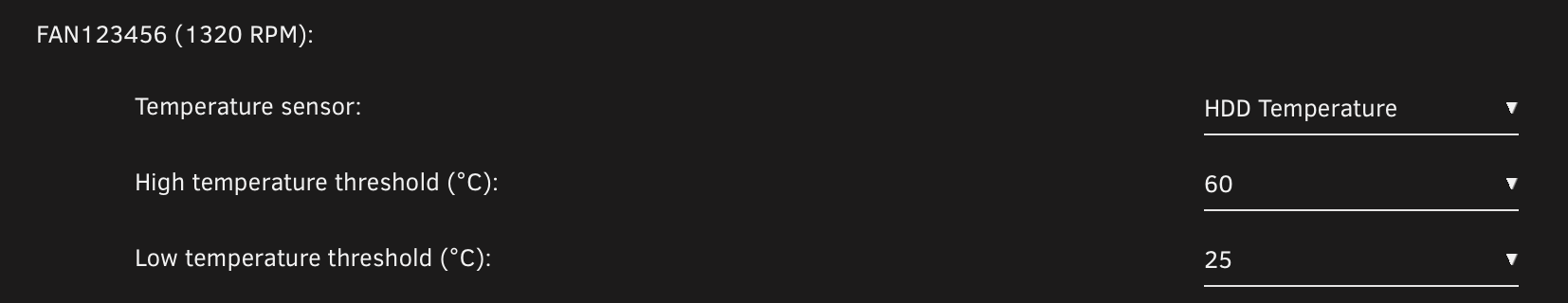

log is showing this: 2023-12-02 11:43:56 Fan:Temp, FAN1234(19%):HDD Temp(39°C), FAN123456(22%):HDD Temp(39°C)
What is defined in here -> cat /boot/config/plugins/ipmi/fan.cfg
root@Server:~# cat /boot/config/plugins/ipmi/fan.cfg
FANCONTROL="enable"
FANPOLL="1"
FANIP=""
HDDPOLL="6"
HDDIGNORE="Samsung_SSD_990_PRO_2TB_S73WNJ0W808832E"
HARDDRIVES="enable"
FAN_FAN1234="39"
TEMP_FAN1234="99"
TEMPHI_FAN1234="55"
TEMPLO_FAN1234="35"
FANMAX_FAN1234="32"
FANMIN_FAN1234="7"
FAN_FAN123456="39"
TEMP_FAN123456="99"
TEMPHI_FAN123456="55"
TEMPLO_FAN123456="30"
FANMAX_FAN123456="32"
FANMIN_FAN123456="4"
FANCONTROL="enable"
FANPOLL="1"
FANIP=""
HDDPOLL="6"
HARDDRIVES="enable"
FAN_FAN1234="39"
TEMP_FAN1234="99"
TEMPHI_FAN1234="55"
TEMPLO_FAN1234="35"
FANMAX_FAN1234="32"
FANMIN_FAN1234="7"
FAN_FAN123456="39"
TEMP_FAN123456="99"
Can you remove the fan1234 entries then restart fanctl it should only report fan123456 in log
just did that and yes it is fixed. i guess the config was not overwritten, but appended
