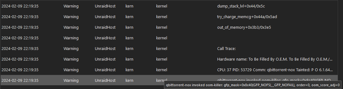

  6. @H2O_King89 if you're still getting this, it looks like its a docker container OOM error, so one of your containers has an nginx process, and that container hit its memory limit so the system started killing the process with the largest memory usage in that container, you your case its nginx. You can tell because of the gfp_mask, it has value GFP_NOFAIL

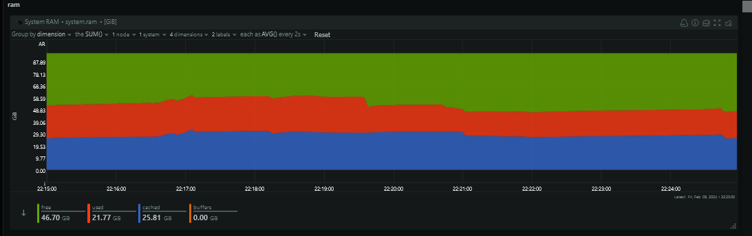

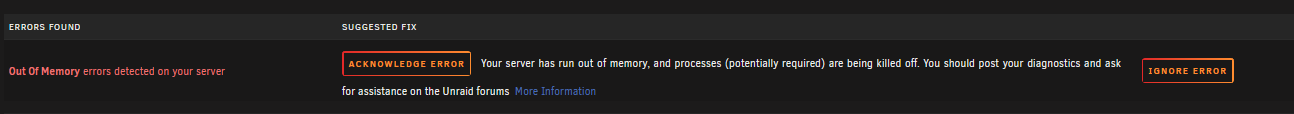

  7. It looks like when you assign a docker container a memory limit and it violates that limit, FCP sees that as an OOM error for the entire system, which is incorrect. I would like to see system level OOM errors be a separate alert from container limit violation OOM error with the docker limit set to be a warning and system level remain as an error as it currently is. Plenty of memory available during the timeframe of the issue it looks like a difference you can key off of is the gfp_mask, it has NOFAIL for docker kills, but total system OOM gives something like GFP_KERNEL
