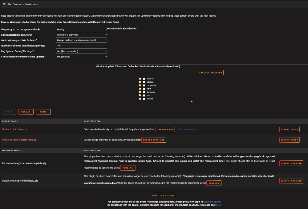

This plugin is designed to find and offer up suggestions to a multitude of configuration errors, outright problems, etc for numerous aspects of your unRaid server.
To install this plugin, just head over to the Apps tab and search for Fix Common Problems.
After installation, you will see a lifesaver within Settings / User Utilities which will launch a manual scan (and give you the option to set the background scan settings)
For every error or warning that this plugin finds, a suggested course of action will also be displayed.  Additionally, should you seek additional help for any error / warning, the errors are all logged into your syslog so that persons helping can easily find the issue when you post your diagnostics.
Scans can be scheduled to run automatically in the background (you have the option of hourly, daily, weekly, and monthly).
Additionally, if the background scans find an issue they will send out a notification (depending upon your notification settings in this plugin)
The current list of tested items will be maintained in the second post of this thread.
Any support for problems this plugin finds, should be posted in the General v6 section of these forums.  Problems relating to false positives, suggestions for more checks, why I made the decisions I did, wording mistakes in suggestions, etc. should be posted here.
As usual for anything written by me, updates are frequent as new ideas pop into my head.  Highly recommended to turn on auto-updates for this plugin.
Most of the tests will include a link to a "More Information" post about the specific error.  These are all contained within this thread:

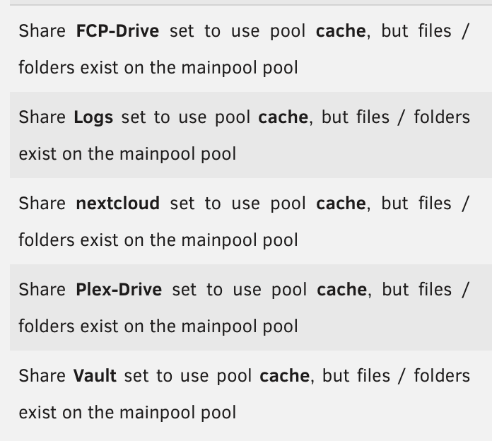

  • Implied Cache Only shares do not have files / folders stored outside the cache drive
  • Cache Only shares do not have files / folders stored outside the cache drive
  • Array Only shares do not have files / folders stored on the cache drive
