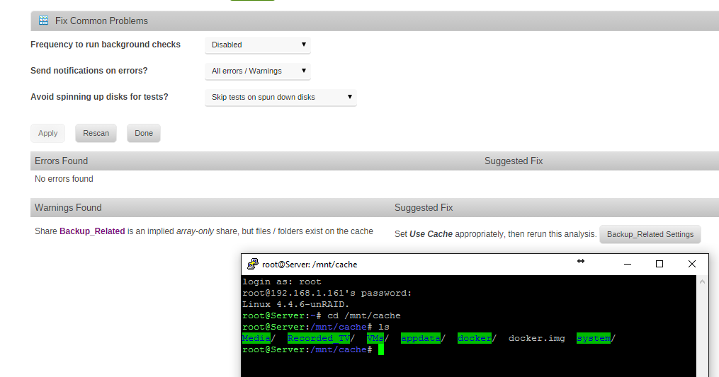

I have a warning for a share which is array only that states there are files on the cache drive, however this is not the case.
Screenshot attached of the warning, and SSH ls of the contents of my cache drive.
I'll check it out and fix it on tonights update
