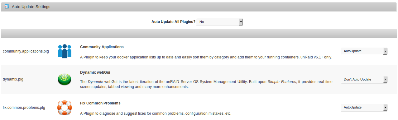

My personal opinion, I think that the auto-update for this plugin (Fix Common Problems) should be a Warning not an Error, but it's not a big deal.
With tonight's / tomorrows update I'll add it to the docker FAQ as its going to do some tests that CHBMB is bugging me to add for installed apps
And the constant updates is why its an error - I know how I do software - small updates, update often rather than large updates, update rarely

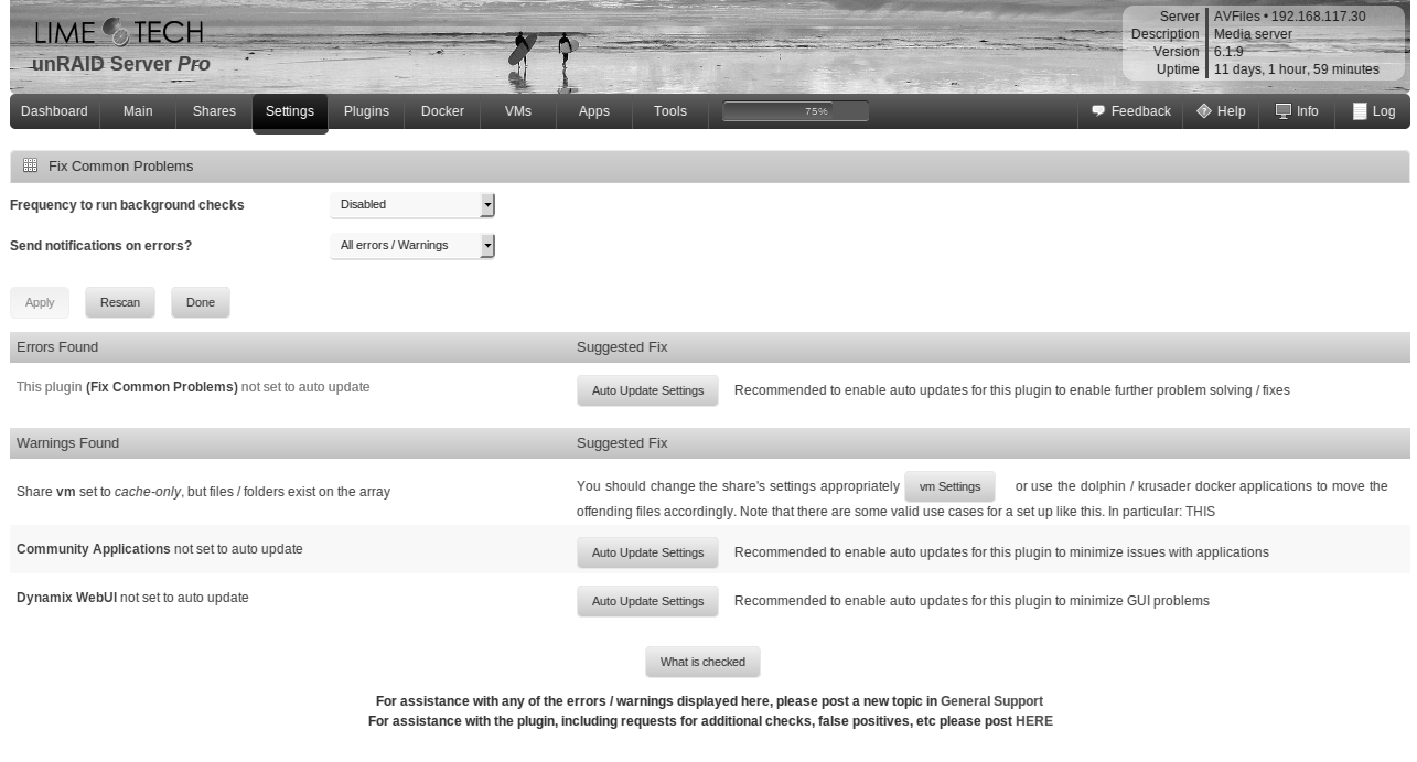

What would you like to see or want me to check to fix the following discrepancy?
Errors found in auto update.
Make a change and then apply it.  Known issue as posted in 3rd post.  Needs an update to CA to fix

Should this be considered to be a false positive?
The plugin dynamix.smart.drivedb.plg is not known to Community Applications and is possibly incompatible with your server
EDIT: I should add that the SMART drive database updater plugin is one of bonienl's and it first appeared here: https://lime-technology.com/forum/index.php?topic=47875.msg461469#msg461469. I'm using it with both unRAID 6.1.9 and 6.2.0-beta21.
Under the criteria  it is a valid error.  However since its from bonienl it can be considered a false positive.
This is why this is a warning and not an error.  Only way to do things to get rid of the 6.0 plugins

That's OK. Thanks for replying. As you say, it's a warning, not an error - I can ignore it. There are three other warnings and two error messages that I ignore too. They're all related to my not having auto-updates enabled - I simply don't like things auto-updating and I'm happy to take the responsibility for manually updating. I would prefer it if they were all warnings, rather than two ("Plugin Update Check not enabled" and "This plugin (Fix Common Problems) not set to auto update") being errors, but again, I can ignore them.
I want those two to be errors, because without autoupdate, I think that the fix plugin winds up being rather pointless if its running in the background, and the new checks don't get automatically pulled into it.
But, I can also see your point (and RobJ's).  I'll add an option to degrade those down to warnings (so at least on background checks you can leave notifications on), but I'm not going to add a drop down to select it.  Rather it'll be some file or something on the flashdrive you create to set it to downgrade.
That way, the I can have my way by default, and you can get yours.  The last thing I want is for people to run background checks and ignore errors
