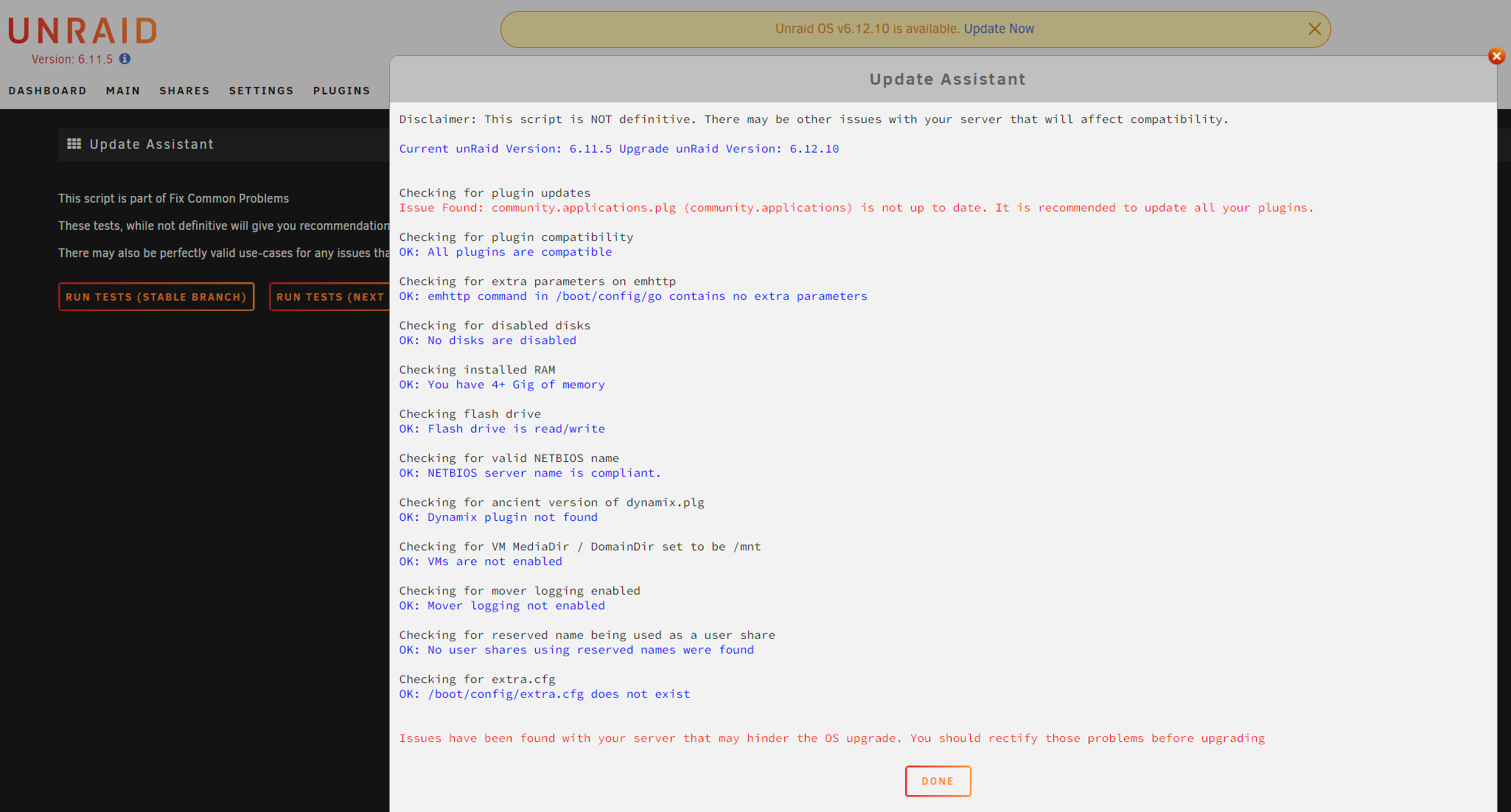

  • Mainly because my keyboard is worn out from replying "Uninstall Advanced Buttons", today's update features an "Update Assistant" which sits on the Tools Menu (next to Update OS)   This perfo
  • kennymc.c
    kennymc.c
    The included Update Assistant tool still shows 6.12.10 as the latest version. Is this a know issue as the update process has changed with the previous version?
