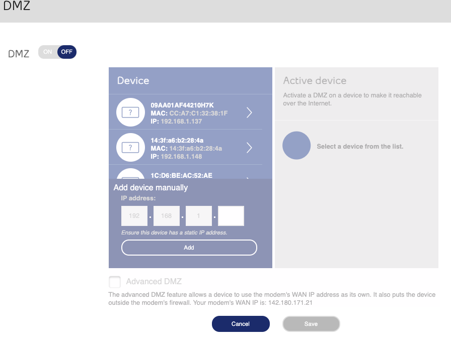

Is your server sitting in your router's DMZ?  You do have 800+ login attempts from around the world.  Pretty much every script kiddie out there.
Sorry for the noob question, but how do I check this?
Depends upon your router.  Log into it and check for DMZ akin to
Placing your server within a DMZ effectively puts the server directly on the internet, and is not recommended.  Forward ports instead.  Another possibility is that you've forwarded the SSH / SSL ports in which case you should use a reverse proxy (or ideally once 7.x is released TailScale)

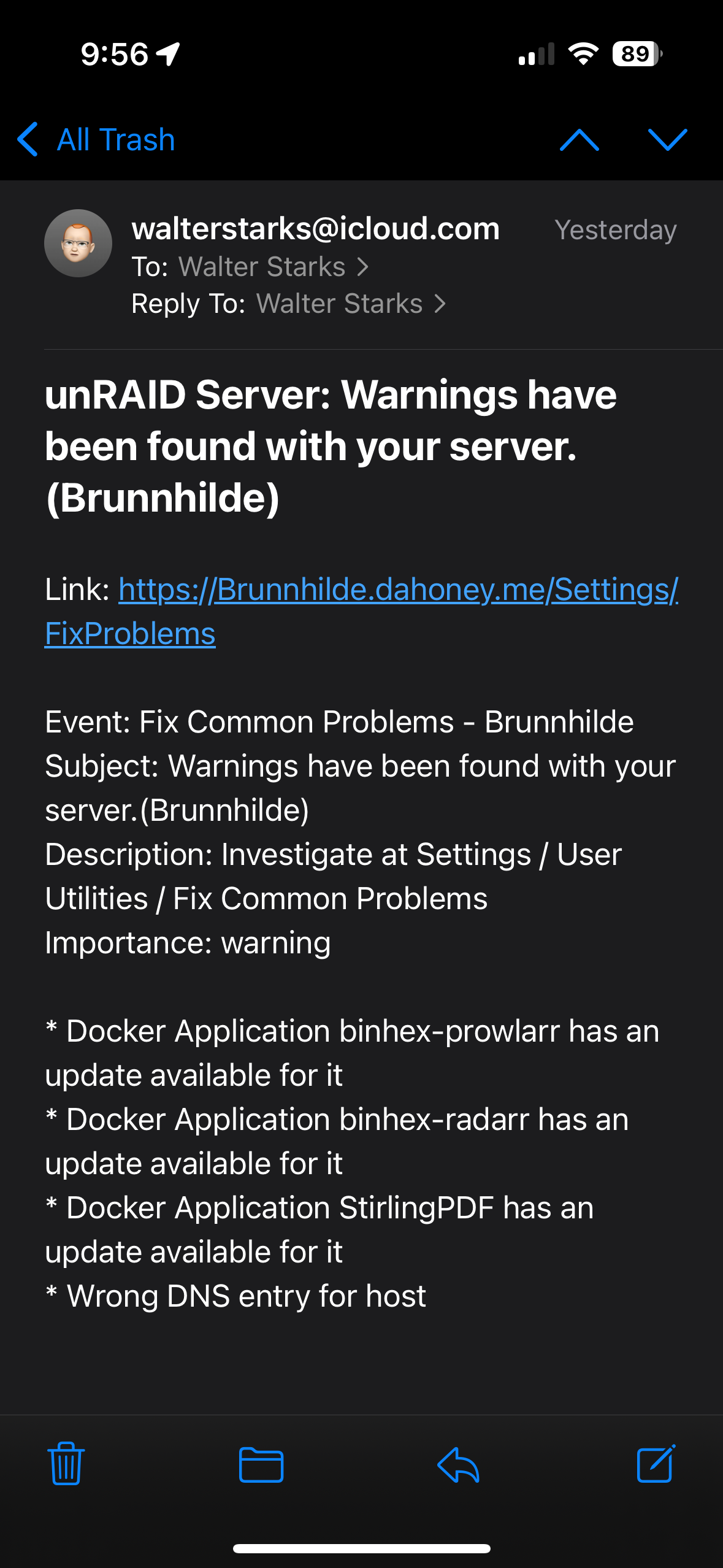

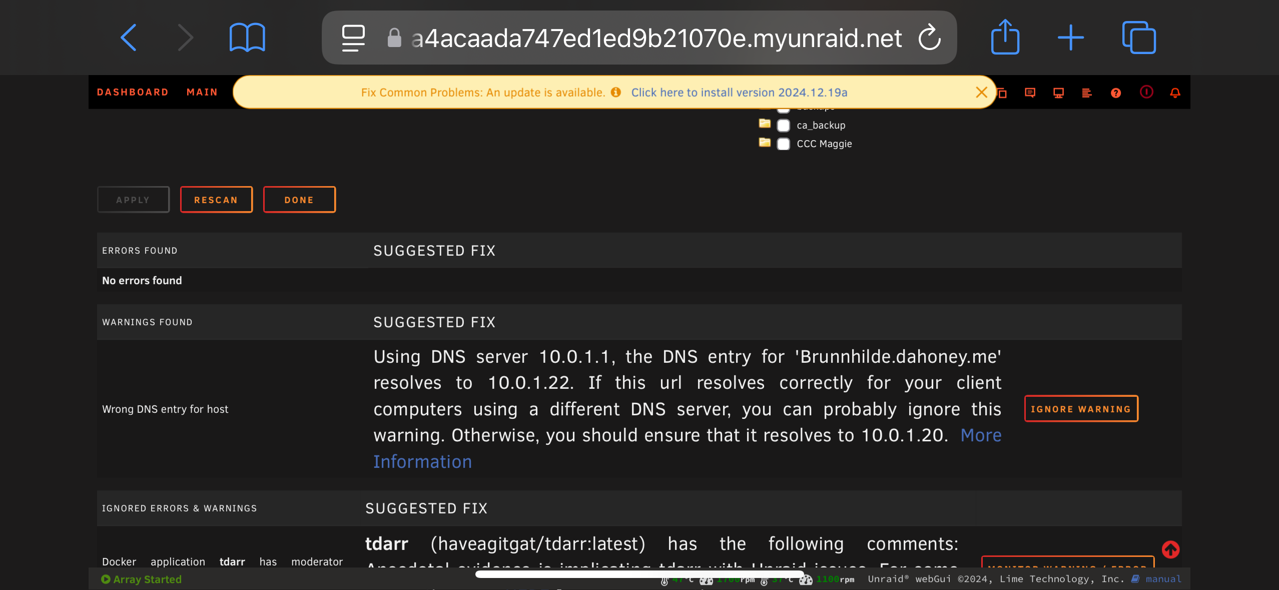

I keep getting a notification for “wrong DNS entry” which is a false positive but I don’t see anywhere in Settings/FCP to ignore this error. The warning isn’t shown there at all.
  Can you show me a screenshot of the notification.  And include your diagnostics
brunnhilde-diagnostics-20241223-0957.zip
I was wrong that the warning didn’t appear in settings (2nd screenshot). Not sure how I missed it.😳
It is false though. All the machines on my local network use my pfsense router for primary DNS. If I browse to Brunnhilde.dahoney.me from any machine on my local network I get the Unraid login screen rather than the IPMI login which is at 10.0.1.22. I’ll just ignore the warning for now.
I did tweek the DHCP reservations in pfsense. Maybe it takes a while for FCP to see the changes?
This appears to be the case. After a short wait and re-enabling the warning it doesn’t show on a rescan.

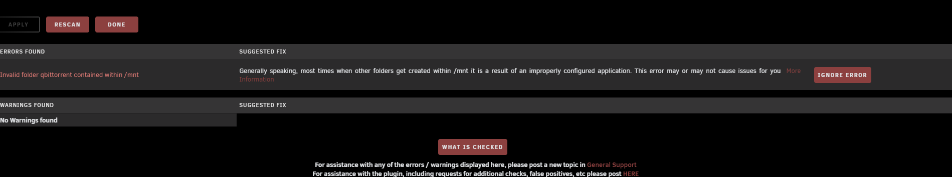

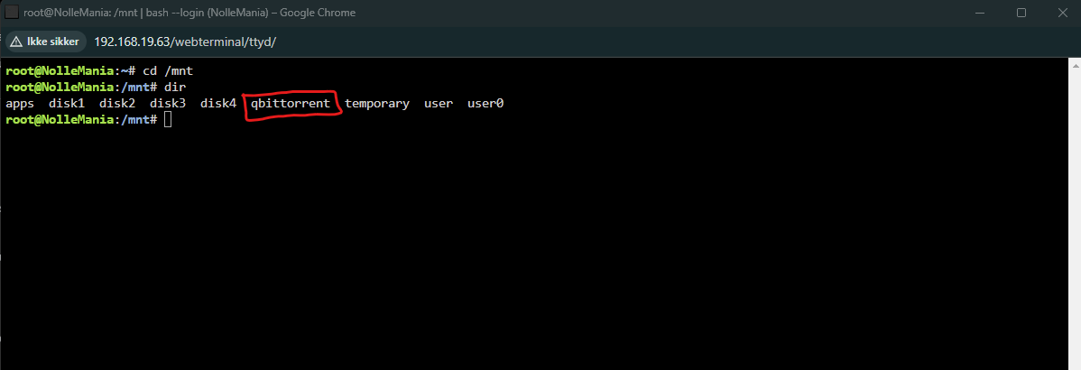

I would like to get some help with this alert from "Fix Common Problems"
I have removed an old Pool by the name qbittorrent, after that this alert appeared. I have tried too reboot, to see if that would remove it from /mnt, but its still there.
What can I do too fix this alert?
nollemania-diagnostics-20241228-0046.zip
Look for a docker container which is referencing /mnt/qbittorent.  It will wind up recreating it and causing the error
Thanks for the solution. That fixed my problem. Very much appreciated.
