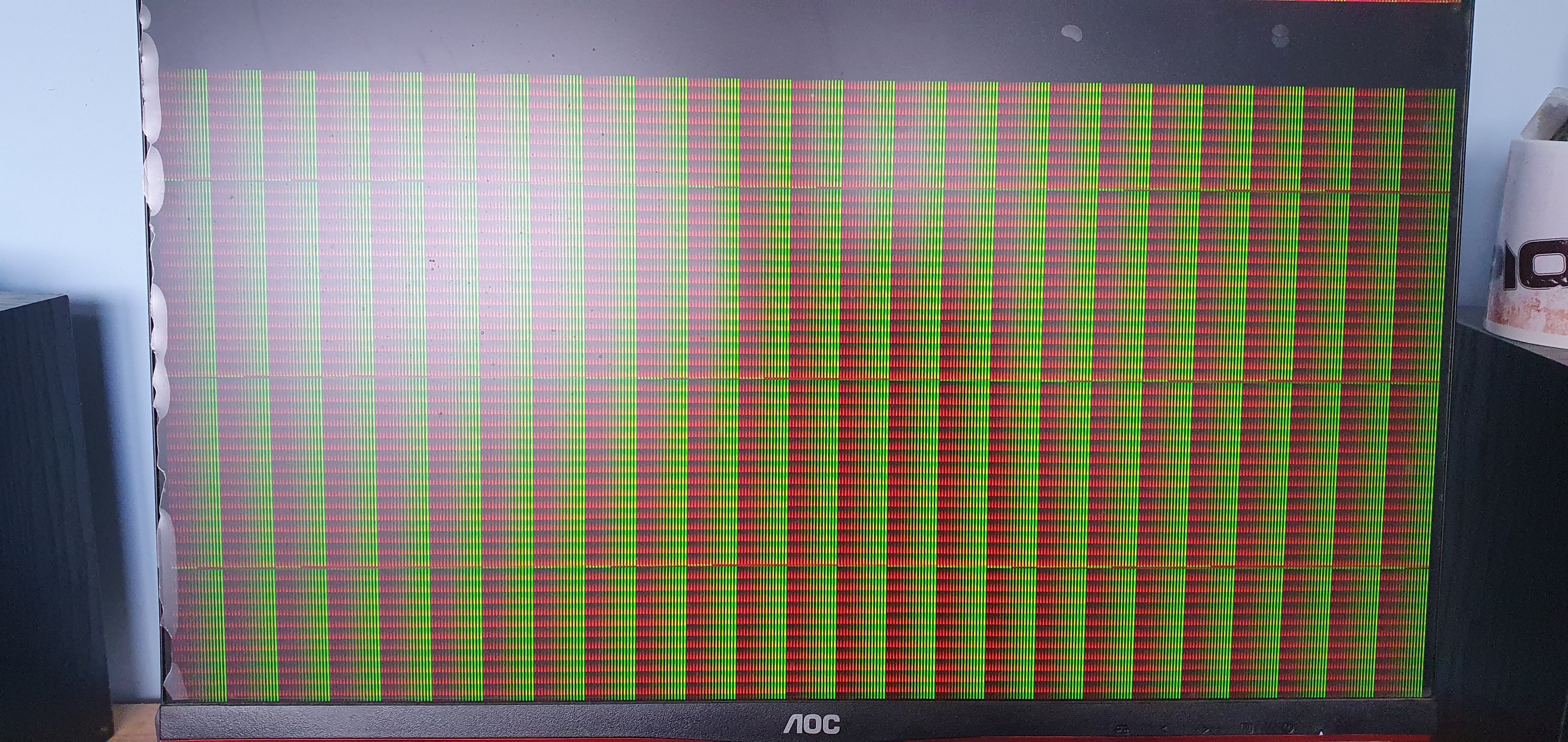

Trying to passthough AMD Radeon RX 9060 XT to Windows 11
I have recently swapped from a gt970 gpu for an AMD Radeon RX 9060 XT. However, I am having issues getting it passed though. Normally, I would bind the gpu to boot, select it as graphics including the sound and then start up the vm. Except it does not work. I have tried dumping and using the vbios, Disabling frame buffers and using video=efifb:off modprobe.blacklist=amdgpu all which have no effect. The VM does start fine but I see in display on windows 11 settings as AMD Vdisplay and not my normal display. When I do turn on my display, its looks very glitchy and strange as per my image attached. it is not a cable problem or anything as the display port cable is plugged directly from the gpu into the monitor. i have also tried hdmi as well. Sometimes i do get the following error message, when booting the vm. If i boot normal bare metal, then everything works fine without issue. But boot as a vm, this is where the problems start, so there is no hardware problems. This is the only gpu in the system which is also what unraid uses and I have tried running, lspci -k -s 2d:00.0 2d:00.0 VGA compatible controller: Advanced Micro Devices, Inc. [AMD/ATI] Navi 44 [Radeon RX 9060 XT] (rev c0) Subsystem: ASUSTeK Computer Inc. Device 063d Kernel driver in use: vfio-pci Kernel modules: amdgpuI have never had this much trouble as I have with any NVIDIA card. However, I am not sure if it has anything to do with the amd reset bug. I did try the @SpaceInvaderOne video on the amd reset card but does not seam to work at all. For anyone who has this particular card in their unraid system. How did get it to successfully pass though and work. I have tried this Reddit post without any difference https://www.reddit.com/r/unRAID/comments/1j52fkc/unable_to_pass_through_amd_rx_9070_xt/ However, I don't know if the gpu and sound has to be in 1 iommu group or what? Any thoughts or advice please? Thank you.

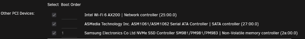

Unraid stuck on array starting. But the array has started and then later stops working
Well here is something strange and that is after binding the m.2 drive, the array decided to then work and start successfully. However, issues then seamed to start when I tried to tick to add the drive to the VM. but I did notice some additional devices ticked under other pci devices, such as something relating to Matisse and something to do with tpm2 security. So it may be that upon binding, those devices were getting bonded as well as the m.2 drive. It was only upon removing them. That the system decided to work. The only devices that should be showing up under other pci devices is the hard drive, disc drive and Bluetooth module. So for anyone else with similar issues, ensure there are no other random devices to begin with in the other pci devices and remove them. Then try binding again. Not sure how this came to be, but hopefully a bug fix could be done to prevent such an issue like this.
That is correct, yes. The system runs fine. But as soon as I bind the m.2 drive in the vfio settings and then reboot, that's when the system gets stuck on array starting and becomes quite unstable, such as the web UI taking ages to load anything other than the main screen and does not shut down or restart cleanly. This then forces me to have to restore the previous usb stick backup using the unraid usb creator tool. I have never had such an issue like in all the time of running unraid. I currently have mirror syslog to usb and set the log not to rotate so I can see if there is anything that would point to the cause of the issue.
Right, but it does not explain how binding the m.2 drive can cause the array to get on array starting on the next boot. Or is it something to do with talescale or quite what that when binding the m.2 drive causes the array to get stuck on starting and cause instability.
Well im not sure but the only thing it should be is the Samsung m.2 drive that has Windows 11 installed on. i have never had such an issue like this. i will have a look in safe mode once parity check is done
Right, i think i have narrowed it right down to when trying to bind the Windows 11 m.2 to unraid. I never had such a problem as this. This is where somehow the issue of the system not mounting drives starts to happen. I have fortunately had a previous backup of the usb stick before upgrading from version 7 to the latest version. I frankly have zero clue how after all this time I seam to suddenly have issues with unraid and the passing though a m.2 drive with windows installed to unraid and causing this much trouble. But here is the syslog after i had bind the m.2 drive to then be able to pass though syslog
Thank you. But the web ui still steams sto stop responding as i can get to the web ui. but if then click on say tools tab or such. Then the web ui just sits waiting to load for ages. So i close the tab. but if i go to web ui again. it just sits and sits and does not show any sign of wanting to load. The only way is to open an incognito window and then go from there. But even shutting is down is not possible, as clicking shut down brings up the stopping services and just sits and does not shut down. only way is to pull the plug. I wonder if to try the usb or such in another system and see how it behaves there.
