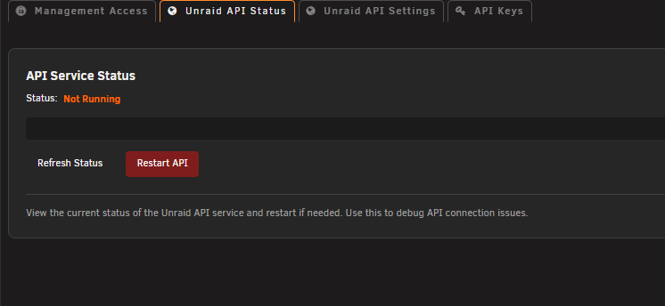

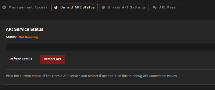

  1. EDIT: I found that this issue only occurs when using Google Chrome, Brave, or Microsoft Edge. When I use Firefox, the error does not appear, and the API Service Status shows Running.
  2. EDIT: I found that this issue only occurs when using Google Chrome, Brave, or Microsoft Edge. When I use Firefox, the error does not appear, and the API Service Status shows Running.
  3. I have exactly the same problem here, and I'm pretty sure it started with version 7.3.x.
  4. So, just to confirm, you don't see this error in the log when you go to Settings → Management Access? I also removed the Connect plugin and rebooted the server, but I still get the same error message: Jul 11 10:36:18 Tower webGUI: error: /plugins/dynamix.my.servers/include/unraid-api.php - wrong csrf_token Even with the Connect plugin removed, this error still appears whenever I open Settings → Management Access. My API service don't even running.
  5. I still get this error when I go to Settings → Management Access. I don't have any problems signing in, and my server appears to be connected. I also removed the Connect plugin and restarted the server, but I still get the same error message when I open Settings → Management Access.

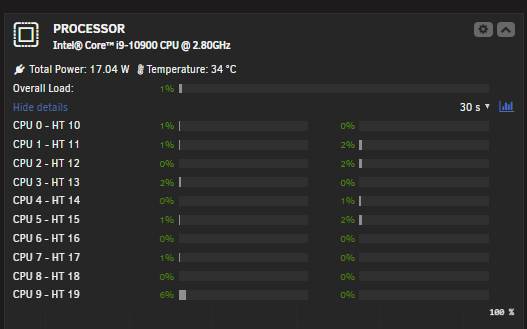

  10. Hi, First of all, a huge thank you to everyone involved in this update, and for all the time and effort you put into making Unraid such an amazing system! The update went incredibly smoothly without any issues at all. I haven’t moved my boot drive from USB to a hard drive yet. I’ll give it a little more time, but so far everything is working perfectly. I really like the new feature that allows you to install the OS on a hard drive, so there’s no need for a USB anymore. 🙂 It’s also great that my motherboard is now supported for CPU temperature and power usage readings. This is something I’ve been missing for a long time, and it’s finally here! It might have something to do with the "System Temp" plugin, which for some reason has now started working with my motherboard. Thanks again for the fantastic work! 🙌
