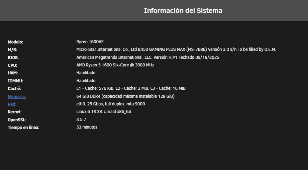

    My server is updated... it's working great! 👌
