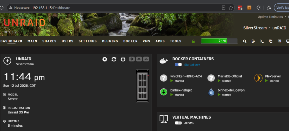

I did also try to "Force Update" the Dockers to see if the icons would populate, but they did not. The path leads to a folder in my appdata location. I tried uploading them to my web host and using a URL pointing to them. Nothing seems to work.

    Works just fine file:///mnt/cache/appdata/_icons/custom-icon.png note 3x slash after file:, not just 2x file:///

2 hours ago, craigr said:
with seemingly no issues other than my custom Docker icons not displaying either.
Using local paths is not supported there, you are supposed to enter a URL, and the field mentions, previous support for local paths was accidental I believe, and it didn't always work.
I moved my icons onto GitHub but I imagine most image hosting services would also work.
Works just fine
file:///
30 minutes ago, btTeddy said:
Works just fine
file:///
Excellent thank you. I did not have "file:" at all before, let alone three forward slashes. Works now.
Used to work fine without "file:///" for me.
Yay! 😀

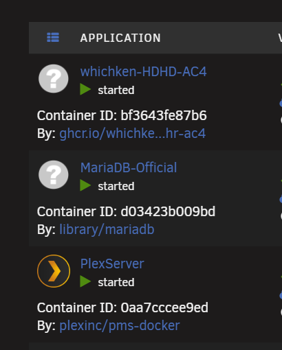

Is anyone using the net.unraid.docker.icon label with Docker Compose? That's been broken for me since the update. In the past, I used local paths like:
- net.unraid.docker.icon=/mnt/user/appdata/__containers/_icons/flexget.png
and I understand that broke for everyone. However, this doesn't work either:
- net.unraid.docker.icon=file:///mnt/user/appdata/__containers/_icons/flexget.png
I finally moved the file to a publicly available HTTPS directory, but still no luck:
- net.unraid.docker.icon=https://example.com/_icons/flexget.png
All of these examples just show generic question marks next to my containers. Is it just me?
On 7/13/2026 at 1:34 PM, btTeddy said:
Works just fine
file:///
@wgstarks Right, I tried that (it's in my post). It doesn't work for me on Unraid 7.3.2, at least with Docker Compose and that label.
I also have the same problem.

Well, after scratching my head for a bit and digging, I have found a solution 😊
If you are using Docker Compose with labels, then this will fix yours.
So, pay attention to your container name, and make sure its icon exists in /var/local/emhttp/plugins/dynamix.docker.manager/images
with this format contianrname-icon.png Don't forget -icon In the name 😊
The thing I didn't try is a restart, so I am not sure if it stays after restarting the server.
That location is only in RAM so will not survive a reboot. The image needs to be stored on the boot drive, so I expect that 'config/plugins/dockerMan/images' location on the boot drive is where you need to store them to survive a reboot. I do not use Compose so cannot test it. It is possible you might need to run a script to move them into position during the boot sequence, but the User Scripts plugin would make this easy.
Yeah, that is what I thought. So, a temp Band-Aid to have a script to copy them over during startup.
Easy peasy :)
Didn't fix mine. Do you also have something entered as the label in Docker Compose?
Wondering why some of them exist there?
That means something copied them over, but not all?!
I suspect that Unraid does it for containers set up via DockerMan. You were using Compose so Unraid does not know about that type of container.
