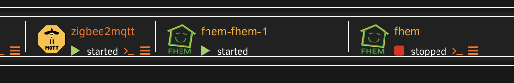

  10. Is it a know issue for containers from a compose stack that they are missing buttons for logs, console etc. and have a big gap on the right side?
