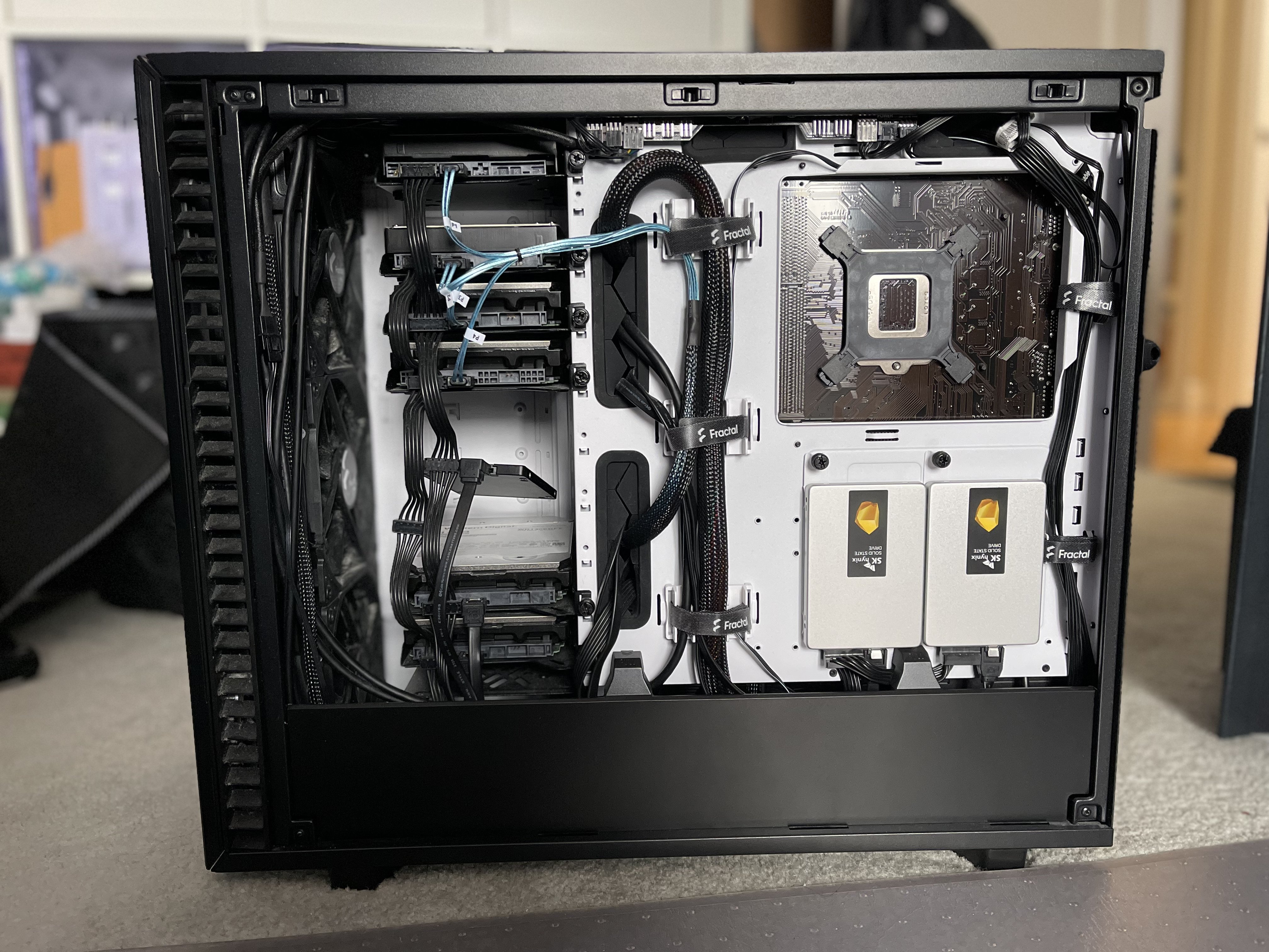

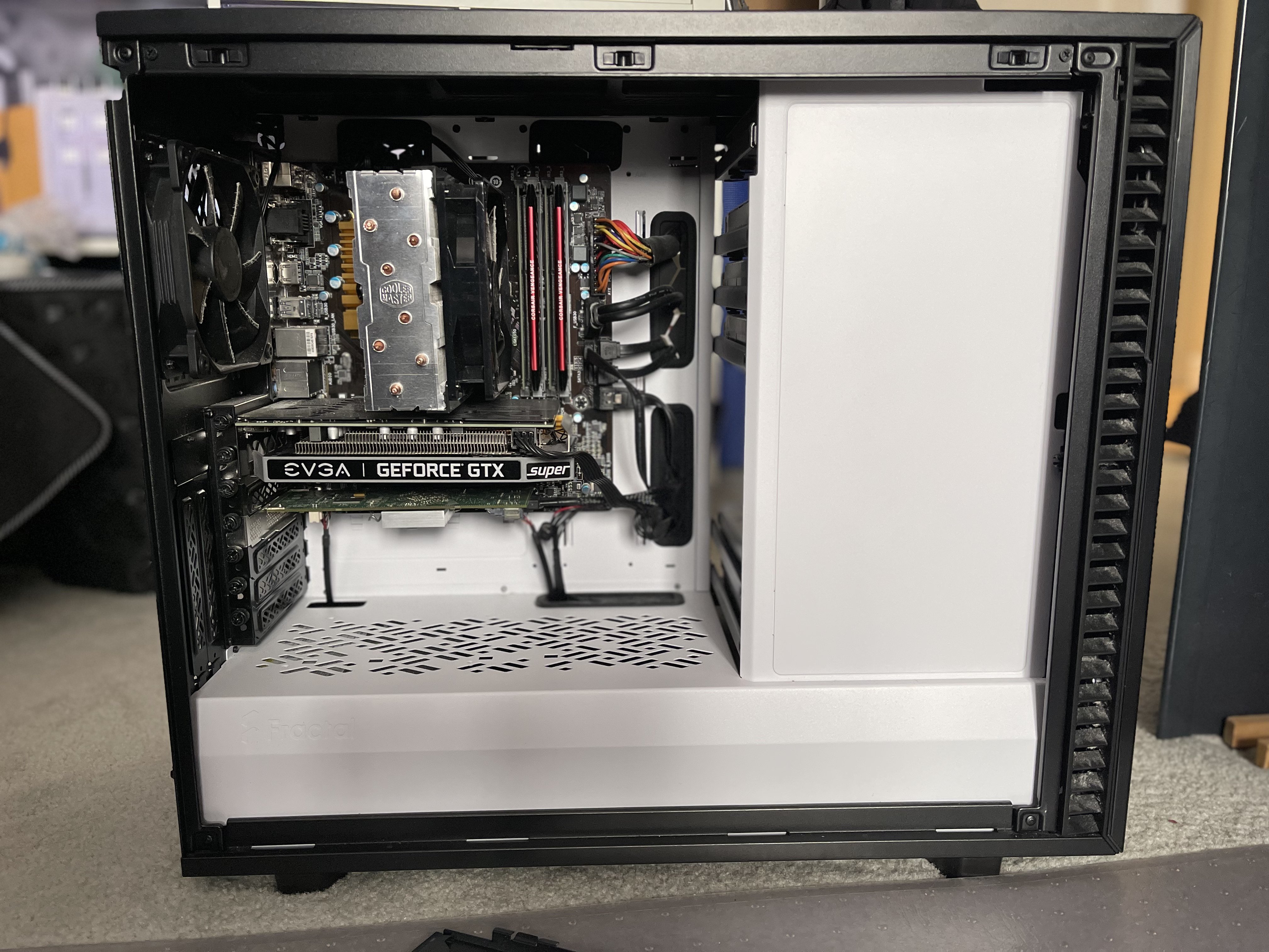

    I ended up adding a few more items over the past year or so. Nvidia 1650 Super for Plex transcoding (Not bad for what it is!) Dell H310 LSI9211-8i 2x SK Hynix 500GB SSD for Cache pool 2x 14TB, 1x10TB when there were shuckables on sale Ignore the hanging SSD..that was a 512GB Samsung SSD that I'm using with Unassigned devices.
