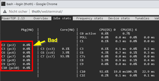

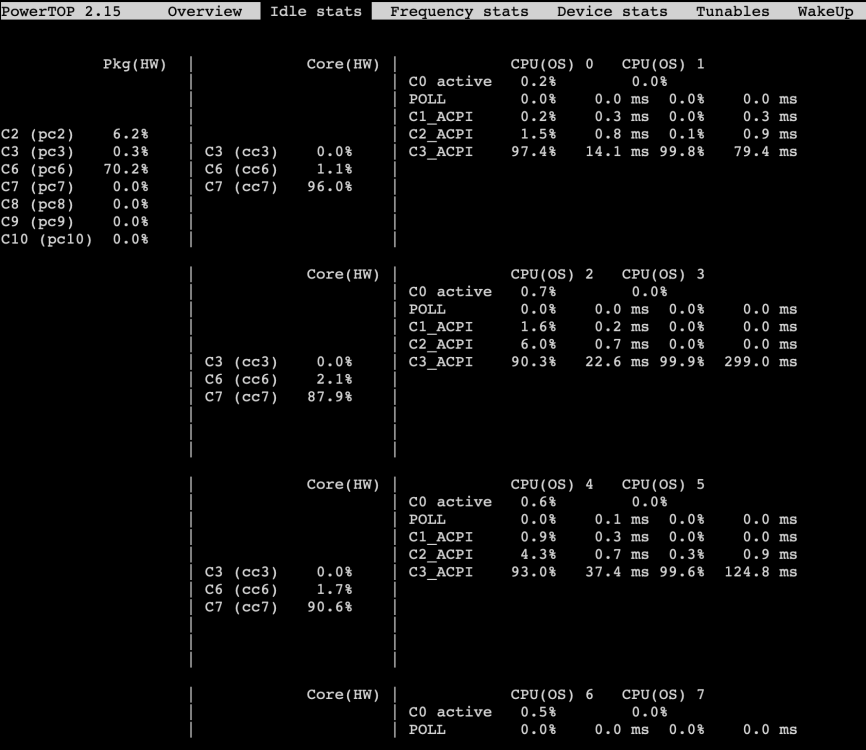

Now press "TAB" until you reach "Idle Stats" and check your CPU Pkg (HW). Depending of the brand and model of your CPU you can reach different C-States. If your system isn't optimized, you will see this:
If you press "TAB" you will see additional information about standby states of different hardware components of your system.

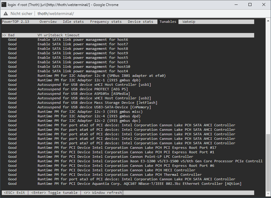

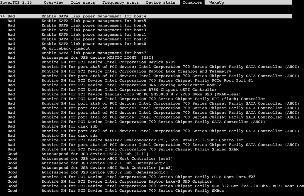

In the tab "Tunables" you will see multiple devices which have the state "Bad", which means powertop found devices which do not allow standby/sleep states:
Now you can execute the following command to optimize this:
WARNING
Many SATA controllers (JMB xxx or ASM xxxx) do not support link power management and your disks loose connection after reaching spindown! Read further before executing --auto-tune!
powertop --auto-tune &>/dev/null
By that all compents will return "Good":
Now, your server should reach better C-States.

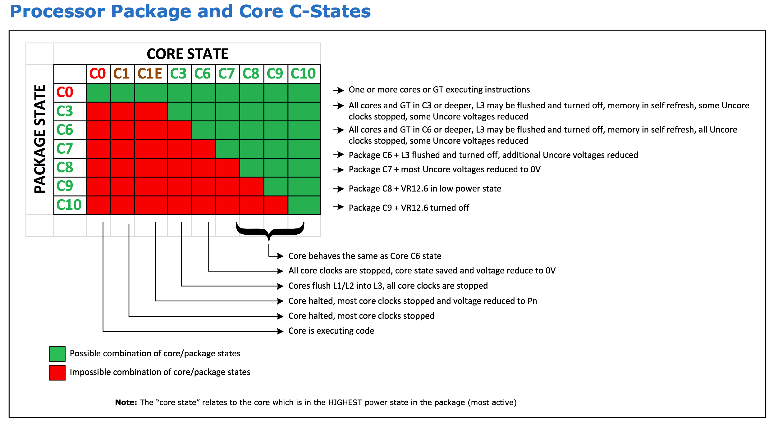

Package C-States
This table shows the dependency between CPU Core and CPU Package C-States:
Several things are important to reach Package (Pkg) C-States C3, C7, C9 or even C10:

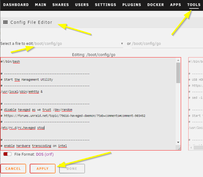

Commands
Instead of using "powertop --auto-tune" you could add the following power-saving commands to your /boot/config/go file (stop your array and execute them through your terminal to test them first) with the Config File Editor Plugin:
# Set power-efficient CPU governor
/etc/rc.d/rc.cpufreq powersave
# Disable CPU Turbo
[[ -f /sys/devices/system/cpu/intel_pstate/no_turbo ]] && echo "1" > /sys/devices/system/cpu/intel_pstate/no_turbo

Config File Editor:

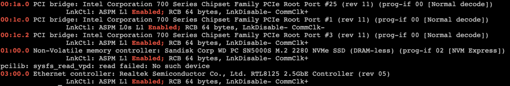

Obtain ASPM status of all devices:
lspci -vv | awk '/ASPM/{print $0}' RS= | grep --color -P '(^[a-z0-9:.]+|ASPM )'

    Good news everyone! I managed to get C10 pkg C-State (previously I get no higher than C3) on Asrock LGA1700 mobo and you can too. Yay!   My setup is:   Motherboard: Asroc

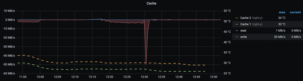

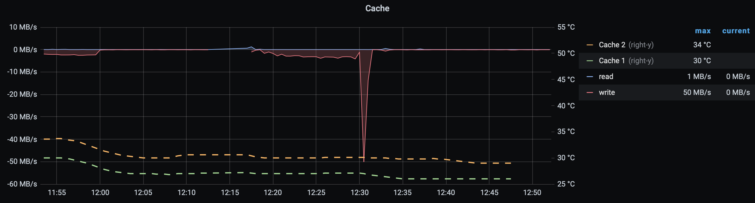

22 minutes ago, CS01-HS said:
dirty_writeback) in terms of risk, assuming a UPS/no unexpected power loss?
dirty_writeback is the only risky setting, but it's not raised by powertop, it's reduced. The default is 30 seconds. Powertop sets it to 15 seconds. This means Linux starts 15 seconds earlier to empty the RAM to disk. This can save energy as all devices can reach the sleep state 15 seconds earlier.
Note: A UPS is absolutely recommend or all data of the last 15 seconds will be lost. Unraid default: Even 30 seconds.
