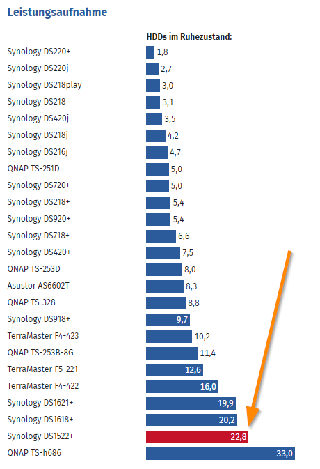

As an example, Synology's Ryzen NAS has one of the worst power consumptions of all models:
https://www.computerbase.de/2022-06/synology-ds1522-nas-amd-ryzen-test/3/#abschnitt_lautstaerke__leistungsaufnahme:~:text=Dauereinsatz zu Buche.-,Leistungsaufnahme,-HDDs im Ruhezustand
But even Intel lost their focus on power efficiency after releasing the 10th gen and it became even worse with the 11th gen. The most efficient builds are still only possible with with 8th and 9th gen. And of course you should never add cards if the same feature is available on a motherboard. So your perfect board would be the Gigabyte W480M (8x SATA, 2x M.2 and 1x 2.5G ethernet port), which allows a 10 to 15W build.
