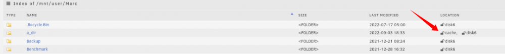

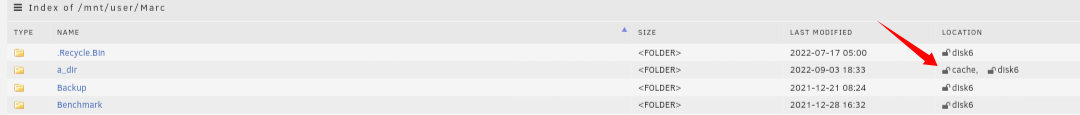

1 hour ago, Fredrick said:
but I don't know which docker keeps accessing and spinning up disks.
The reason why docker spins up your disk is simple: Your docker reads/writes a file which is located on a disk. ^^
Follow the steps (shares tab > open Content....). unRAID shows if files are located on cache AND array:
A share like appdata should show in the column "LOCATION" only "cache" (note: do not use "only" as your cache setting, instead use "prefer" as the mover does not move files if you choose "only" and some files are left on the array).
Another reason could be a docker like Plex, which monitors the content of shares, which are located on your array. That is the reason why I disabled auto-indexing in Plex (so it does not check for new movie files) and I used an additional tweak by passing every disk manually:
But this tweak is usually only needed if you notice that multiple disks spin up while starting only one movie (I had this).
