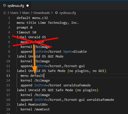

On 12/29/2022 at 8:29 AM, mgutt said:
- Delete the two network config files in /config
- move "menu default" in syslinux/syslinux.cfg after "label Unraid OS Safe Mode":
by that your server boots in safe mode and obtains a new IP address through your DHCP server.
Thanks - and just to be clear, I do this by unplugging the usb from the unraid when unraid is off and editing it on another PC that I plug it into? Should I also try it with the installer files (and folder) removed from the temp directory I created from OP?
If you can't boot, this is the only option 😉
