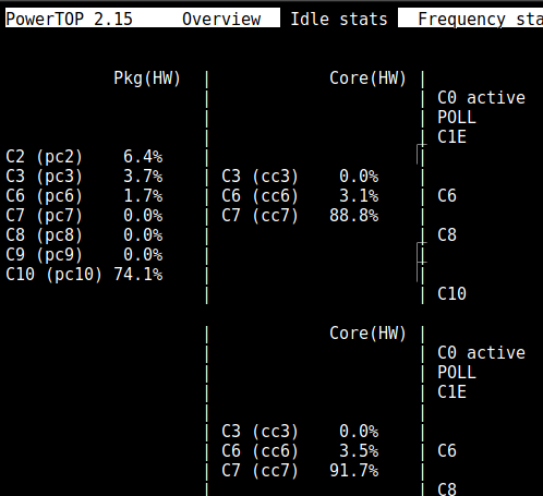

    Good news everyone! I managed to get C10 pkg C-State (previously I get no higher than C3) on Asrock LGA1700 mobo and you can too. Yay!   My setup is:   Motherboard: Asroc

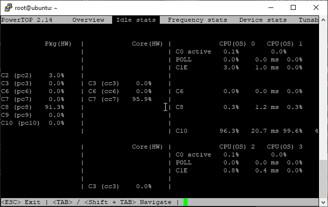

6 minutes ago, MagickPistacho said:
Thing is, I can't reach C10 no matter what. I've tried with no HDD and SSD connected, still C8.
Please test with Ubuntu + powertop --auto-tune. But don't forget to install an ssh server to connect remotely. As long the display is connected C10 should be impossible.  If you are able to reach C10 with Ubuntu, than we maybe have an ASPM problem which can only be solved with manually enabling ASPM on some PCIe devices:
https://forums.unraid.net/topic/111921-why-is-aspm-disabled-in-unraid-while-its-enabled-in-ubuntu/
If you can't reach C10 even in Ubuntu, this is related to the board / BIOS. And probably because your board has an ASMedia onboard controller for USB 3.2:
https://www.hardwareluxx.de/index.php/artikel/hardware/mainboards/58080-dank-bclk-oc-eine-absolute-empfehlung-asus-rog-strix-b660-g-gaming-wifi-im-test.html
Oh, I see. Thanks a lot.
I'll have to investigate about installing a ssh server and managing it with Ubuntu, right now I don't know where to start with that, but I'll take a look as soon as I can.
In the meantime, if it serves any purpose, I've tried this and everything checks as enabled:

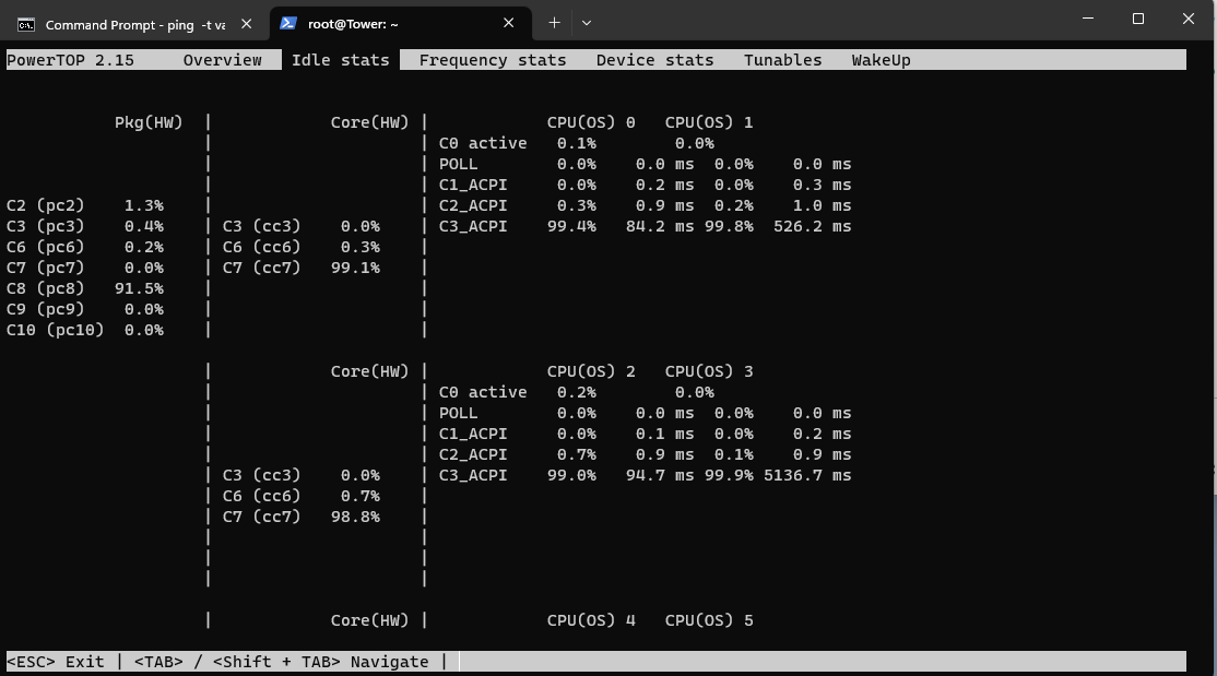

This is a very good pointer... I just received the motherboard + cpu for my new build - without HDDs I am seeing 8.5 watts right now. I partially tried to replicate @riduxd setup (same motherboard)
Here's my hardware:
MB: Asus Prime Z790M-Plus D4 Version: Rev 1.xx
- BIOS version 02/22/2023 v0810
CPU: Intel 13400
CPU cooler: stock intel cooler
RAM: 16GB (2x8GB) G.Skill F4-3000C16-16GISB Aegis DDR4 DDR4-3000 CL16-18-18-38 1.35V
PSU: RGEEK 12V 300W Pico ATX
HDD: only the unraid USB (for now)
Idle: ~8.5 watt.
- I am not sure if I am reading powertop correctly but this seems to say that I am not hitting C10 at all, and mostly I am on C8?
@riduxd any chance you could share what options you have set in BIOS? Just in case I am missing something silly.
- Any recommended tutorials on how to force downclock this i5-13400 (65w) to i5-13400T (35w)?
Also not sure why at idle my CPU freq is this high... doesn't seem normal to me.

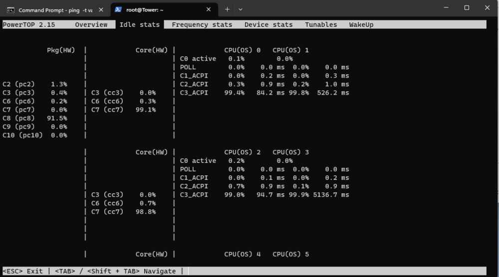

Well unfortunately @TheLinuxGuy, I don't have that mobo anymore. I broke it while I was reinstalling my CX4.... LOL. The mobo that I originally got to replace the Asus Prime Z790M-Plus D4, wasn't letting me go into deeper CStates, so I returned that for an Asus Tuf Z790-Plus D4, which also wasn't letting me go into deeper states. So yeah full size ATX mobo's are no go, especially for Z790. Anyways, those seem right.. I have a 13600k so I'm not sure if that's enough variance... What I do remember though is I set Multicore enhancement to disabled, and there was a setting for "Best Case Scenario" (i forget which one it was...). Anything motherboard vendor specific settings was basically turned off, and I used mostly Intel's default settings. I also capped my PL1 to 35W and PL2 at 125W, and unplugged my HDMI cable.
Forgot to mention that I was only able to achieve C10 when I let it sit long enough, but in reality, it was mostly at C8, similar to what you have. Oh and for ASPM settings, I used C10 as max, not Auto or CPU Default.
More edits: Install corefreq-cli, it should show you frequencies at faster poll rate.
Edited by riduxd
Thank you for confirming that you rarely saw the system go below C8. This is probably as good as it gets with this board, I am happy with it. My other B660M build eats 30 watts idle while this one is 1/3 - same cpu generation too, different chipset and board manufacturer (AsRock vs. Asus)

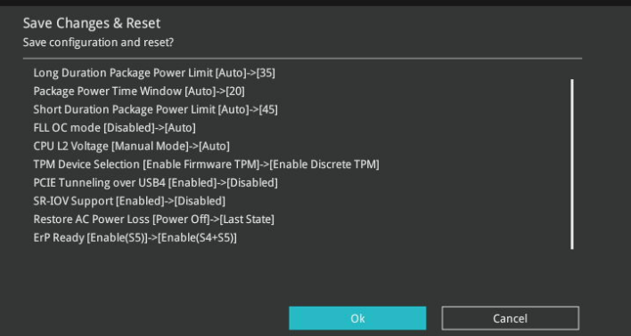

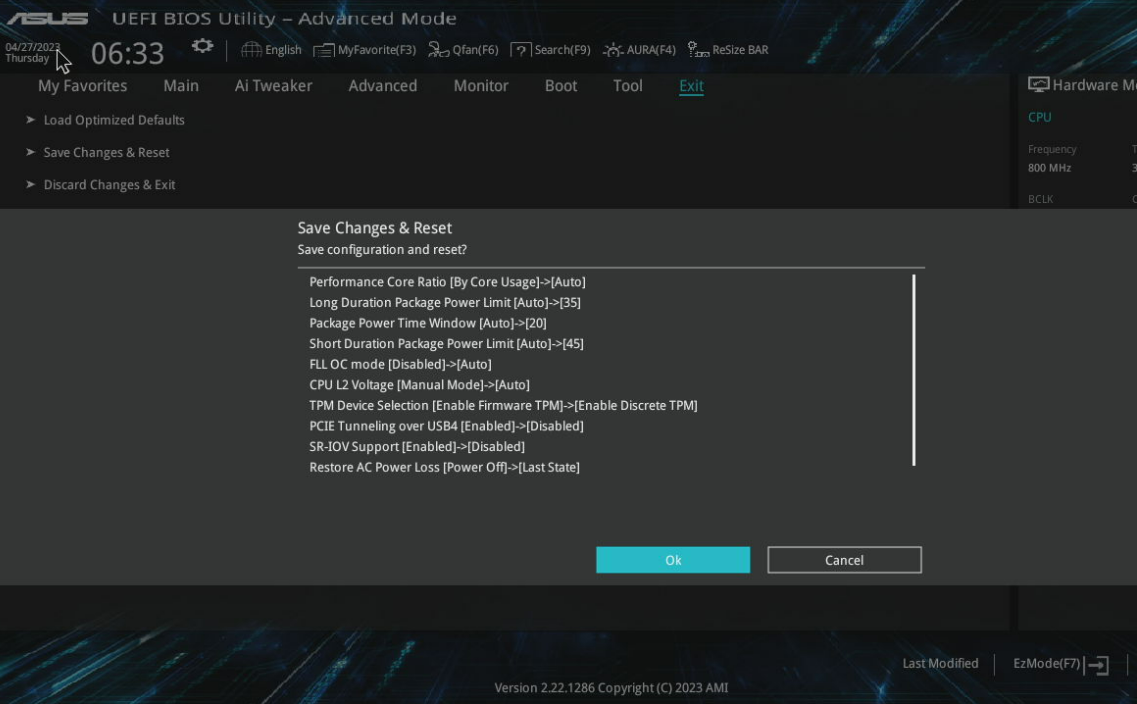

These should be the settings an owner of an Asus Prime Z790M-Plus D4 needs to set to match my power measurements below (unraid usb plugged in + 2TB NVME drive - hdmi + kb/mouse unplugged).
I'm still lost on where to set the CPU multiplier in this asus bios (but did set PL1 and PL2 to 35w) - something to look at this weekend I guess when the intel x710 arrives in the mail.
*edit note: apparently summary screenshots below are not showing but there are some settings in BIOS with the option "Max battery" and also noticed the scroll window hid my other APM settings where I am forcing L1 on everything plus S4+S5 and CPU deep c-states...

The whole system is not yet configured at all, so the NVME and SSDs are attached to the board but not configured or used in any way
Please add them all to the array as disks. Leave the parity slot free, so the array starts without creating a parity. Through Tools > New Config you can delete the array afterwards. Did you close the WebGUI while measuring? Even the Unraid Web Terminal must be closed. This has a huge impact on power consumption. Instead enable SSH and connect through your PCs terminal and "ssh root@tower"
 Done. The power misurement (without GUI) reports 19watt, which is better than before but not so significant. The strange thing I notice when I connect to the server is that the CPU frequence is not 800Mhz as I was expecting, it's always at 1.2GHz even if the Governors are set in OnDemand (Normal) and PowerSave (Power Safe).
I honestly gave up on achieving the deepest C-States.. Even if I get the X710, once I run my Home Assistant and zwavejsui container, C-States immediately drop to C2. I guess the Zooz Zwave dongle probably is the culprit, not necessarily the zwavejsui, but I do use quite a few ZWave devices so I can't just drop ZWave.. Oh well.
Ok, I've managed to install the ssh server and powertop in Ubuntu, and yeah, seems that I can't reach C10...
No HDMI and USB cables connected, only power, LAN and the USB stick. I don't know if I should've used a non-GUI mode or anything else to test this, didn't see the option while booting Ubuntu.
Even then, while achieving C8 here, it uses about 34W instead of 13 like in UnRAID, is that normal?
The desktop version is perfectly fine as long no monitor is connected.
This is the first time I read that Unraid has lower power consumption than Ubuntu. Strange. Especially because of the huge difference.
Yep, then it seems that's it, my system can't go to C10, I'll have to change the motherboard and try with another one. Bummer, but at least I have some spotted thanks to hardwareluxx.
And many thanks for the tips and help :)
