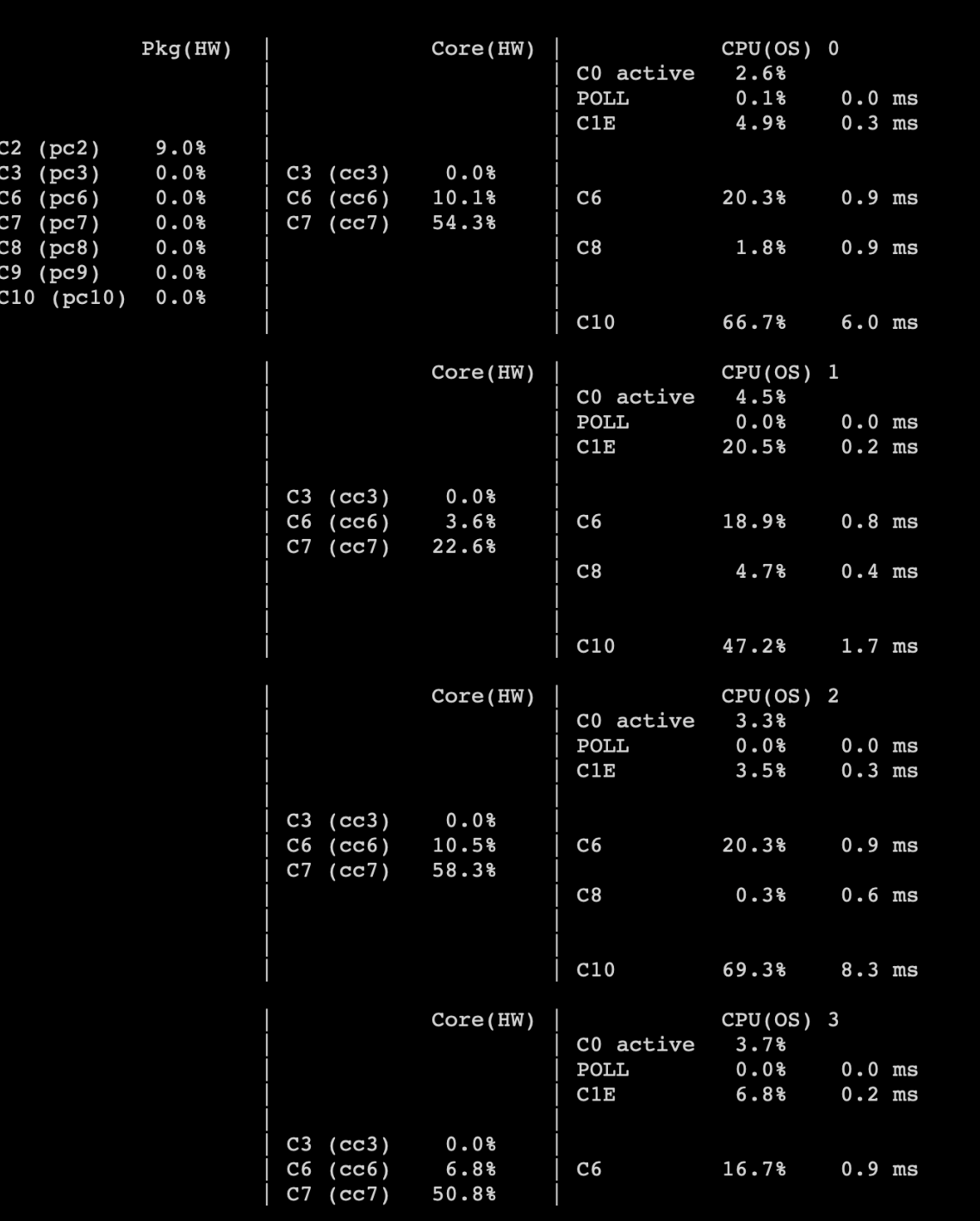

  2. oke started eliminating some options, first went and installed ubuntu server, then I reached C10 and 1,7watts! then I studied the behavior of the different io and I found out that some usb ports have weird behavior and cause high usage en preventing the system to reach lower c-states and identified a usb port that doesn't seem to have that effect. I prepared a fresh usb stick with unraid 7.1 beta and now it idles at 3-3,5watt spending most of the time in C10. Bit more then ubuntu bit still very acceptable. I then tried a back-up of my "production" unraid server that is running 7.0.1 and it was idling at 10watts not going lower then C7. I think ill just transfer the key set-up unraid from scratch.
  3. with 7.1 it hangs on boot, it mentions the i915 and then nothing happens, had to restore an back-up (12500t)
  4. I got new hardware, a Lenovo thinkcentre M70Q gen3 with a 12500T. I enabled all c states in bios, disabled hyper threading, removed the wifi card, disabled audio. did the powertop command. but it refuses to go in a c state lower then c2 I changed over all other hardware, from my previous build and that worked all fine...
