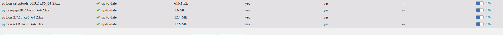

Requirements (install them through NerdPack)
- Python 3
- pip
- setuptools
