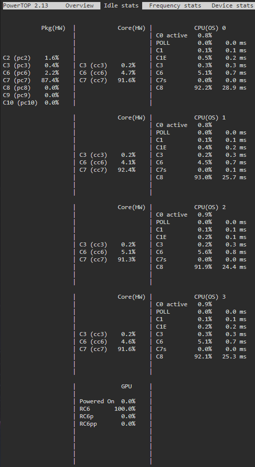

Sorry, missed your CPU model. Powertop 2.13 is too old to display correct values. We need 2.14 to get correct C-States for more recent CPUs.
This means your CPU already could be on C9, but you can't see it.

    Good news everyone! I managed to get C10 pkg C-State (previously I get no higher than C3) on Asrock LGA1700 mobo and you can too. Yay!   My setup is:   Motherboard: Asroc
  • I added a warning:   And a further explanation to the initial post:

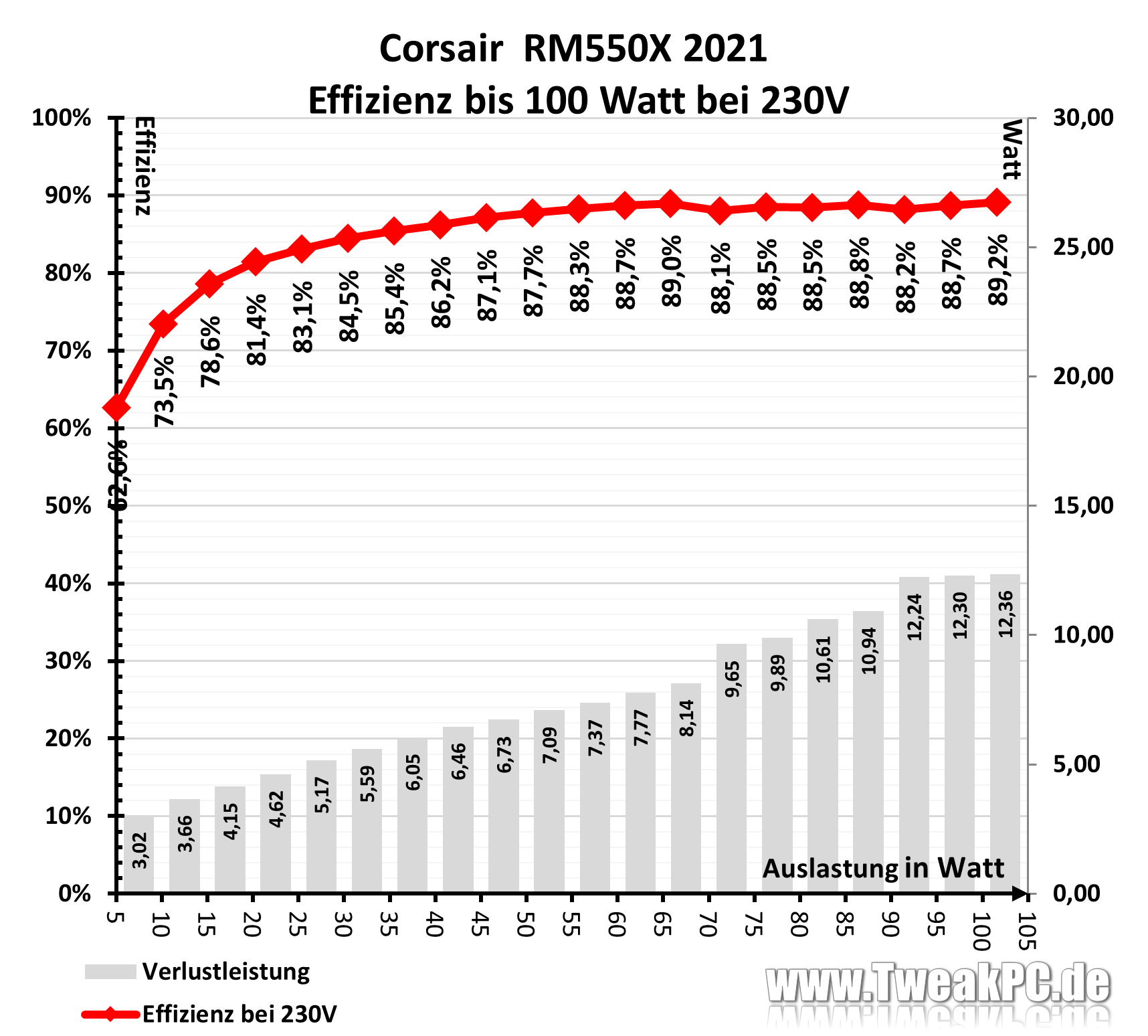

The most efficient power supply on power consumptions under 25W is the Corsair RM550x (2021). It is already ATX12VO compatible (which is the reason for the high efficiency on low power consumptions).

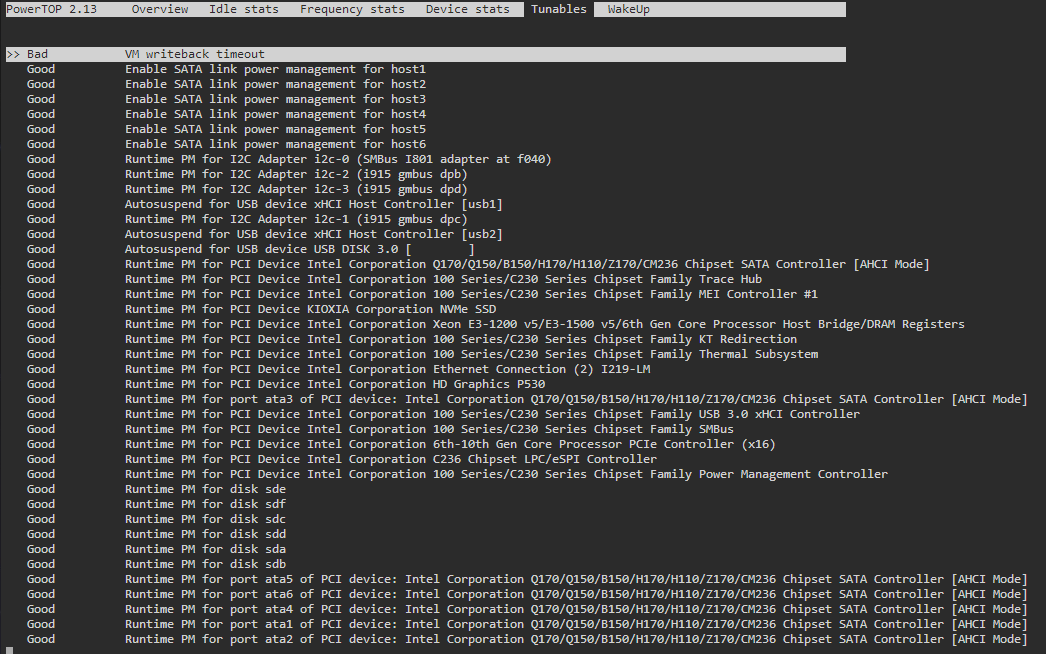

On 10/21/2020 at 12:05 PM, mgutt said:
Powertop [Support auf Deutsch]
# disable haveged as we trust /dev/random
# https://forums.unraid.net/topic/79616-haveged-daemon/?tab=comments#comment-903452
#/etc/rc.d/rc.haveged stop
# Set power-efficient CPU governor
/etc/rc.d/rc.cpufreq powersave
# Enable power-efficient ethernet
# enable IEEE 802.3az (Energy Efficient Ethernet): Could be incompatible to LACP bonds!
for i in /sys/class/net/eth?; do dev=$(basename $i); [[ $(echo $(ethtool --show-eee $dev 2> /dev/null) | grep -c "Supported EEE link modes: 1") -eq 1 ]] && ethtool --set-eee $dev eee on; done
# Disable wake on lan
for i in /sys/class/net/eth?; do ethtool -s  $(basename $i) wol d; done
# powertop tweaks
# Enable SATA link power management
echo med_power_with_dipm | tee /sys/class/scsi_host/host*/link_power_management_policy
# Runtime PM for I2C Adapter (i915 gmbus dpb)
echo auto | tee /sys/bus/i2c/devices/i2c-*/device/power/control
# Autosuspend for USB device
echo auto | tee /sys/bus/usb/devices/*/power/control
# Runtime PM for disk
echo auto | tee /sys/block/sd*/device/power/control
# Runtime PM for PCI devices
echo auto | tee /sys/bus/pci/devices/????:??:??.?/power/control
# Runtime PM for ATA devices
echo auto | tee /sys/bus/pci/devices/????:??:??.?/ata*/power/control
This sounds very interesting. Do you have a source or any more info / comparison on that? f.e. efficiency compared to a picoPSU.
Did I invest in the wrong horse with a Prime TX-650 from Seasonic with Titanium Certification? My picoPSU didn't have enough max Power.

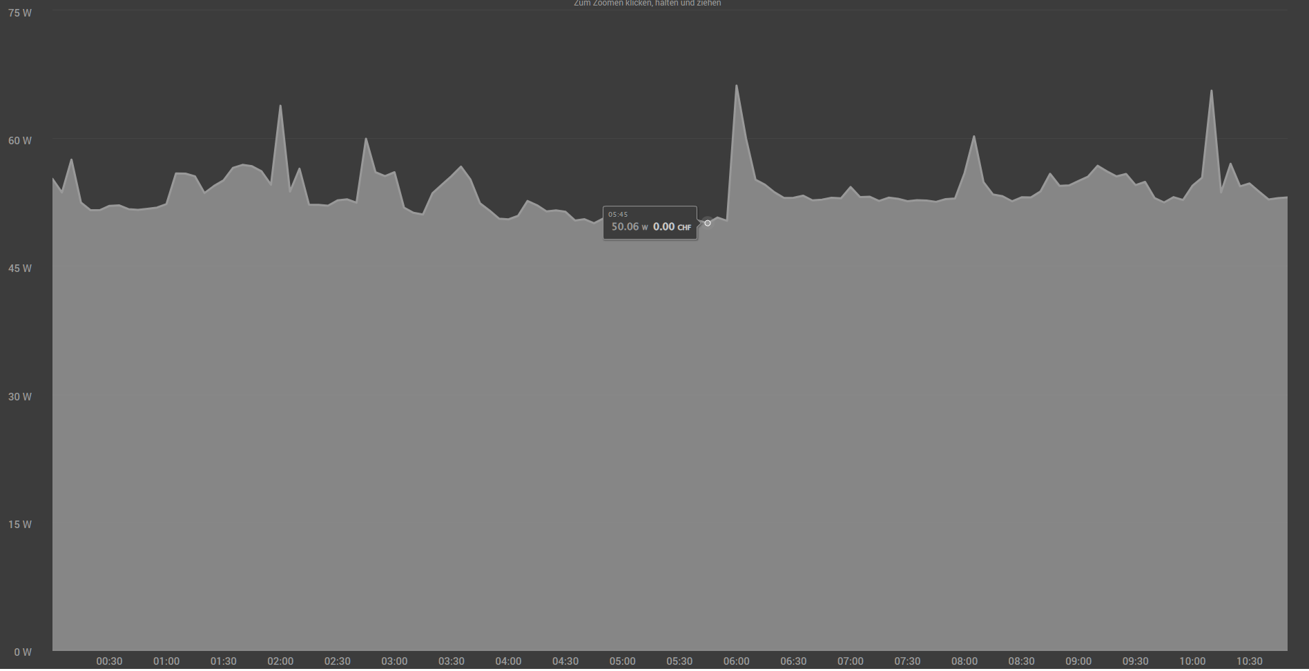

Yeah... I can only dream of such low Power usage. In the beginning, my Unraid was idling at about 20W as well (2015). But now, with 13x 2.5" HDD's, 7x SSD's, 4x SATA-Controllers and 40x Dockers for gaming servers, transcoding and keeping track of downloads those days are long gone.
atm, I'm sitting at 60W "idle", I'm looking into getting rid of old disks (- 4x HDD's, 5xSSD's) and my SAS3008 which should give me another 10-30W savings.

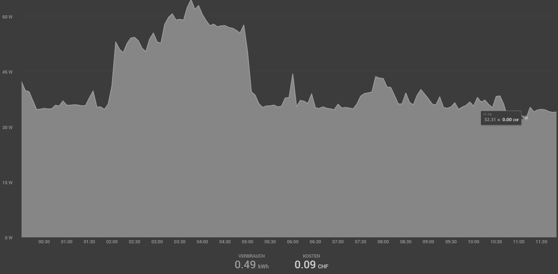

Thanks for all your help. Especially mgutt.
I now did several Improvements to reduce my consumption from ~65W to 33W on "idle". See following graph, last improvments were made on 11:00 (measured from the wall with mystrom-Plug):
Spoiler
Xeon E3-1245v5 with Fujitsu D3417-B1 with 4x8GB ECC RAM (bought 2015)
  • Got rid of my SAS3008 (10W) and small disks. I now have only the Chipset C236 and 1x ASM1166+JMB575 and 1x ASM1062 (2W) (-10-15W)
    • Due to the high power usage, I cannot recomment any SAS HBA card. I'd say for a good build stay on asmedia or JMicron.
  • Disabled "Dynamix Cache Directories" setting "Scan user shares (/mnt/user):" (led to high cpu usage on idle, constantly ~15% load) (-10-15W)
    • Should be disabled by default, seems like I enabled it by accident in the past
  • enabled Powertop improvements as this thread suggests (-1-3W)
    • Important: ASM1166 and ASM1062 do not work with med_power_with_dipm (aka "Good" in following Screenshot) and leads to disks in error state (You are going to have to rebuild parity)
      i used this script to find the correct hosts to leave at default aka "Bad" in Powertop: identify scsi_host / ata devices + Diskspeed App
Todo:
  • replacing 1x ASM1166+JMB575, 1x ASM1062 --> 2xASM1166. expected savings: 2W (one Chip less: JMB575)
    • The JMB575 is already not in use due to bad performance (ca. 30MB/s with 5x Disks during parity sync = 60% speed loss)
    • Done: Power savings not measurable
  • 2x PC's, 1x Switch, 1x PSU: Running 2x PC's + 1x Switch off of one PSU expected savings: 5W
    • I do have another system running as a 25G-firewall at ~25W idle with i7-6700 and picoPSU. I try to run both systems off of 1x PSU. The Seasonic Prime TX-650 has far enough Power and Outputs for both systems exept the 24Pin. I ordered a 24-Pin Splitter and will try this out. The Switch runs on 12V so no issue there as well.
    • Done: Power Draw reduced (-10-15W) from ~61W (33W+23W+5W) to ~50W for 2x Skylake Systems + 1x 10G-Switch. More Info: see following Graph:

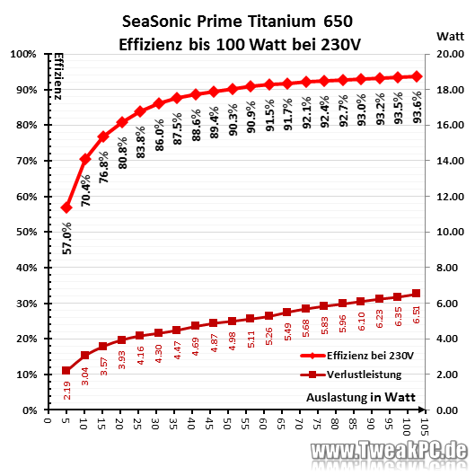

Followup to this, I found the results for the PSU Seasonic Prime TX-650.
It is even more efficient than the Corsair RM550x 2021, altough at low load not by very much 0.5-2W:
Seasonic Prime Titanium im Test | TweakPC.de
Spoiler

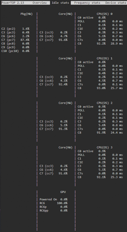

If anyone is suffering from server crashes after executing "powertop --auto-tune", then they should read this:
