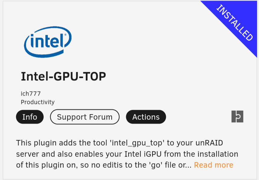

On 10/21/2020 at 1:05 PM, mgutt said:
iGPU
Install the iGPU driver plugin through unRAID Apps if your CPU has an iGPU.
CPU governor
Use the tips & tweaks Plugin to set the CPU governor to "powersave"
Which plugin do you mean for the iGPU? Should I use this in my go file?
# Enable hardware transcoding on intel
modprobe i915
And is Power Save really the best option? This is the suggestion of the Tips & Tweaks plugin: It is recommended you use the 'Performance' Governor for best performance and power savings
It's in the unRAID Apps. No need to edit the Go file.
This is wrong. Tested it with several users in the German subforums.

I have an i3-10100 with a MSI MAG B460 TORPEDO motherboard. There are no PCI devices connected and I changed the CPU Governor setting is placed on "Power Save"
I also changed the following in the BIOS:
Is there something I'm missing to get to the lower C-states? I also installed the Intel GPU TOP plugin.
