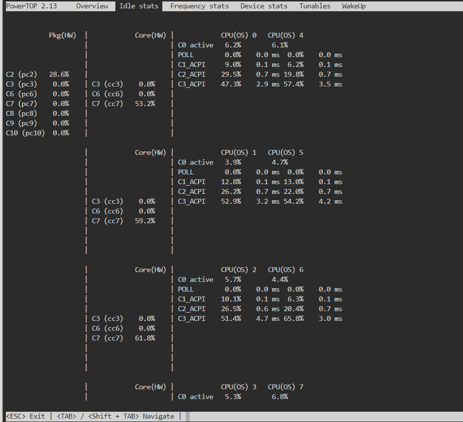

  8. Thanks again, that makes sense, the tunables tab is showing good for all parameters. Yet my Idle stats dont look promising: And it looks like only two frequencies - 800MHz or 3.6 GHz Can I make some further changes? All C states are enabled in bios, no VMs.
  9. Thanks, based on that output, the auto tune does not run, or am I wrong? Google does not help much unfortunately.

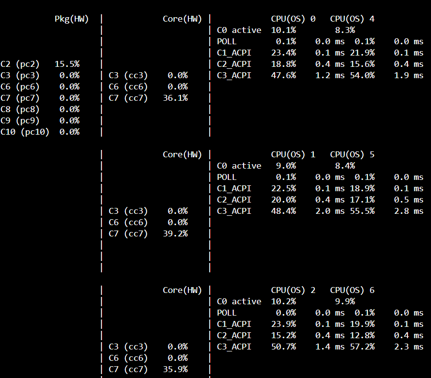

  12. Post here if you find something, I am also on 10100 and was freaking out that after changing bios settings my output looks like this:
