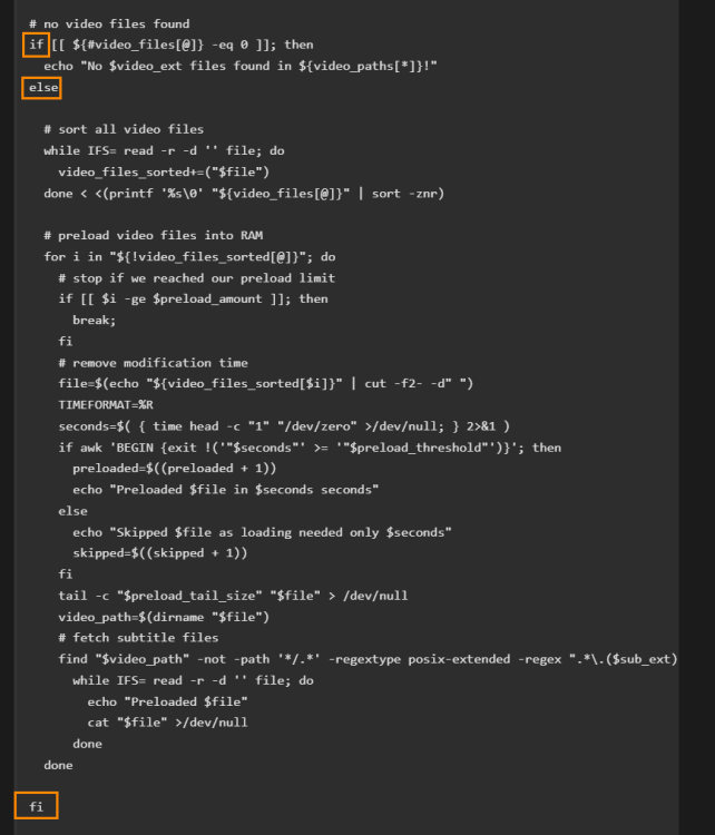

# no video files found
if [[ ${#video_files[@]} -eq 0 ]]; then
  echo "No $video_ext files found in ${video_paths[*]}!"
else
  # sort all video files
  while IFS= read -r -d '' file; do
    video_files_sorted+=("$file")
  done < <(printf '%s\0' "${video_files[@]}" | sort -znr)
  # preload video files into RAM
  for i in "${!video_files_sorted[@]}"; do
    # stop if we reached our preload limit
    if [[ $i -ge $preload_amount ]]; then
      break;
    fi
    # remove modification time
    file=$(echo "${video_files_sorted[$i]}" | cut -f2- -d" ")
    TIMEFORMAT=%R
    seconds=$( { time head -c "$preload_head_size" "$file" >/dev/null; } 2>&1 )
    if awk 'BEGIN {exit !('"$seconds"' >= '"$preload_threshold"')}'; then
      preloaded=$((preloaded + 1))
      echo "Preloaded $file in $seconds seconds"
    else
      echo "Skipped $file as loading needed only $seconds"
      skipped=$((skipped + 1))
    fi
    tail -c "$preload_tail_size" "$file" > /dev/null
    video_path=$(dirname "$file")
    # fetch subtitle files
    find "$video_path" -not -path '*/.*' -regextype posix-extended -regex ".*\.($sub_ext)" -print0 |
        echo "Preloaded $file"
        cat "$file" >/dev/null
      done
  done
fi

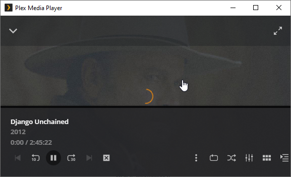

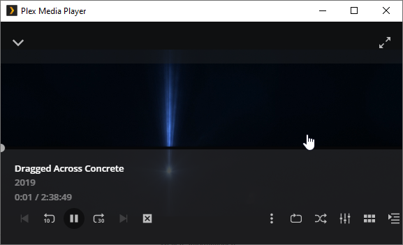

After that I spun down all my disks, opened PMP and started a recently added movie and it started without any latency.
I spun down all disks again and started one of my very first added movies and it took 8 seconds until it started playing.
