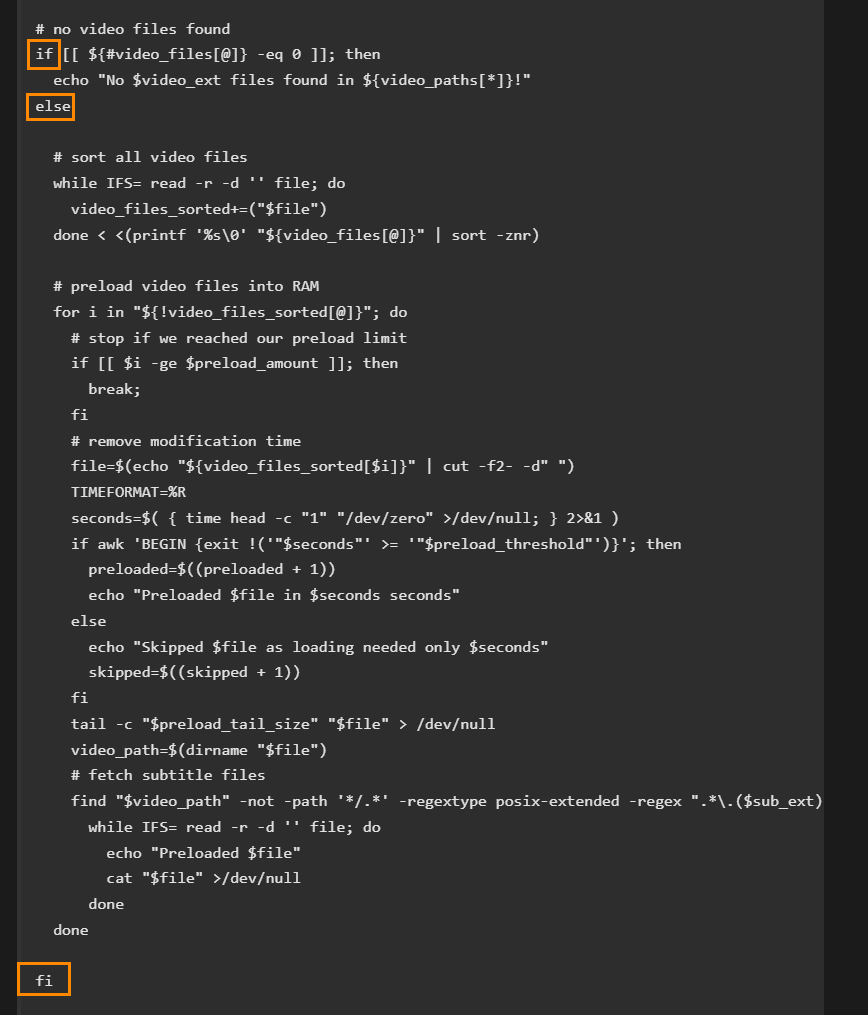

3 minutes ago, Archangel said:
if there's been no changes?
There are changes. The script in the first post is updated. I changed several lines which are not visible in your screenshot.
Version 1.3 has fixed the issue and it's running again.  Didn't see the changes at first, apologies.
Thanks for the update!
Edited by Archangel
Did you really copy the whole script? The "fi" is important as it is the end of the new "if else"-part:
As I mentioned before my edit, I don't need the script to check if I have video files in my videos folder, I know they're there so I removed that part of the script, so the fi is not necessary for the edited version I'm running.  Appreciate the reply.
