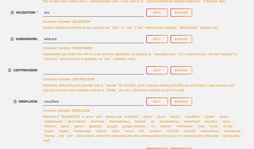

  3. I am removing the dns admin from Cloudflare to original registrar. The SWAG setup is as SpaceinvadeOne setup video. My registrar do not have a dns plugin. But I like to keep dns admin at the registrar. How can/should I go about to set the up. I tried changing validation to http and remove the line "dns plugin". The LetsEncrypt insist on port 80.

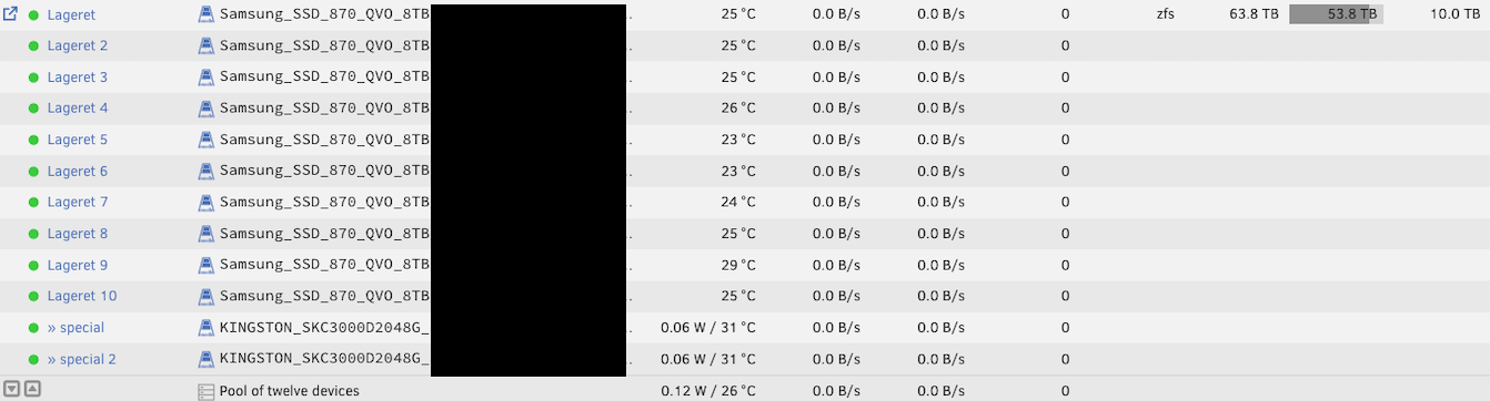

  6. It isn´t a risk of loosing my pool, unless I screw up. “What´s the point of troubleshooting if you never make any trouble……" But something strange happened during transcoding since available space read 0T. Any my not so qualified friend said I had a “ZFS-collapse” and should delete files to get below 80%. I guess keeping zpools under 80% usage is a good advice.
  7. So …./filmer is empty, but shapshots at about 23TiB? Would I be able to rollback with only 10TB available? This one below is correct?
  8. It was showing 0T after 1-2 hours in the Unmanic transcoding. After deleting about 30T, it now reads only 10T available. In…./filmer there is 0 files, still: root@kjell:~# zfs get -Hp used lageret/media/filmer lageret/media/filmer used 25095390259344 - Yes, rebooted several times.
  9. This is an urgent one for me. In the server “kjell”, it is a ZFS pool of 10 x Samsung_SSD_870_QVO_8TB, plus special. The media library holds 95% of used space. And when the desbribed issue occurred, about 52T of 64T was occupied. I was running a transcoding job in Unmanic on this server, and another Unmanic job on the other server (helmaxx) on a different media share on the first server. At the same time I was trying to setup a second GPU on the second server (helmaxx), controlled from Unmanic on the first server (kjell) with help from Unmanic Discord forum. The second GPU Unmanic container started to report receiving jobs, but only one or two workers actually did any work. After a while, first server (kjell) reported 0T available. Troubleshoot was done with my good!?? help Chat, which reported ZFS “collapse”. Chat recommended to delete files to usage below 80%, and ZFS should be ok again. Several attempts, and I risk loosing the pool altogether. I deleted a lot of files, and see strange 0 files in …../filmer and at the same time 25T usage. It is a way to solve this? That would be something….. // frodr root@kjell:~# zfs get -Hp used lageret/media/filmer lageret/media/filmer used 25095390259344 - root@kjell:~# zfs get -Hp logicalused lageret/media/filmer lageret/media/filmer logicalused 25215583430656 - root@kjell:~# zfs get -Hp used lageret/media/serier lageret/media/serier used 20942021724592 - root@kjell:~# zfs get -Hp logicalused lageret/media/serier lageret/media/serier logicalused 20999065692160 - root@kjell:~# ls -lh /mnt/lageret/media/filmer total 0 NAME SIZE ALLOC FREE CKPOINT EXPANDSZ FRAG CAP DEDUP HEALTH ALTROOT lageret 74.6T 61.2T 13.4T - - 0% 82% 1.00x ONLINE - raidz1-0 36.4T 30.5T 5.83T - - 0% 84.0% - ONLINE sda1 7.28T - - - - - - - ONLINE sdb1 7.28T - - - - - - - ONLINE sdc1 7.28T - - - - - - - ONLINE sdd1 7.28T - - - - - - - ONLINE sde1 7.28T - - - - - - - ONLINE raidz1-1 36.4T 30.6T 5.76T - - 0% 84.2% - ONLINE sdf1 7.28T - - - - - - - ONLINE sdg1 7.28T - - - - - - - ONLINE sdh1 7.28T - - - - - - - ONLINE sdi1 7.28T - - - - - - - ONLINE sdj1 7.28T - - - - - - - ONLINE special - - - - - - - - - mirror-2 1.86T 34.2G 1.83T - - 14% 1.79% - ONLINE nvme4n1p1 1.86T - - - - - - - ONLINE nvme5n1p1 1.86T - - - - - - - ONLINE kjell-diagnostics-20251204-1657.zip

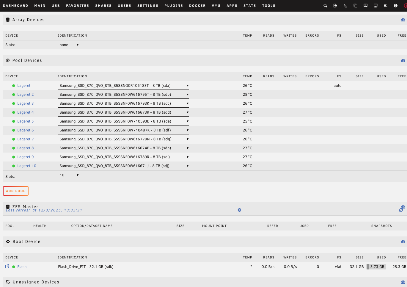

  12. Can I restart this thread? I wanted to remove the cache drive from a Zpool. Following this guide, did not work. I was not aloud to start the Array after unassigning the cache drive. Then I ran New config, made a pool with the same name as before, and added the drives leaving file system set to auto (without slots for the subpool drives). After starting the Array, the pool drives were not imported. Only option to reformat the drives. I´m in trouble on this. Any way to fix this? I hope….
