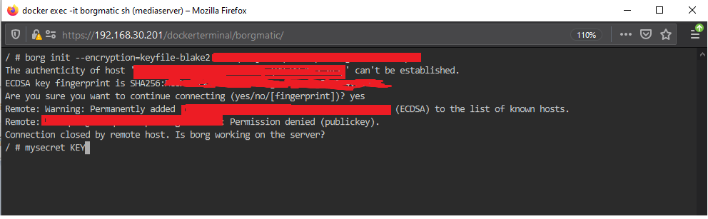

Hi, im having issues with SSH key permissions. What should i set them to?
find -L "/root/.ssh" \( -type f -o -type d \) -exec chmod 'u=rwX,g=,o=' -- '{}' \+
(this will guarantee the dirs will get the executable bit set)
Edited by laur

Still having issues:
crond: USER root pid 8 cmd PATH=$PATH:/usr/bin /usr/bin/borgmatic prune create -v 1 --stats 2>&1
/etc/borgmatic.d/config.yaml: Running command for pre-backup hook
Wed Nov 25 19:19:00 UTC 2020 - Starting backup
[email protected]:repo: Pruning archives
Remote: [email protected]: Permission denied (publickey).
Connection closed by remote host. Is borg working on the server?
[email protected]:repo: Error running actions for repository
Command 'borg prune --keep-daily 3 --keep-weekly 4 --keep-monthly 12 --keep-yearly 2 --prefix {hostname}- --stats --info [email protected]:repo' returned non-zero exit status 2.
/etc/borgmatic.d/config.yaml: Error running configuration file
summary:
Need some help? https://torsion.org/borgmatic/#issues
File perms:
~/.ssh # ls -al
total 8
drwx------    1 99       users           40 Nov 22 20:24 .
drwx------    1 root     root            58 Nov 25 19:13 ..
-rw-------    1 root     root           464 Nov 22 19:39 borgmatic
-rw-------    1 root     root           202 Nov 22 19:44 known_hosts
> ~/.ssh # ls -al
You don't have any keys in ~/.ssh/
Either generate them, or mount /boot/config/ssh/ or /root/.ssh (ie wherever on host you have the keys) to container's /root/.ssh
Note in the parent post example you can see the example expects key to be found at ~/.ssh/id_rsa:
storage:
    ssh_command: ssh -i /root/.ssh/id_rsa   <-- keyfile for ssh
Yet your dir listing above shows there's no key to be found.
Edited by laur
Hopefully you got your SSH issues sorted... it sounds like laur had the right advice.  For anyone else that finds this, I'd recommend opening a shell into the borgmatic container and try SSH'ing from there.  If password-less login doesn't work from there, Borgmatic isn't going to work either.

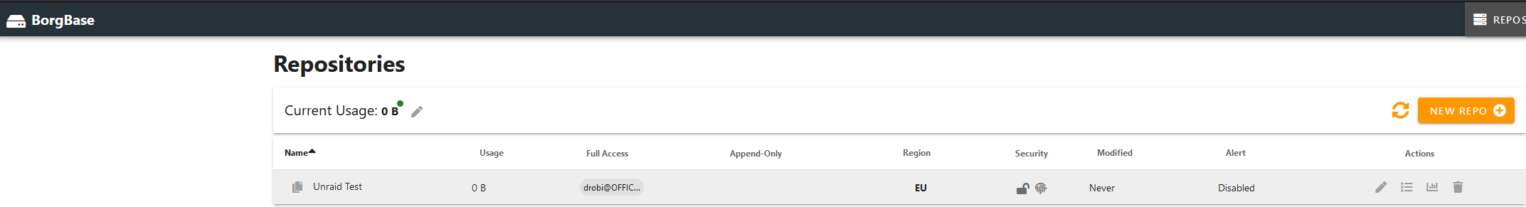

@sdub
I am in the process of setting this up with borgbase. I have registered an account (free) and setup a test repository, I have uploaded my SSH key but having no luck with the connection within the docker console.
I have attached 2 images below.
The console image shows me trying to connect to the
Edited by Greygoose
The above post was my error.
The creation of the key needs to be done in the docker container, as explained on the borgbase site.
https://docs.borgbase.com/faq/ssh/
Now working with borgbase without any issues.
