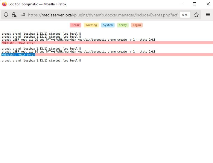

  • FIXED: CRON schedule not running   Ok sorted it.   I recreated the crontab.txt file in the docker console using vi.   Now the cron is working. It must have been a permis
  • Rick_Sanchez
    Rick_Sanchez
    I’m going to try and sudo nano the crontab.txt and see if that fixes the /bin/ash error I’m getting. I just read the comments above.   Update: I've tried using the unraid terminal to nano th

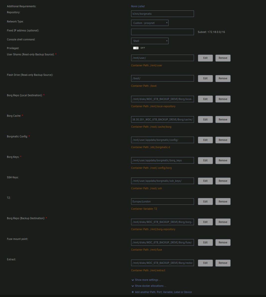

I have the same question. I got SSH working, but I don't know what to put in "Borg Repo (Backup Destination):" to initialize the repo. Did you finally get it working? If so, what was the solution you found?
Thanks!
Thanks!
That’s the local path in Unraid where you want the borg repo to live. It can be inside your array or on a dedicated volume. It gets mapped into the /mnt/borg-repository folder INSIDE the Docker container.
Once you open an SSH shell inside the Docker container you’ll initialize with a command like
borg init --encryption=repokey-blake2 /mnt/borg-repository
Regardless of the location you chose for the repo outside of Docker.
Once you initialize with this command, you should see the repo files in the location you put in the "Borg Repo (Backup Destination):" variable.

Thanks for your input. What I needed to do was not bothering with /mnt/borg-repository and putting the ssh path in the config file:
location:
    source_directories:
        - /mnt/user/FOLDER
    repositories:
        - [email protected]:/media/USER/barracuda/borg/
    one_file_system: true
