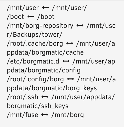

Do i need the `/mnt/fuse/:mnt/borg` mount for the container? Fix Common Problems says borg should not exist in /mnt.
These are the mounts I have:
Edited by Howboys
no it’s not necessary. The idea was to have a mount point for mounting archives somewhere you could get to them outside of the container and /mnt seems like the proper place. Either ignore the error, delete the mount point, or pick another mount point that fox common problems doesn’t complain about.

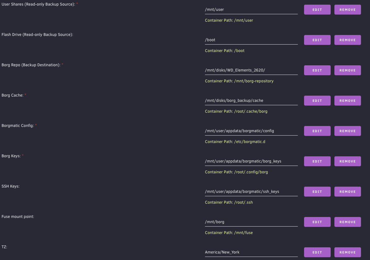

With the recent demise of Nerdpack I am looking to use this container for my Borg usage. Though I am having trouble trying to configure.
A few questions which I hope someone could answer:
  1. It is possible to 'reuse' existing repositories from Borg installed via Nerdpack? Or am I better just starting again?
  2. My existing repo is located /mnt/disks/WD_Elements_2620/UnraidBackup (I also have another repo at the following location /mnt/disks/WD_Elements_2620/DocsBackup. I have read this thread and can see the links as to how to have multiple repo's etc.) Config page from the Docker tab below. The Borg Repo path takes you to the location of both repos, meaning that I need to specify the specific repo each time. 1..thumb.png.e91c1ad692e008f7d37cb96d92bfcbe3.png
  3. Config .yaml file text. This looks ok to me, albeit appreciating that I am backing up my CA Back up folder. Once I get this working I plan to use Borg for all rather the CA Backup:
