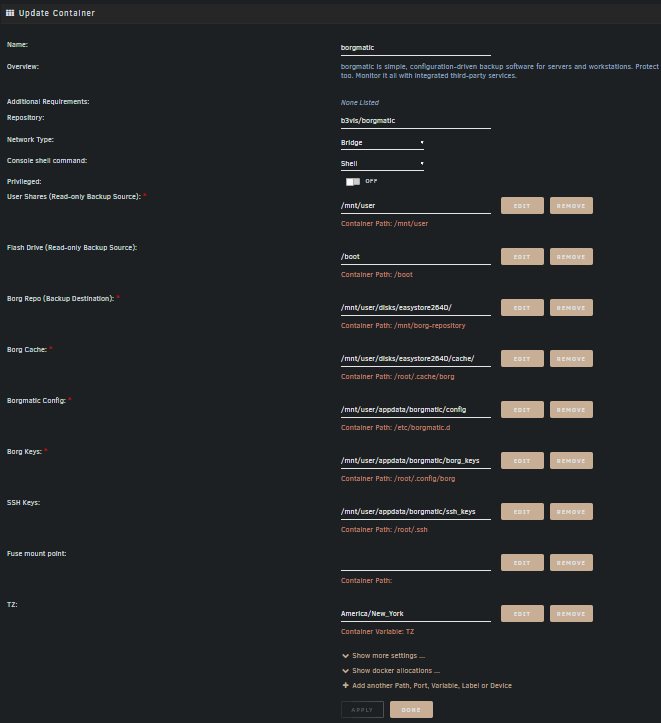

It looks to me like maybe you are mounting the share to Borgmatic as read-only… not that it’s read only in the host filesystem. What’s your Borgmatic docker config look like?
Here it is:
My config:

Your repo should be “/mnt/borg-repository” not “/mnt/user/disks/easystore264D”. You have mounted “/mnt/user” as a read-only path, so you can’t write to the repo via that path.
Edited by sdub

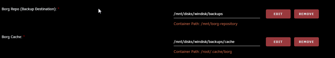

Looks like the root issue is in that '/root/.cache/borg' folder.  If you open a shell into borg and browse to that folder, does everyhing appear normal?  Could be that folder mapping is screwed up in your docker config.
It mapped in a subfolder of the repo folder. Is that fine? The cache folder on the host wasnt there so I created it but now when I try to init it says there is something already there.

Files cache set to use "mtime,size" - Very important as unRAID does not have persistent inode values
Is this still best practice? I haven't found any explicit documentation about how unRAID uses inodes in the manual. Inodes in general seem to be something that confuses a lot of people; is it dependent on the filesystem you use or are all filesystems in unRAID implemented without persistent inode values? Or is it because of the flexibility of unRAID's array system?

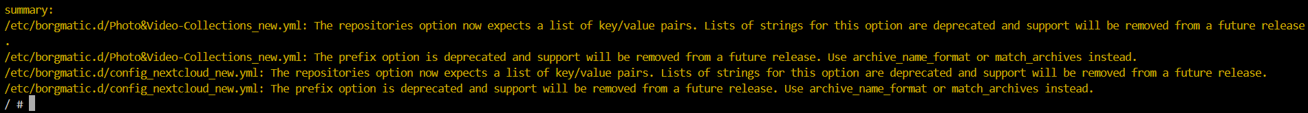

I have played about a bit more to clear errors but still have two that i can resolve?
3 minutes ago, Greygoose said:
Wow this is great, thank you.
My friend, read what the warnings say 😅. The syntax you are using in the config files is deprecated and may not work in future versions.
Solution: read the borgmatic docs and use the new syntax.
ok sorted the above, the below config shows up no errors if i console into docket and type borgmstic list.  I hope this helps someone else. took me a few hours as ive not had to work on borg for a while so was great fun and refresher,
I had to add
-path:
 label
archive_name_format: 'backup-{now}'

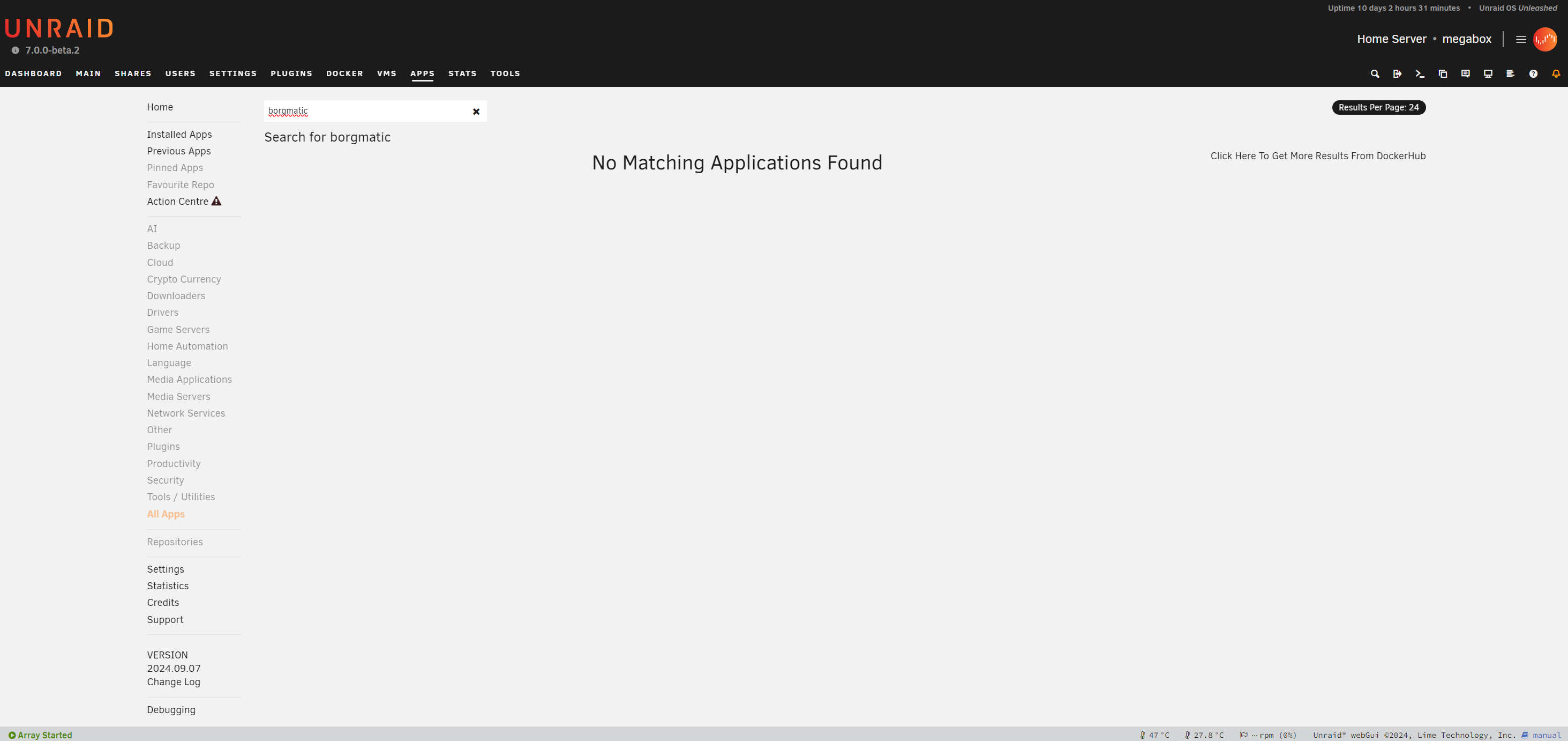

Hello. I'm new to unraid and spend the last days setting it up. Now I was thinking about backups and stumbled upon borgmatic.
It seems like a really nice solution. I'm running Unraid 7.0.0-beta.2 and am not able to find this in the CA. Is there anything that has to be done to make it compatible with unraid 7?
Second the above, borgmatic is missing from CA apps, running 6.12.14 anything I'm missing?
I noticed this as well.
Would be nice to have a borgmatic plugin instead of docker container now that it support zfs hooks to create snapshots prior to backups running. It needs access to the zfs commands so that can't work in a container.
If there was a spot in the unraid GUI to edit the config.yaml file that would also be nice.
