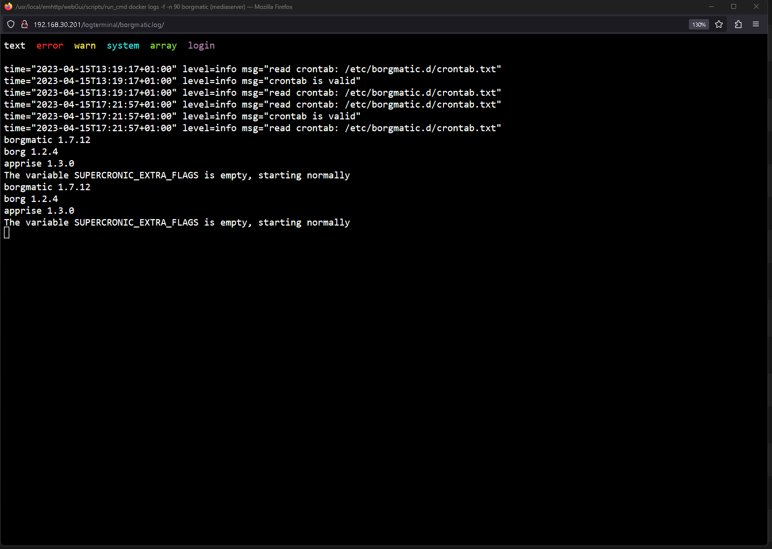

Ive been having issues with borgmatic not running.
What do these logs mean

Those logs look pretty normal to me. 🤷‍♂️ Maybe increase your borgmatic verbosity in your crontab to get more details about what might be going on?

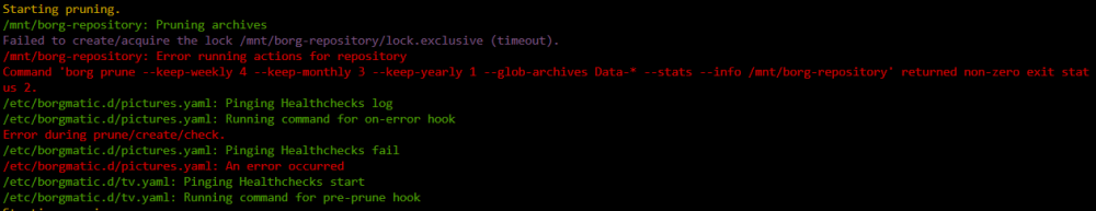

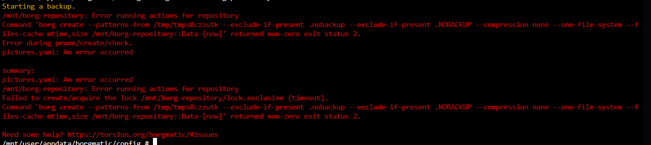

@sdub thanks for the response. I have multiple .yaml files that run to back up different data. I seem to be getting the same error. I have added it here just incase anyone can offer some advice on a best next step?

Borg creates a lock to make sure it has exclusive access to the backup archive and cache to avoid corruption.  When a backup gets  interrupted, that lock is sometimes left in place, blocking subsequent backups.  Whenever you see an error about not being able to acquire a lock, the first thing you need to do is break the lock if you are sure that no borg process is running against that repo.
From inside the borg container (docker exec -it borgmatic /bin/sh), run following command and try again.
borg break-lock /mnt/borg-repository
This may also work if you don't want to type the repository path (or you want to use a borgmatic repository label to select the respository):
borgmatic break-lock
The one thing to look out for when breaking a Borg lock is first make sure Borg isn't actively running! Because if it is then you'll be breaking the lock of a running process and potentially accessing the repository from multiple different processes at the same time. That's probably not what's going on here, but it's just something to look out for.

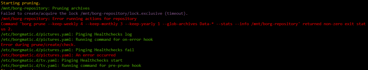

As i have had this popup in my log

On 4/30/2023 at 10:46 AM, Greygoose said:
is this the default borgmatic repo
Im having the same. Any ideas?

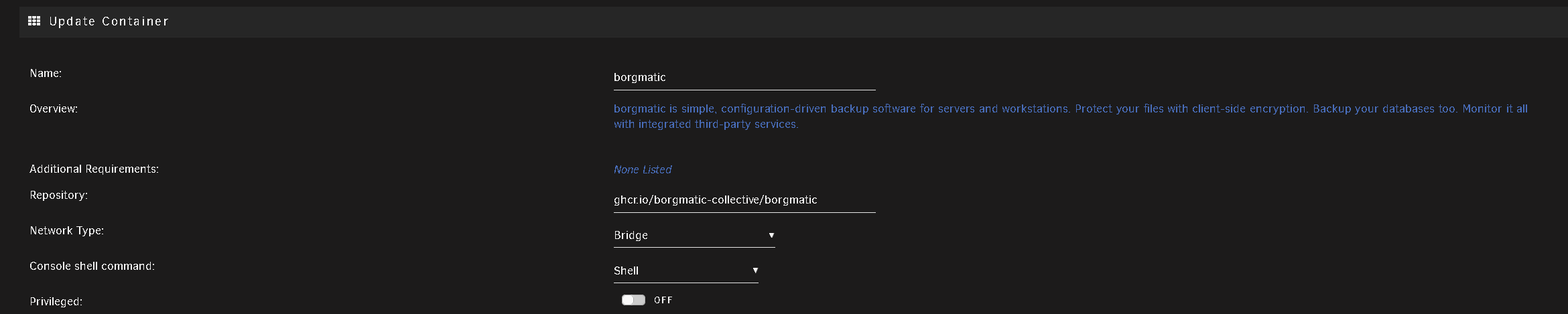

OK, @Greygoose and @stridemat, I updated the CA template to point to a static location for the borgmatic icon.  Future pulls should get this, but I'm not sure if it will automatically update for you.
To manually fix, go to advanced view in the Borgmatic docker container config.  Change "Icon URL" to
https://raw.githubusercontent.com/Sdub76/unraid_docker_templates/main/images/borgmatic.png
This is a static copy that I have in the CA repo, so it shouldn't change unless github changes it's static URLs.
