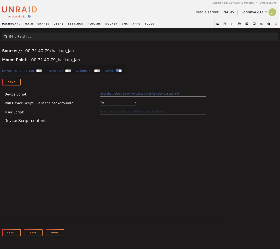

  2. Hi, getting some trouble too. i was using the docker container for tail scale. was working flawless. since a few days it stops working. I switched to this plugin version. same problem. i connect 2 unraid server together. then I want to mount a share with unassigned devices. Ping Unraid <-Tailscale-> Unraid works good. connection ok. But unassigned devices say, mount point is offline... in network settings, I set the network extra "tailscale0"... but there seems a setting I missed? the past 1 year it was working good. any idea? 🙂
  3. Hi, getting some trouble too. i was using the docker container for tail scale. was working flawless. since a few days it stops working. I switched to this plugin version. same problem. i connect 2 unraid server together. then I want to mount a share with unassigned devices. Ping Unraid <-Tailscale-> Unraid works good. connection ok. But unassigned devices say, mount point is offline... in network settings, I set the network extra "tailscale1"... but there seems a setting I missed? the past 1 year it was working good. any idea? 🙂 Edit: Netbios is off tryed the extra smb conf NASty-tailscale-diag-20240306-213055.zip
  4. that was it. Thank you. a quick question. There was a standard device script in the folder to get notifications when mounting is done or not. I don’t find the .sh script anymore. Was it deleted by accident? Where can I find it? Regards
  5. disabled it. not working 😞 Here 🙂 Thank you nasty-diagnostics-20230622-1541.zip
  6. Hi, getting trouble since upgrade to latest unraid with booth unraid servers. I want to mount a remote share connected via tailscale. connections between servers are active and ping is ok. log says: Jun 21 14:00:50 NASty kernel: CIFS: VFS: Error connecting to socket. Aborting operation. Jun 21 14:00:50 NASty kernel: CIFS: VFS: cifs_mount failed w/return code = -111 Jun 21 14:00:50 NASty unassigned.devices: SMB 1.0 mount failed: 'mount error(111): could not connect to 100.72.40.79Unable to find suitable address. '. Jun 21 14:00:50 NASty unassigned.devices: Share '//100.72.40.79/backup_jan' failed to mount. I deleted the share and add it again, reinstalled tailscale and rebooted server. No solution for now?

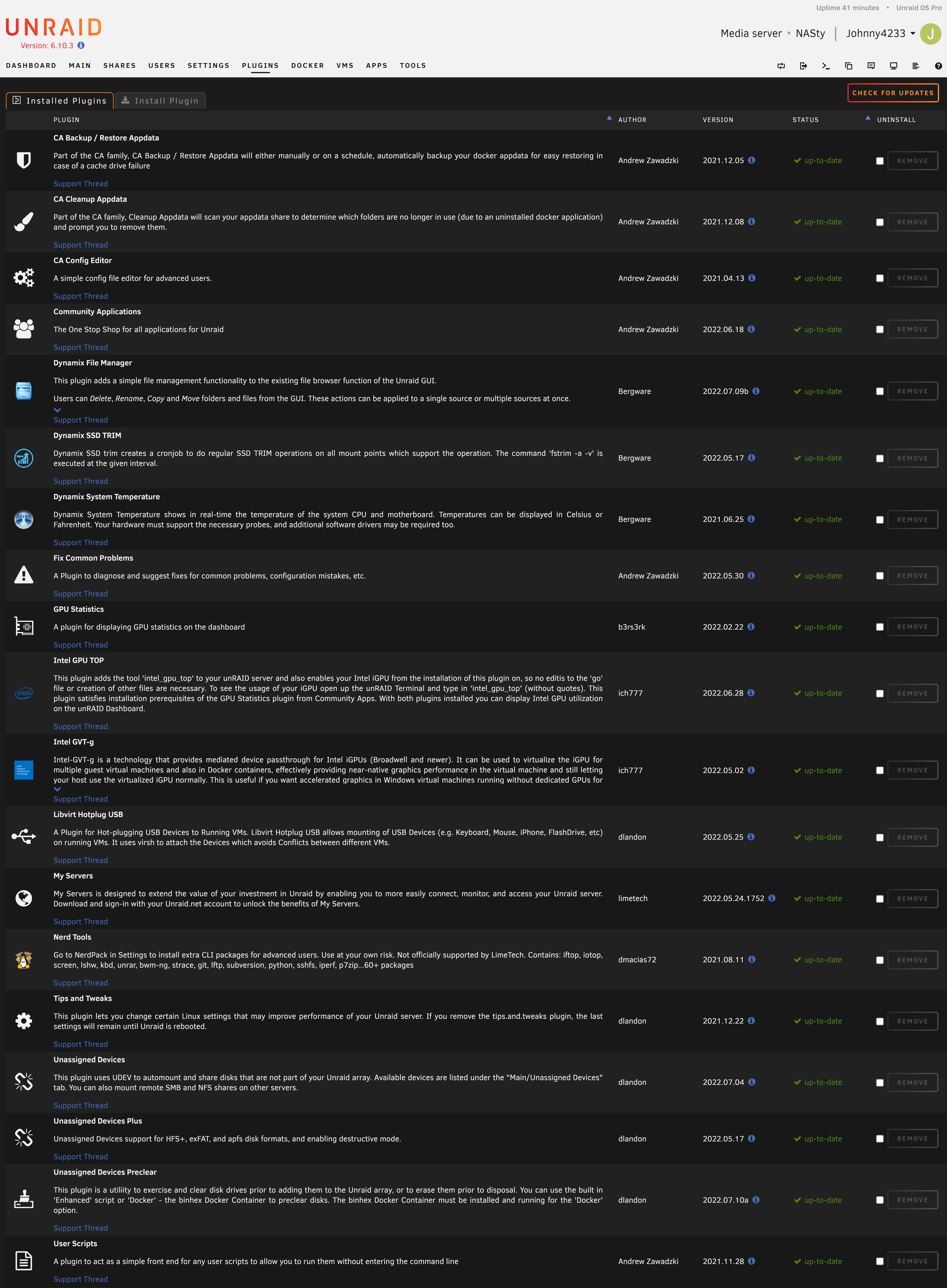

  8. Nachdem gestern noch ein Update für ud preclear kam, konnte ich das Plugin wieder installieren und nun läuft das Script auch im Hintergrund und auch bei einem reboot des systems genauso wie ich es gebraucht habe.
  9. Seems to be working good with the older tmux version. Great. Thank you 🙂
  10. No I mean, any userscript did not run in background… in log it shows that it will execute it, but then the error message above appears and the script does not run. It’s a simple mounting script for unassigned devices… look at my other thread here.
  11. Naja, wann ich das Update für ud preclear gemacht habe weis ich nicht. Mir ist das Problem nur heute aufgefallen, da das Script im Hintergrund nicht lief und durch ein wenig googeln und hier stöbern dann rausgefunden hatte, dass das Plugin wohl den Fehler verursacht hat. Naja wie gesagt, habe das Plugin erstmal entfernt und neu gestartet. So oft brauch ich preclear nun nicht, das ich drauf verzichten kann erstmal. So kommen keine Fehler mehr und die Scripte laufen.
  12. So i deleted the UD Preclear plugin. Reboot... Error does not come up and my userscript runs fine. Thank you. I hope Unraid 6.11-rc1 fixes this 🙂
