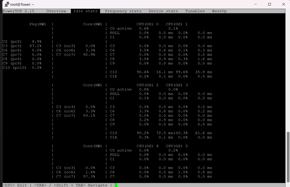

  4. You are right, L1 enabled and not any change in C-states. Anyway thank you with that command! Still max C3 for package in my case
  5. I have a problem figuring out how to achieve deeper package C-states than C3. I found somewhere in this forum list of rigs and C-states achieved by it's users but can't find it right now but there was someone that achieved C8 with my motherboard and CPU in Unraid. Is there something that i missed? CPU and Cores achieves C10 with no issues in PowerTop but Package is not. Motherboard: MAG B660M MORTAR WIFI DDR4 CPU: i5-12500 All devices disconnected except OS USB -> BIOS disabled Turbo Boost -> BIOS ASPM turned to L1 for all devices -> BIOS ASPM native enabled/disabled (tried both) -> BIOS audio, LED, USB3 ports disabled -> BIOS Wake on LAN enabled because I need it -> BIOS and OS Array stoped connected via SSH web interface closed pcie_aspm=force in syslinux.cfg I found that 1c.0 PCI bridge can't be switched to L1 - don't know why. And there is no endpoint assigned to it. I think it may cause my issues with C3 I've tried to figure it out and it seems that the end point should be 02.00.0 @Johnny159 regarding your advice I've tried to execute script before, but it seems that there is wrong value set in register. I hoped that you had similar issue. For other devices script works good I used script from here https://z8.re/blog/aspm but the value is not valid. Any help and advice kindly appreciated.

  10. So there is no other way than changing both CPU nad MOBO? 2021 I'm also using CoreFreq but I'm not sure yet how to properly read C-States data in that tool
  11. Hi, I think my power consumption is quite to high for my rig. Do you have any advices how I can improve it? Also, CPU never achieves power state lower (higher?) than C3 and my IDLE stats are too high aswell. I'm measuring power via smart plug which shows it betwen 37-42 W. 37 W - complete idle with array stopped 42 W - Array started, Dockers: Tailscale, PhotoStructure, qbittorrentvpn, Plex-Media-Server. No users connected to any of them "powertop --auto-tune" is obviously done Powersave governor also enabled CPU: i5 12500 MOBO: MAG B660M MORTAR WIFI DDR4 PSU: Corsair RM550x RAM: GOODRAM 2x8GB 3200MHz CL16 IRDM X Black HDD: 3x Seagate IronWolf 4 TB ST4000VNZ08
