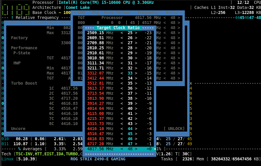

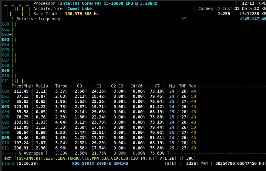

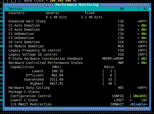

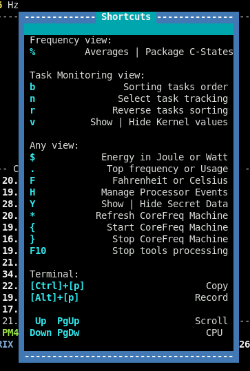

  • corefreq.cfg has been made for the UI purpose only. Mainly that file will save the windows disposal.   Features involving Processor are not saved at any time.   After tuning p
Main Screen:
Set Processor states:
Dashboard:
Performance Monitoring:
Tools Menu:
[F1] Shortcuts Menu:
[F2] Main Menu:
[F3] View Menu:
[F4] Window Menu:
