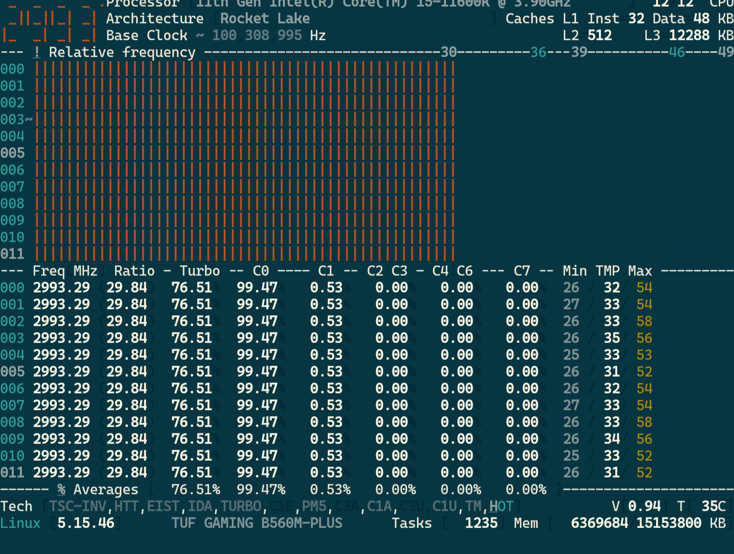

  • Ctrl + p To screenshot current screen. The output file corefreq-xxxxxx can then be read with command less -R   Alt + p To record everything as an ascii-cinema. Video duration can b

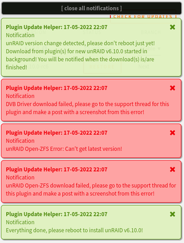

If you got a error message like this while upgrading to 6.10.0:
You can safely ignore that, the plugins are already built and this is caused because the Kernel detection fails on 6.10.0
The plugin packages will be downloaded on boot (as long as there is an active Internet connection on boot).

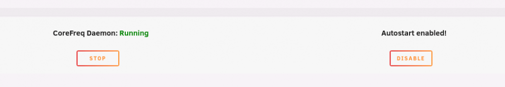

Have you enabled the CoreFreq service and also the Autostart here:
CoreFreq Daemon and Autostart is active as per this image.

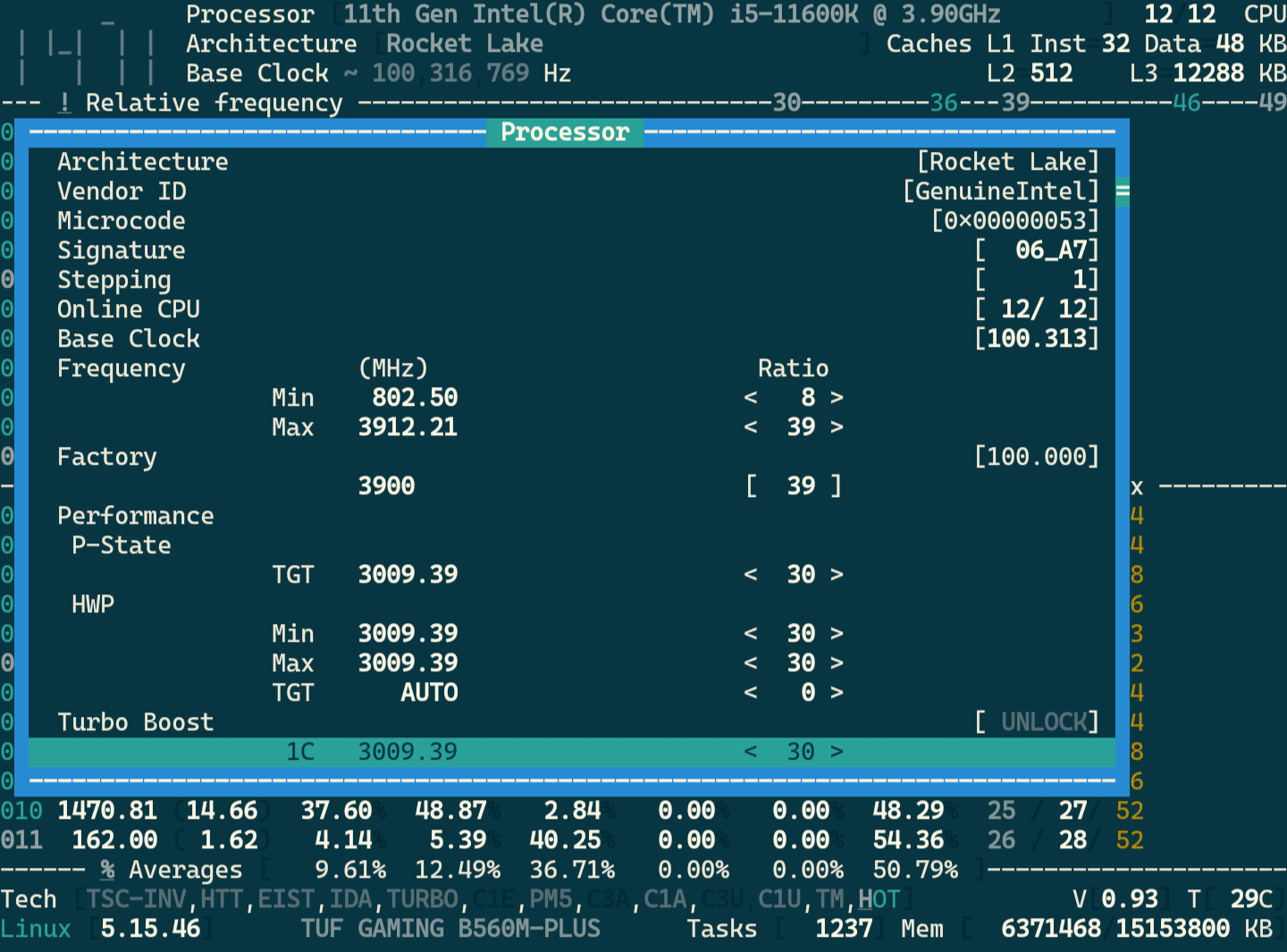

What kind of settings do you want to save exactly?
I thought that the cpu multipliers for base and turbo boost might save / restore at boot.
I was trying to set 3.0GHz as the max any core can go rather than 4.9GHz.
@CyrIng can you help here please...

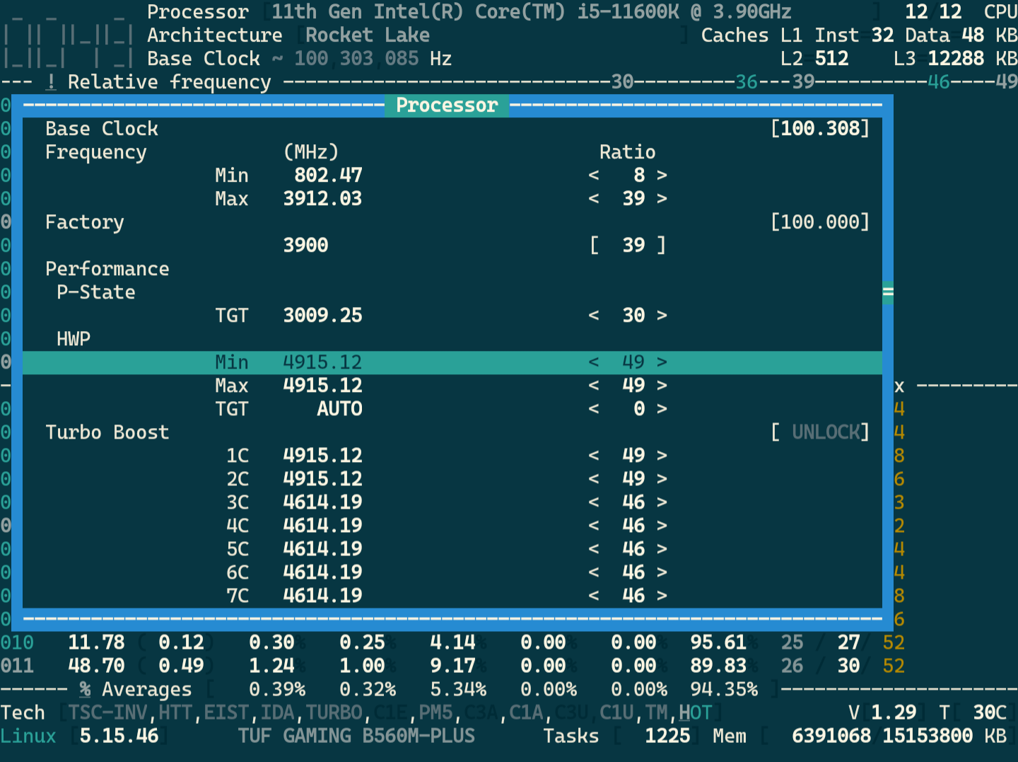

For your testings are available 2 new startup parameters:
* Ratio_Boost
* Ratio_HWP
Pull develop branch at https://github.com/cyring/CoreFreq/tree/develop
For example:
insmod corefreqk.ko Ratio_Boost=-1,-1,-1,-1,-1,-1,-1,-1,-1,-1,-1,-1,-1,-1,-1,-1,10,24 TurboBoost_Enable=0,1
Which means, from Turbo ratio 18C down to 1C, value -1 keep current hardware ratio, other positive is your new Turbo frequency ratio
Special case of AMD/Zen:
Parameter TurboBoost_Enable=0,1 means value 0 at first to disable Turbo and allow changing P-State ratio from list Ratio_Boost ; at second, value 1 means restore Turbo after changed.
This is not required with Intel.

@CyrIng
This was via Android App, JuiceSSH with 'Solarized Dark' theme.
You will observe a visual difference when running in Console or Xterm

Could just be me being stupid but;
Trying to register the cpu-freq driver, comes up with an error 'File Exists', idle comes up with 'device or resource busy' governor and clocksource work fine.
ROG CROSSHAIR VIII HERO (WI-FI), AMD 5900X, UNRaid 6.10.3
Any thoughts?
How did you try to load the driver?
Daemon is set to autostart (and runs fine as far as I can tell), trying to register the driver in 'Menu > Settings > CPU-FREQ Driver'
Should I be loading this a different way?
One will need to unload any running cpufreq driver before attempting to register CoreFreq.
Those mainstream driver names depends on processor model (acpi, amd_pstate,...)
CLI can display current  drivers
See Readme, Wiki, of project.
