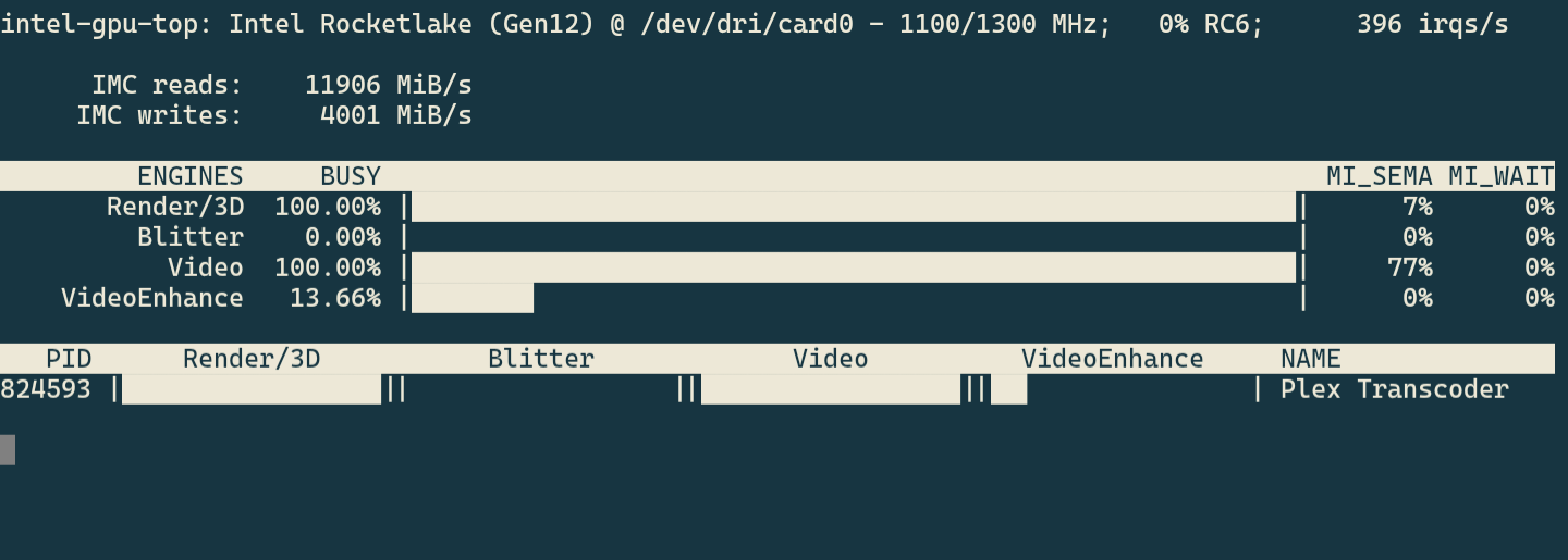

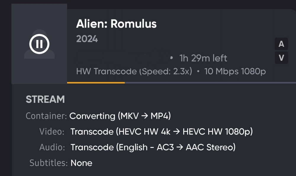

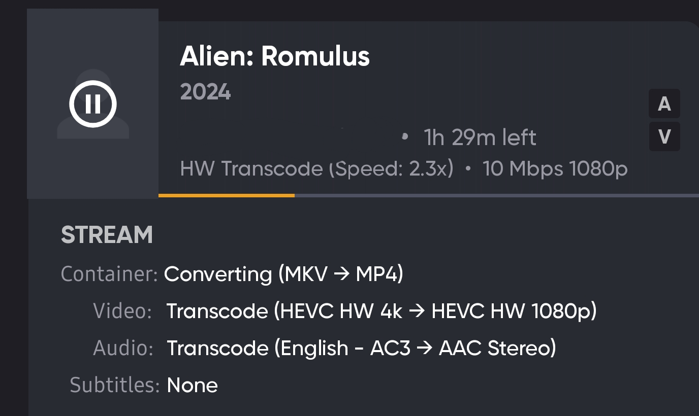

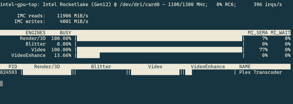

  4. Do you have some performance numbers available if you use plex and transcode? If so, how many 4K HEVC Remux streams can you simultaneously transcode using the new HEVC update / release? e.g 1080p HEVC 12Mbps or 1080p HEVC 20Mbps (which is actually 4K)
  5. Does anyone have performance numbers for expected remux 4K UHD streams transcode to 1080p 12Mbps HEVC (latest plex public release) on 12th gen intel? I have a 12600k, Plex as docker on Unraid and can only just process 2 transcode stream HEVC 4K Remux to HEVC 1080p 12Mbps. Occasional pause / buffer on second stream. Can confirm that HW transcode is working. Intel_gpu_top shows the 3D load at 100%. If running a single remux UHD Remux HEVC to 1080p 12Mbps HEVC the fastest speed shown is 2.3x but it can drop down under 2x .
  6. Did you ever get a fix / solution? I think my 12600k is under performing when it comes to 4k 50mbps HEVC to 4k 20mbps HRVC or 1080p 12mbps HEVC
