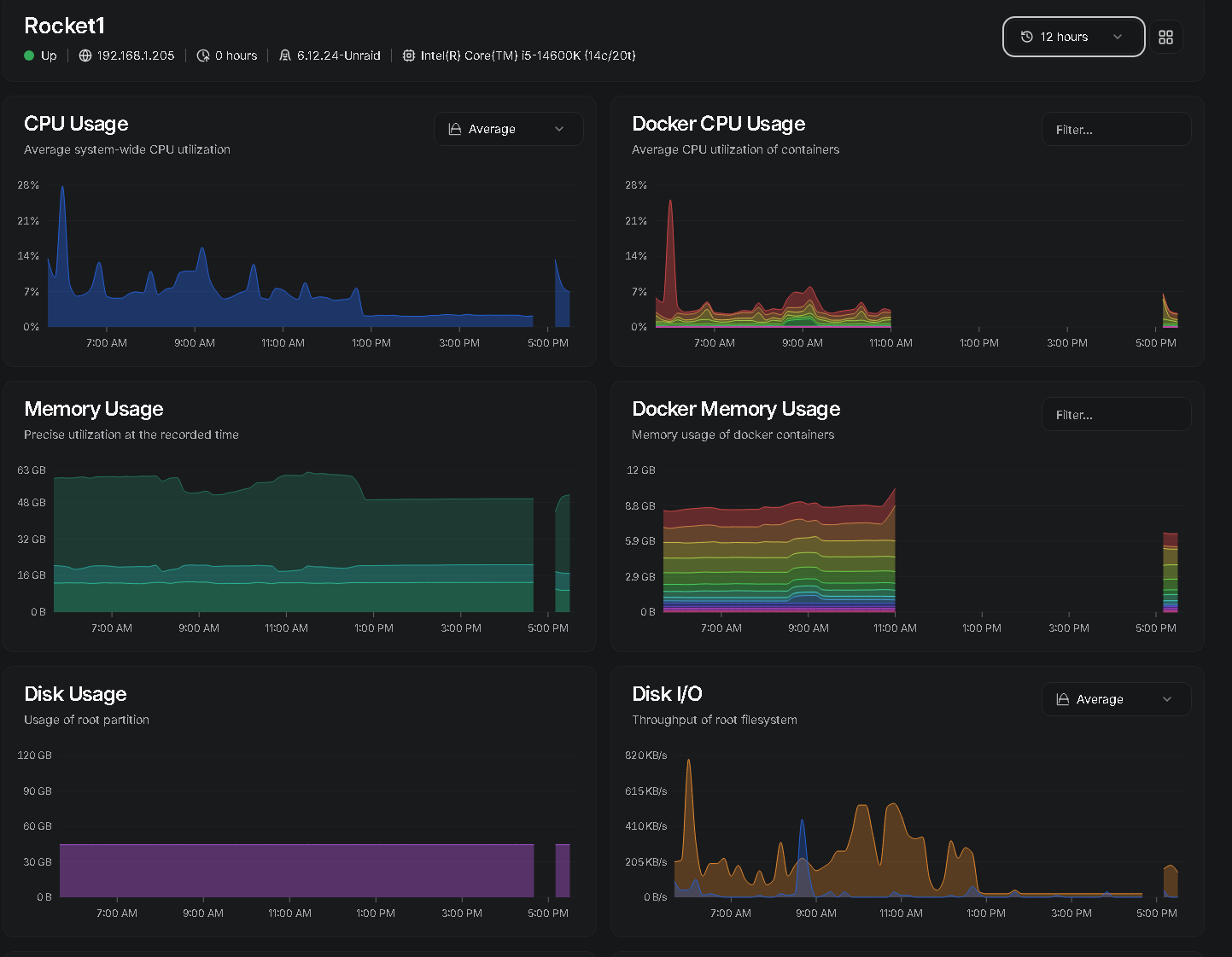

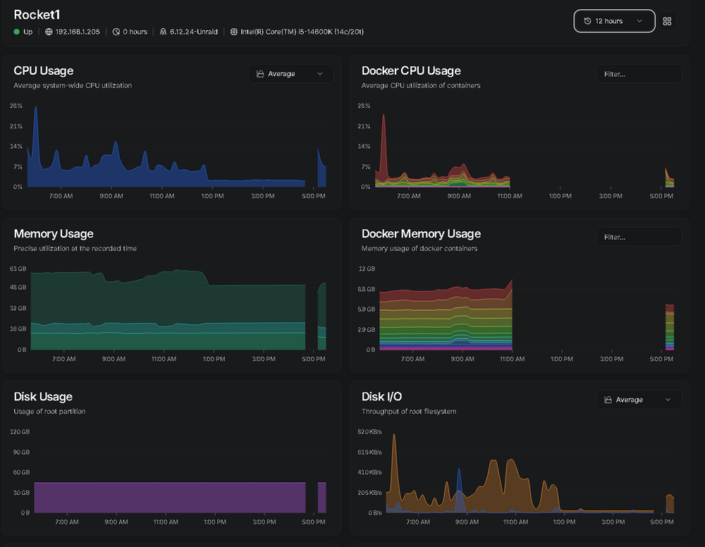

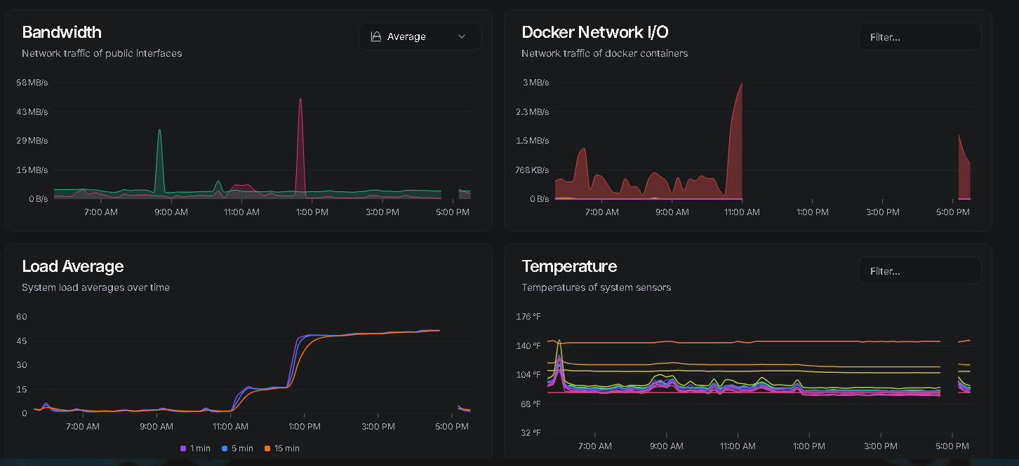

  2. odd enough, it looks like the system was up to some capacity, pulled this from my Bezel log of the last 12hrs. Not everything was reporting though.

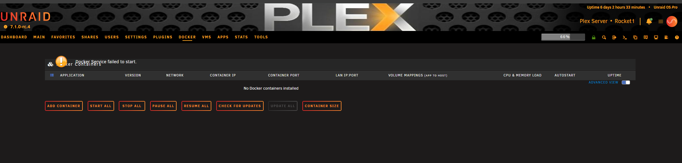

  12. Because I was running Ollama and a couple other large images that needed the space, I never reclaimed it. figured to just leave it be. I do not have any apps writing any data there. I will have to double check to see if one is setup that way... checking...
  13. Odd issue has started to become a reoccurring one... every f or so days my docker apps stoip responding. Some docker apps seems to keep running while most stop. The docker page only shows "docker is not running" and none of the apps showing. I end up having to reboot to fix. not sure what could have caused this. Currently on unraid 7.0 (however just updated to RC4 and rebooting as I am typing this) intel 14600k 64gbram (will be swapping in my 96GB kit back in tonight or tomorrow) Asus Pro Art Z790 motherboard HBA with bunch off HDD and m.2 Please let me know if there is any other info needed. Thank you diag.zip

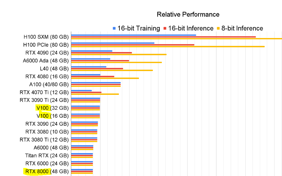

  14. I have come across that post in the past... there is a lot of technical talk that is above my head (and I thought I had decent understanding of things) So I take it the GV100 would be the "better" direction to go? As far as general performance due to having higher Tensor + Cuda core count? I understand due to how fast the Tensor cores are they are usually "idle" waiting on memory, so assumption would be a card with faster / better memory would be more efficient. Correct assumption? On the performance chart they have on the site, they show the V100 vs the RTX 8000... looks like the V100 is shown to have an edge. (basically the same as the GV100 if they are referring the the PCIe version of the V100)
  15. I have asked this not too long ago, however my budget has changed... so my GPU selection has changed. Due to the pricing being "close-ish" I am looking at the Quadro GV100 and the RTX 8000 GV100: 32GB Ram (HBM) RTX 8000 48GB RAM So I am looking at 2 things, Yes, I know the RTX 8000 has 16 GB more ram.. and that alone is almost a reason to go that direction. However, for AI workloads, does the HBM on the GV100 give benefit having a higher bandwidth and MUCH larger interface bus? Also the GV100 does have more Cuda and Tensor cores... I understand they are technically a generation older... not sure how much that matters. So put aside the memory size, what would be the "better" card to go with? I do plan to get a 2nd one eventually no matter what card I go with... so down the road I will have 64GB or 96GB of Vram...either way will be plenty. Would I assume correctly that the RTX 8000 would be the better card, or does the HBM give the edge to the GV100? Thanks!
