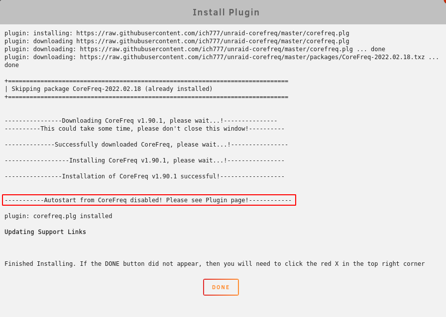

27 minutes ago, sittingmongoose said:
Are there any plans to update this plugin to support RC4?
It supports RC4…
Do you have any issues?

corefreq-ro-shm: 'No such file or directory' @ line 19075
is the error i get in CLI.  I just tried to uninstall it and reinstall it.  I was getting a warning from fix common problems saying its not supported too.  I am using a 10850k cpu and it worked before on the last stable release.

9 minutes ago, sittingmongoose said:
Daemon connection error code 2
I will look into this ASAP, give me a few hours please.

17 minutes ago, sittingmongoose said:
Sorry i was wrong about fix common prolems.  It was a handful of other plugins.
Do you have Autostart on the plugin page enabled? Seems like it's disabled and that's why it's not working...
Have you seen this:
EDIT: Had to do this since it crashed some servers and with this method you first have to do a test on the plugin page before you can actually use it.
I didnt realize I had to start the plugin, it must have been autostart before.  I got it working, thank you!
