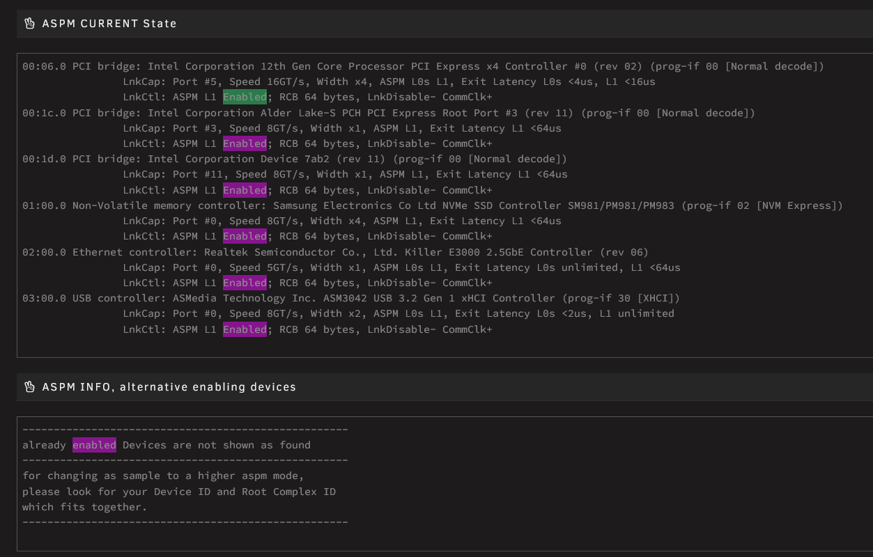

Forgot to mention: I found it because of your suggestion to see which Docker was started seconds ago. I had a look at the syslog now, the spam stopped 19:33h. At around 19:39h, I can see the messages for "unapply autotweak settings" when I uninstalled it, where all CPU settings went back to "performance", which huts a little :) not sure what I did in the minutes between those events, but my last post was from 19:40h, so it checks out I understand. I don't have the powertop --auto-tune as part of my go-file, so it's currently not active. But I rarely had crashes during high system usage, mostly in idle. I also have ASPM helper installed, for the NVMe and NIC if I recall correctly. Is that also something I shouldn't be doing? I will wait for the parity check to be over (will take ~1½ days) till I can see how this affects the power consumption. I also had a look at my syslinux config: kernel /bzimage acpi_enforce_resources=lax append initrd=/bzroot usb-storage.quirks=059f:105e:u The usb-storage entry is for two Backup-HDD-cases, which have a hard time mounting under UAS; this forces them into the legacy USB mode. The acpi-enforce is for reading out systemps (but I don't recall when I put that in, could be there for some time and may not be even needed anymore, not sure). Could those be issues? Also, I am still on unRAID 7.2.6, I am not that fast with updating. Maybe I should. Best, Rick

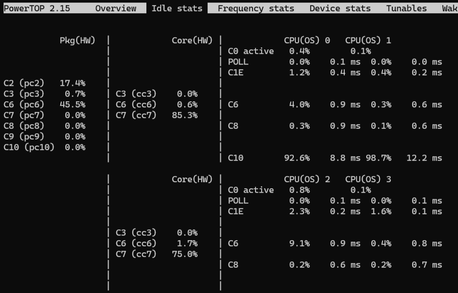

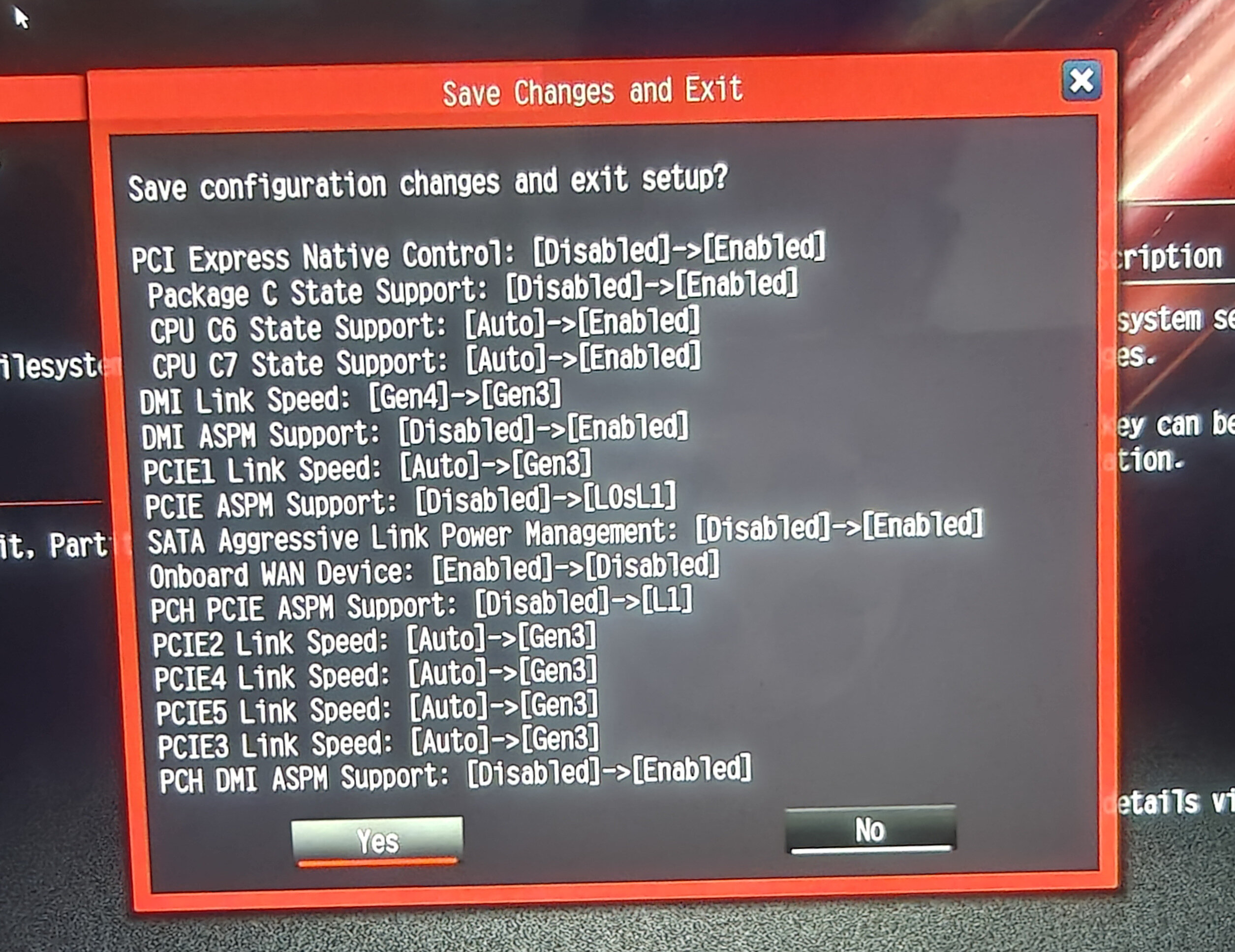

Juti. Ich habe mir nochmal den BIOS Dump angeschaut, da gibt es auch die Settings PS_ON Enable(" Enable or disable PS_ON ()support a new C10 state from the CPU on desktop SKUs that enables a lower power target that will be required by the California Energy Commission (CEC).") und C10 Dynamic threshold adjustment ("Enable/Disable C10 dynamic threshold adjustment"), auch zwei so unsichtbare Settings. Die habe ich mal testweise angemacht, aber nichts. Das BIOS lädt zwar nicht die XMP Settings, aber setzt den RAM auf 1,35V - manuell auf 1,2V ändert sich aber auch nichts. Du hast natürlich recht, dass man das im Idealfall vorher nackt macht. Eine andere Config ist nur (im Moment) einfach nicht drin. Ich will die ASM raus haben, und habe keine andere NVMe für den Cache. Da es eine OEM ist (lange Geschichte) glaube ich langsam, es liegt wirklich an der NVMe; ich habe es nun nicht getestet, weil alle Shares umstellen und im Zweifel auch die NVMe leer machen ist mir gerade ein wenig zu viel ☹️ Ich werde die Augen nach einer besser geeigneten 2TB Ausschau halten, falls sich mal ein Schnapper ergibt. Es ist und bleibt eben ein Produktivsystem, was auch genutzt werden will, und ehrlich gesagt ist <20W ("nackt", ohne Lüfter und Docker) auch kein schlechter Wert. Ich hab nun mal den Service und die Standard-Docker wieder angemacht (kein Plex, die Meute ist nicht kontrollierbar). Jetzt hat sich mir nicht erschlossen wieso so viele Disks hochspinnen, und nach minimaler Investigation stelle ich fest, dass der Clouds-Share den Cache nicht nutzt; vermutlich aus der Zeit wo ich annahm dass ich "wichtige" Daten grundlegen nicht eine Sekunde ohne Parity haben sollte, sprich bevor ich auch nur einen Gedanken an Strom verschwendet habe; lange her. Na gut, das zu korrigieren wird auf kurz und lang eine Menge Strom sparen 😅 vielleicht sollte ich auch mal Paperless auf eine HDD begrenzen, damit bei der nächsten Steuererklärung auch nicht alles hochspinnen muss, weil ich zwei Zahlen in einem PDF nachschauen will. Nach ein paar Minuten stecken wir bei ~24W, mit Docker aber ohne Lüfter. Das ist doch erstmal okay. Dann starte ich ihn nun ein letztes Mal für heute neu, um die Lüfter wieder anzuschließen, und sobald der Ersatz für den Exhaust da ist, wird er wieder "dicht" gemacht. ich bedanke mich herzlichst bei Dir @_alo_ , von ganzem Herzen, für die tolle Unterstützung! Beste Grüße

Hm, verstehe. Bei den aktuellen Preisen will ich natürlich tendenziell keine neue SSD kaufen. Ich meine, der Verbrauch ist ja absolut im Rahmen, nur die C-States sind "merkwürdig". Und kostenlose 3W weniger nimmt man ja auch mit :) Aber vielleicht einfach mal testen um zu evaluieren, ob es daran liegt, ist vermutlich nicht so blöd. Dann weiß man es für die Zukunft, wenn sich ein Umbau ergibt. Kann ich denn die Cache SSD, wenn die auch gerade als solches genutzt wird, einfach mal raus nehmen und ins System booten, ohne dass es mucken macht, wenn ich sie später wieder rein schiebe? Beste Grüße

Als jüngerer Mensch war ich zwar kein Übertakter, aber ich habe viele Magazine gelesen, und meine mich zu erinnern dass mit der Einführung der K-Modelle im Grunde nur den offenen Multiplikator mitbringen, wodurch sich dann erschlossen wurde, dass es vermutlich "die besseren Chips der gleichen Wafer" seien. Ob da jemals was dran war, wer weiss. Der RAM ist so ein peinliches Gaming-Kit, was auf der Arbeit übrigen geblieben ist. Hat natürlich so XMP 2.0 Zeug, aber ich habe das im BIOS nicht wissentlich aktiviert. Vielleicht sollte ich nochmal schauen, ob da irgendwas als Default gesetzt wurde, was nicht sollte. Der Server stand nun gute zwei Stunden rum "wie er war", weil ich spontan raus bin. Messgerät ist noch immer bei den ~20W, und C6 der geringste State. Werde nochmal einen Blick ins BIOS werfen 🙂 Beste Grüße

das Nachwort zum Start: jetzt hab ich diesen Post runter getippert und will in aller Deutlichkeit festhalten, wie dankbar ich für Deinen tollen Support an diesem sehr heißen Tag bin! In Deinem ersten Post hier gab es die angepassten BIOS Settings, da stand nichts von C10 (von den Gigabyte vorher kenne ich das aber auch so). Dem Post nach hattest Du danach nur noch mit SCEWIN das Setting angepasst, und dann ging es in C10 (Du sagst ja auch, dass dieses angepasste Setting ein "unsichtbares" ist, was man nicht im BIOS sieht; zumindest habe ich da auch nichts anderes in Richtung C States gesehen). Ich bin nochmal durch den Thread und habe explizit nach BIOS und C10 gesucht, ein Nutzer erwähnte er habe noch was im BIOS anpassen müssen, aber da ging es um Windows (SR-IOV, das scheint mit VMs zu tun zu haben, die aktuell ja nicht mal aktiviert habe). Ein anderer schrieb noch was davon dass "TurboBoot" deaktivieren helfen könne, aber das habe er nur anderswo gelesen, wurde im Thread nie weiter behandelt. Hier wird gesagt, dass nach der Treiberinstallation C10 dann ging. Ich habe keinerlei Treiber installiert, aber "Intel GPU TOP" (das ist das einzige iGPU bezogene Plugin, weiß nichtmal wofür ich das habe, haha) Ich hab mal testweise HDMI Kabel (Bildschirm war vorher aus) und Tastatur-Dongle abgezogen, und auch die vier USB Kabel fürs Backup (Backup HDDs sind jeweils hinter zwei Tasmota Relais, beide die ganze Zeit aus). Bleibt bei C6 für Pkg(HW) Da haste nen Punkt, dachte mehr Platten=mehr Strom, aber die sind ja auch mit Helium gelagert usw... ich stecke auch nicht im Thema, war einfach eine Milchmädchenrechnung von mir. Sehr faire Frage! Ich hatte mit Abstürzen zu kämpfen, was auch der Grund fürs neue Setup ist. Vorher der i5-13500. Hier im Forum (englischer Teil) hatte ich (glaube mit JorgeB) erörtert, dass diese Core-Degradation, woran die 13te Gen leidet/gelitten hatte (das fixende BIOS Update kam einen Monat nach dem Aufbau, das hatte ich nicht mitbekommen), eine Ursache sein könnte; meine CPU stand nicht auf "der Liste", aber dennoch. Also habe ich den auf Garantie zurück geschickt. Dann nach Alternativen geschaut. Naheliegend war natürlich der 12500, aber das Ganze war Januar 2026, und die Preise waren verrückt. Der 12600K war einfach die günstigste Option (habe meine Notizen gefunden: 12400 war 5€ günstiger aber auch deutlich schwächer, der 12600 non-K ~35€ teurer, der 12500 20€ teurer; die günstigen F gingen nicht, weil ich die iGPU brauche). Der K hat natürlich die höhere TDP, aber ein paar anderen Threads (u.a. auf Reddit) nach mache er beim Stromsparen keine schlechtere Figur, daher hab ich den gewählt. Ein Unterschied zum alten System fiel mir jetzt noch ein: damals war ein ein einziger DDR4 Riegel, 32GB. Heute sind es 4x DDR4 16GB Riegel. Wird einen kleinen Unterschied machen, aber vermutlich auch nur so 3-5W? beste Grüße

Hehe, als ich es kaufte kannte ich Dich noch nicht, aber die Empfehlung kam selbstredend aus diesem Forum, im Kontext des Stromsparens! Ich glaube die Empfehlung kam damals von @hYtas . Die NVMe ist eine Samsung 970 Evo Plus 1TB. VMs fahre ich aktuell nicht mehr (mein HA ist auf einen Thinclient umgezogen, und die Windows war seit Monaten nicht an, daher Service deaktiviert). Ich messe mit einem zumindest bislang halbwegs zuverlässigen, aber generischen Strommesser den man so zwischen steckt, mit Display; eigentlich hängt der Server an einer Tasmota, aber die ist am "Endstandort" verbaut wo ich nicht ohne weiteres ran komme; aktuell steht er seit dem Umbau auf dem Esstisch, haha 🙂 ich hab mir auch nochmal meine ganzen Werte vom letzten System angeschaut, da sind die neuen hier dann etwas ernüchternd (damals neuere, vermutlich effizientere CPU (hatte vermutlich die Core-Degradation, deswegen getauscht), eine dumme Lüftersteuerung, die ggf sogar aus war (die neue kann nur minimal 25%, was an Tagen wie heute aber vermutlich auch zu wenig ist, haha), aber eben auch viel mehr HDDs und die zwei ASM; Lüfter und PSU identisch). Ich hab den Server, ohne Docker und VMs, jetzt schon so 30-45min laufen lassen (WebUI aus und Powertop via SSH gecheckt), da hatte sich nicht viel getan. Ein LLM (Schande auf mein Haupt) behauptet, C6 minimum sei realistisch bei angesteckten HDDs, aber das glaube ich nur bedingt. HDDs sind ein bunter Haufen: 22TB (Parity), 2x 12TB, 1x 10TB, 1x 8TB, 3x 6TB (falls das relevant ist, weil Größer = mehr Verbrauch auch im Spindown, oder so) Ich fahre derzeit noch unRAID 7.2.6, könnte ich vermutlich auch mal updaten. Ich war gerade im Begriff die HDDs im Case neu zu sortieren (die sind mitunter noch auf den Positionen aus den 12-HDD-Zeiten, die... sagen wir mal, nicht ganz konventionell sind), aber habe ihn jetzt nochmal ohne Lüftersteuerung gestartet (vermutlich sollte ich einen externen Ventilator aufs Case knallen, haha). Setup wieder mit disabled Docker und VM Service, Array gestartet, aber alle Spindown, --auto-tune ausgeführt (ist noch nicht wieder im Go-File, weil es beim alten System Probleme gab) => ~20-21W Damit war meine Schätzung von 4,5-7W immerhin nicht komplett am Leben vorbei 🙂 Die Lüfter sind in meinen Augen so notwendiges Übel. Die Max-Lüfter haben ja schon ihre Daseinsberechtigung, die habe ich explizit für den Sommer angeschafft. Es ist jetzt in etwa 20 Jahre her, aber mir ist in einem heißen Sommer tatsächlich mal eine 300GB HDD (das war damals recht viel und teuer) im Sommer durchgeflackt, natürlich war das ein anderes Kühlkonzept im Case (=gar keins), und der Raum war Holzvertäfelt mit Fenstern Richtung Westen, aber dennoch: war ein Lehrmoment 😅 Beim aktuellen Wetter sind die Max auch wirklich nicht die schlechteste Idee, zumindest im Betrieb später. Also, ohne Lüfter und Docker ~20W, das wirkt dann ja fair, auch wenn ich nicht unter C6 komme. Wäre natürlich die Frage ob man mit echo powersupersave > /sys/module/pcie_aspm/parameters/policy oder pcie_aspm=force (in der Syslinux Config) noch was erreichen könnte, oder ob ich Vollidiot was im BIOS übersehen habe. Oder die verwendete SCELNX64 Methode doch nicht korrekt war. Beste Grüße //edit kleine Korrektur: ich sehe gerade, dass der Exhhaust-Lüfter (Fractal Design Silent 140er) nicht an der PWM-Lüftersteuerung hängt, sondern an der Case-Internen Lüftersteuerung. Ist nur DC und kein PWM. Das Case ist ein Fractal Design R5, die Lüftersteuerung ist ja nur ein primitiver Schiebregler der 5, 7 und 12V durchschaltet und wird wenig Eigebverbauch haben; ich will die jetzt im laufenden nicht abklemmen, aber habe mal den Lüfter abgezogen, jetzt schwankt das Messgerät zwischen 19,5 und 20,5W. Nicht viel, aber immerhin. Werde den Lüfter gegen einen PWM ersetzen (nicht wegen des Verbrauchs, aber dann ists ordentlich und ein etwas stärkerer wäre auch nicht verkehr)

Ich bin mal so frech und buddel diesen alten Thread aus, weils ja auch genau das Thema ist (und ich mich immer schäme, drei Threads zum selben Problem aufzumachen) @_alo_ hatte mich hier über die Besonderheit mit den ASRock Boards nochmal aufgeklärt. Das ist drei Wochen her - während dieser drei Wochen ist das ASRock Board hier angekommen, ich habe den Server auf dieses umgebaut, und ich habe "ein paar" Tage mit unbalanced mein Array neu sortiert. Das Setup ist denkbar simpel: keine Zusatzhardware (PCI Express oder USB Geräte), nur 1x NVMe und 8x SATA Disks; dazu der unRAID-Stick (hängt im Gehäuse an einem USB2-Header-zu-USB-A Adapter), der Dongle meiner Tastatur (für BIOS Einstellugen, ist nur temporär dran). Am USB3-Header hängt eine 2x USB3 Erweiterung (PCI Slotblech, quasi Front-USB für hinten). 4x DDR4 16GB DIMM, i5 12600K, be quiet PurePower 12M 550W (kommt bei unter 10% Last immerhin noch auf >80% Effizienz) Am Netzteil (aber nicht am System selbst) hängt eine Lüftersteuerung, die aktuell bei 25% PWM insg fünf Lüfter bedient (zwei "silent" Modelle, 120 und 140, dann 2x Arctic P14 Max und 1x Arctic P8 Max; wie gesagt nur 25%, aber die saugen ja generell gern was mehr). Dazu noch zwei Lüfter am CPU Kühler, die hängen am Board (nach UI ~850 rpm) - BIOS hatte ich direkt beim Umbau auf das aktuelle, Oktober 2025, aktualisiert. - ich habe den BIOS "Mod" via SCELNX64 gestern gemacht (aber eine andere Methode als in Post1 beschrieben, wo man die .txt ausgibt, dann ändert, und wieder einspeist; nach erneutem dump ist die Änderung auch noch drin). - dann habe ich alle BIOS Settings aus Post1 übernommen (hatte im Verlauf keine aktuelleren gefunden), siehe Screenshot; einziger Unterschied ist Onboard-Audio, was ich schon beim Umbau deaktiviert hatte. - keine separaten Realtek Treiber installiert, aber via ASPM-Helper die beiden Problemkinder rein gemacht, das geht auch durch (siehe Screenshot). - powertop --auto-tune ist ausgeführt, und alle Tunables stehen auf "good" - in powertop hänge ich bei minimal C6. Bei den CPU Einträgen hält sich die Waage zwischen C7 und C6. - aktuell sind Docker und VM Service deaktiviert, sprich nichts läuft, Array komplett im Spindown. => ich messe einen Verbrauch von etwa 24W (schwankt ab und an hoch) Nun weiß ich natürlich das Platten auch im Spindown noch so 0,5-1W verbrauchen, und die Lüfter (auch bei 25%) in dem Rahmen sind; die Lüftersteuerung schätze ich mal auf 2W insg. Also sprechen wir von einer "blinden Belastung" von etwa 8,5 bis 13W, rechnet man das raus läge man bei 11 bis 15,5W Gesamtverbrauch. Das man das so nicht 1:1 rechnen kann ist mir bewusst, mir geht es eher um den "Ballpark". Langer Rede kurzer Sinn, bzw meine Frage: Ist das, in diesem Setup, ein tragbarer Wert? Ist es normal, dass ich mit angeschlossenen Disks nicht unter C6 komme? Es ist klar, dass die Beurteilung der C-States/des Verbrauchs im Idealfall mit einem nackten System gemacht werden, mein Punkt ist aber der, dass ich kein nacktes System benutze 🫣 Also, wenn ich C10 problemlos ohne Disks erreiche ist das für mein Nutzungsszenario nicht so relevant Gefühlt sind ~25W bei 8 Disks und NVMe (auch wenn Docker nicht laufen) akzeptabel, oder sehe ich das falsch? Beste Grüße
