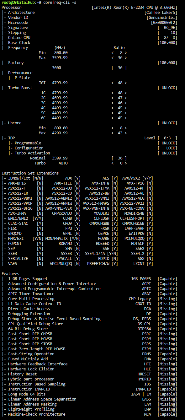

On 8/14/2023 at 6:13 AM, CyrIng said:
Press key p to open the "Processor" window and scroll down to bottom.
You can also export the same using option:
corefreq-cli -s
Then post the output as code in reply.
Turbo boost is a multifactorial feature:
* IDA available
* Speed Step Enable
* C-States activated
* Idle loop using mwait or I/O-wait operating by kernel
* Boosted frequencies well programmed in descending orders from single to all (ie 8 simultaneous) core(s)
* Target Frequency P-state equal BCLK (Max Ratio) plus at least one bin
+ TDP > Turbo Activation : preferably set to Auto (aka value zero)
* No other limitation such as ODCM or Energy Policy Bias Hint or misc PL (Power Limiters)
A competitive feature is HWP which follows rules of desired Frequency requests.
HWP has a programmable Target and Max ratios you'll set in the Processor window.
An Energy EPP scaler in window shortkey `o`
Remarks:
* Prerequisite is to activate HWP.
Press `z` key to enable or check its current state
* HWP can only be disabled by reboot.
* BIOS is also managing HWP
* Kernel is also attempting to activate HWP
You have to check by which Engine is governed your CPU.
HWP or Turbo Boost ?
FYI the closest CFL Xeon I had logged is this E-2246G

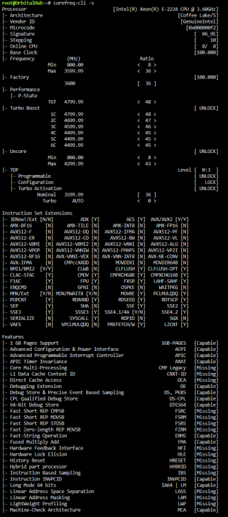

    I didnt realize I had to start the plugin, it must have been autostart before.  I got it working, thank you!

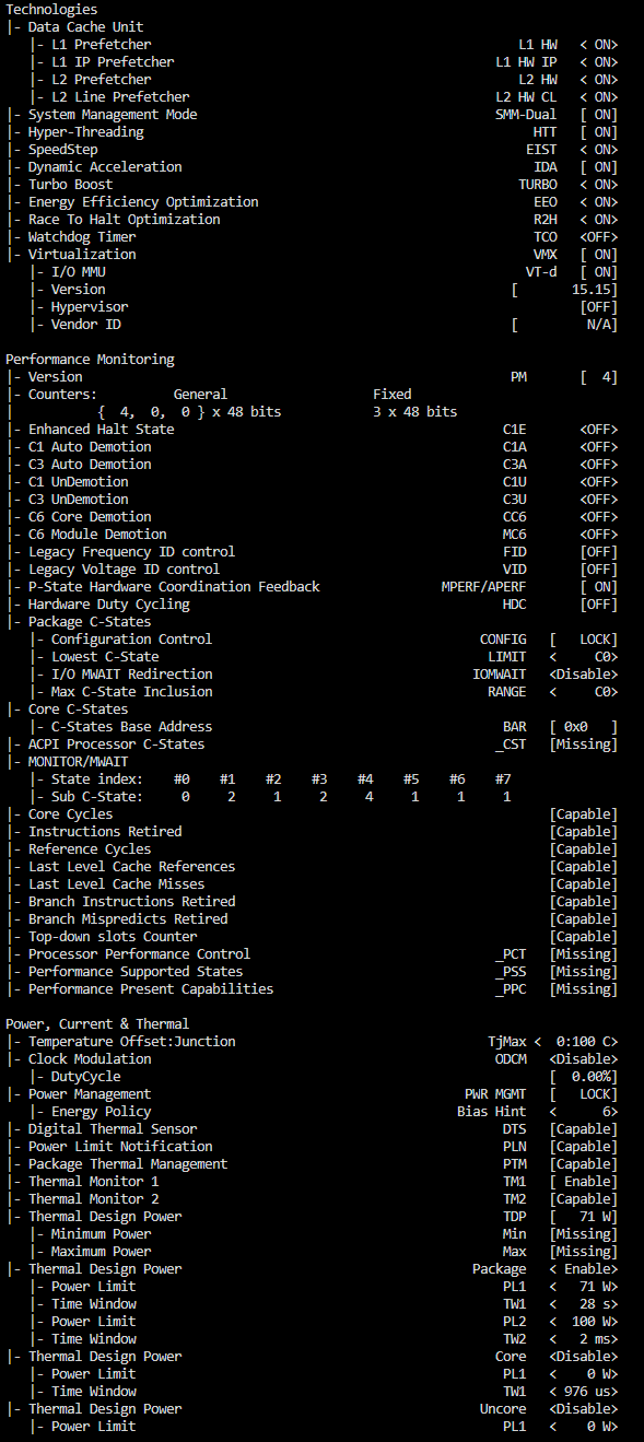

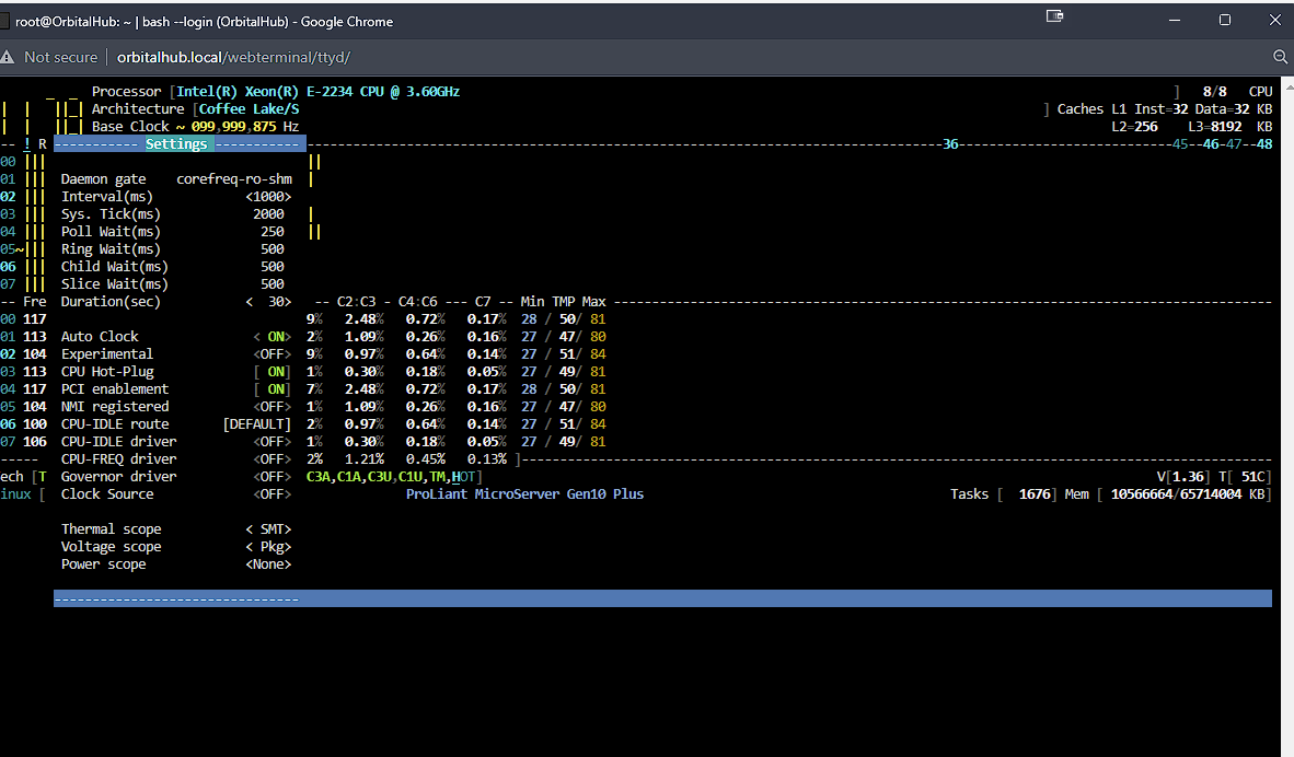

Hello,
I think I'm too stupid!
I can't manage to set the whole thing via corefreqk.conf so that the settings are already loaded at boot time.
Here is an example:
options corefreqk TurboBoost_Enable=1 SpeedStep_Enable=1 Register_CPU_Idle=1 Register_Governor=1 Register_ClockSource=1
Now comes the problem, I can't find all the options I want to set. For example, "NMI registered". In the Gui I can set it to "on". Which parameter should I enter in corefreqk.conf for this? According to the parameter list, there is only one "NMI_Disable". Should I enter this and set it to =0?
Sorry if I'm being too stupid!
I have attached scrennshots of my settings below.
Maybe someone can help me to enter the correct values.
Thanks in advance!
Greetings Bernd

Works only partially:
AutoClock is still set to "off" even if I enter "autoClock=1". Should I try another value (2) here?
In "Kernel Data", "C3" is still entered for "Idle Limit". How can I set the value directly to "C6" at start-up? It works via the Gui.
Under "Window->Processor", the value "3" is still entered for TGT under CPPC. Even if I set this manually from "1", the value then changes again automatically at some point. Sometimes to "3", sometimes to "6".... The value indicates the lowest frequency that the processor should reach, or am I misunderstanding this?
Everything else worked!
Here is the content of my corefreqk.conf again:
options corefreqk TurboBoost_Enable=1 SpeedStep_Enable=1 Register_CPU_Idle=1 Register_Governor=1 Register_ClockSource=1 PkgCStateLimit=6 NMI_Disable=0 AutoClock=1 HWP_Enable=1 Ratio_HWP=-1,-1,47
`AutoClock=2` is the default. You can force use it.
0: Pure specs BCLK
1: Estimate BCLK once during driver startup
2: Estimate BCLK at every monitoring loop
Remark:
Parameter case matters in CoreFreq.
I did it on a purpose because I don't want Users to mess up with hardware without understanding the parameter meaning
Thus, spelling is `AutoClock`
That's not programmed for Ryzen yet.
It's on the to-do list.
Please follow the development branch for early testings.
Because your Processor is managed by the kernel module `amd-pstate`
If you want CoreFreq to fully control CPPC, you have to prevent `amd-pstate` from being auto-load by Kernel.
Please see the instructions to blacklist any "CPU-Freq driver"
Syntax looks OK to me

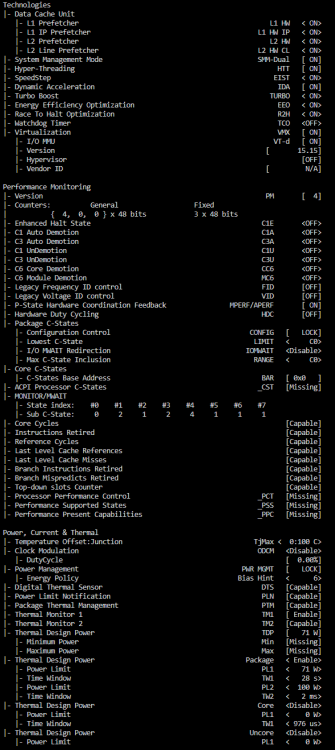

On 8/25/2023 at 3:21 PM, CyrIng said:
Which UI settings you don't get or find as driver parameters ?
Sorry things happened IRL and now i'm back to this.

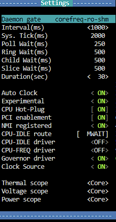

How can I keep core 0/1/2/3 turned on turbo all the time? that script thing didn't work.
How could I keep these settings saved also?
These are the defaults:
Unfortunately no such feature to keep Turbo stressing triggered right at CoreFreq startup.
CPU stressing functions are activated manually from the UI.
Those functions have been created to verify the processor operating limits like max frequency, max temperature, max voltage, max watts and so on.
Package cpu-burn might be what you need.
According to your screenshot, the parameters are `ThermalScope`, `VoltageScope` and `PowerScope`
For these 3 parameters, values are `0:None; 1:SMT; 2:Core; 3:Package`
For the others, see my above advices answered to @Bernd Matthießen

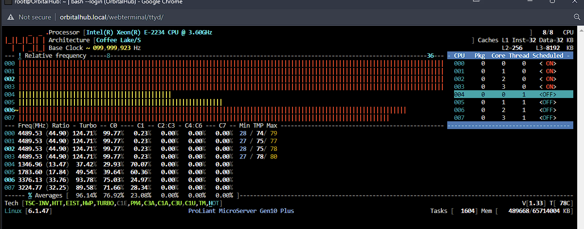

Is there a way I can use this to disable that core?
Yes you can. From the UI "Settings" (F2) menu, go to "HotPlug CPU" then select/scroll to the CPU number to toggle its state from Enable to Disable
  • 4 weeks later...
Thanks it seemed to fix itself. think it was a ram issue.

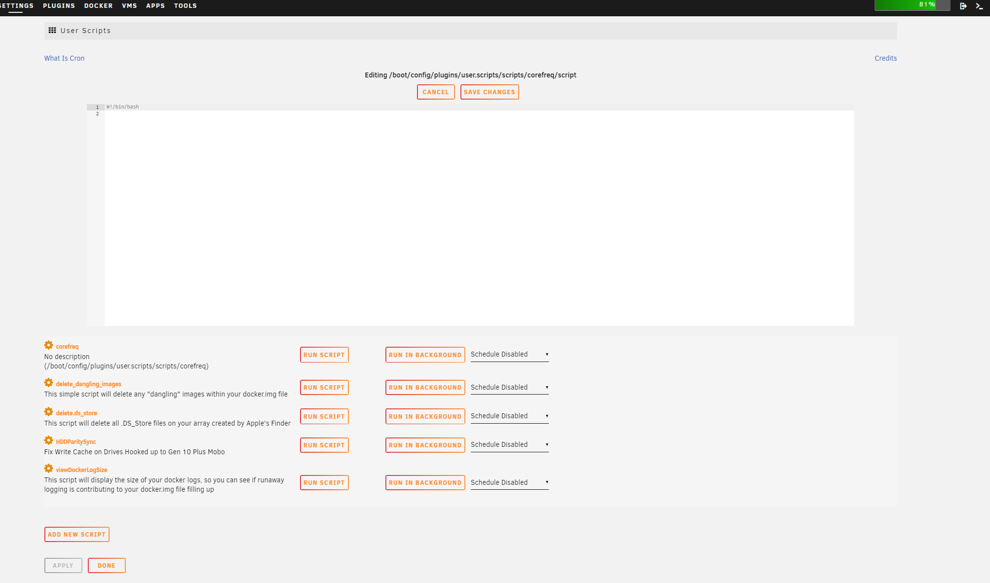

What's the way to enable turbo boost on all cores on startup?
I have been using > options corefreqk TurboBoost_Enable=1 0:None; 1:SMT; 2:Core; 3:Package
in modprobe.c corefreq.conf
Can it be added as a 'userscript' here?
Thanks again.
Only if this can be done through bash but I think that @CyrIng meant you have to do it in CoreFreq itself.

It should be yeah but mine never was. Anyway I realized I renamed the .cfg file to disable it at one point all I had do was rename it. doh.

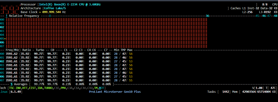

I have that in it.
That means my CPU is running that fast right? And my temps are those? Because that seems pretty good. I've had it like that an hour and been watching plex and things on it. Should I leave it like that?
This is wrong, you jsut need:
The values after that is the explanation what 0, 1, 2 & 3 do.
