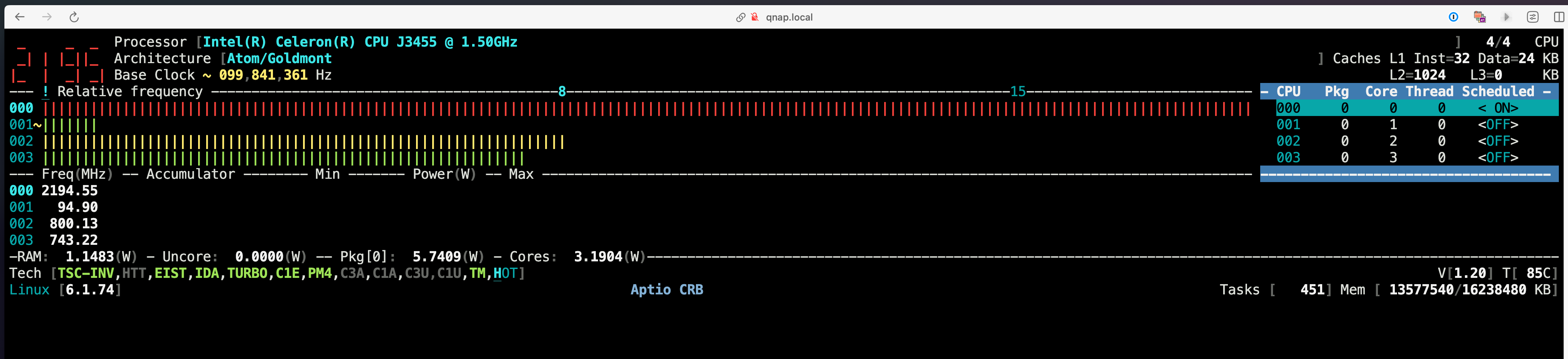

With Goldmont I'm facing Power units unseen before

@ich777 Hello,
At your disposal, I have committed in `develop` branch a tiny change to the Goldmont Power formula.
May you please prepare a plugin for a @KaitsuN6 test.
Ok, done.

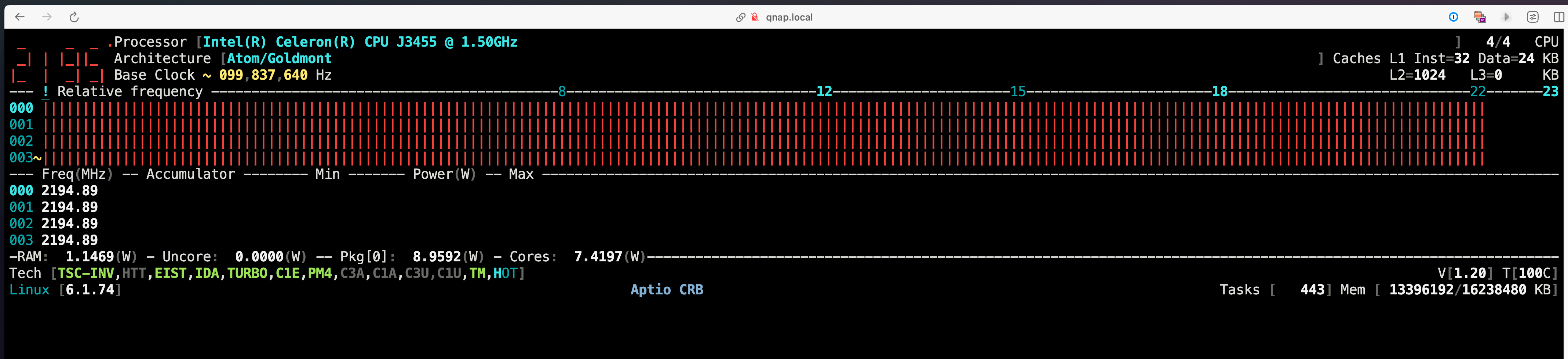

Here's the Voltage SMT
Voltage Core
Power
By the way, having trouble to stop the stress test individual CPU...
I'll be out for a couple of hours...
Edited by KaitsuN6
@KaitsuN6Power now appears more "realistic"
Using my Conic stress functions which are pushing on FPU, you should read the max wattage.
To stop my stress tools, press a few times the F10 key
Edit: as a bonus, you are getting the DRAM watt
Edited by CyrIng

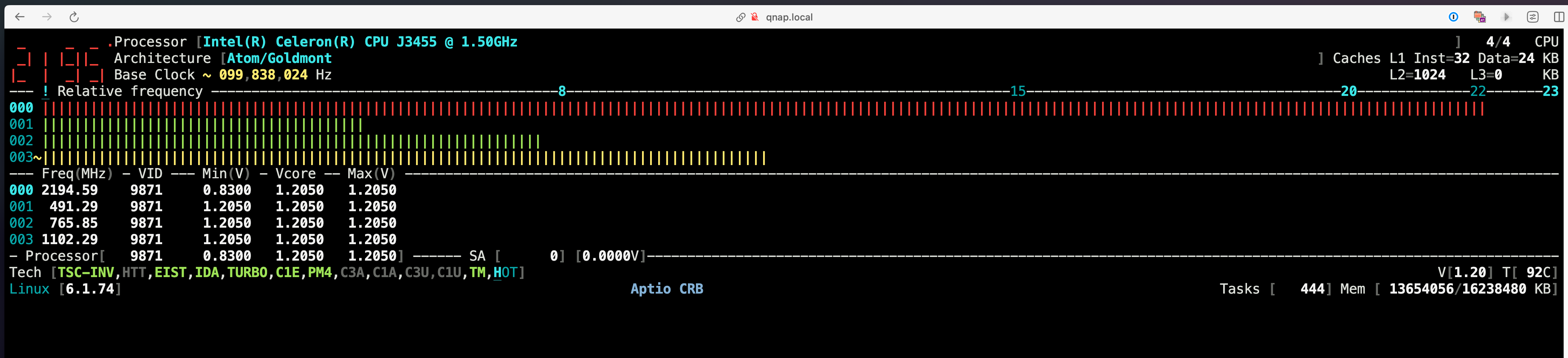

Hi, Conic Ellipsoid test:
8.96W we are not far from the computed TDP
TDP[   10 W]
Edited by CyrIng

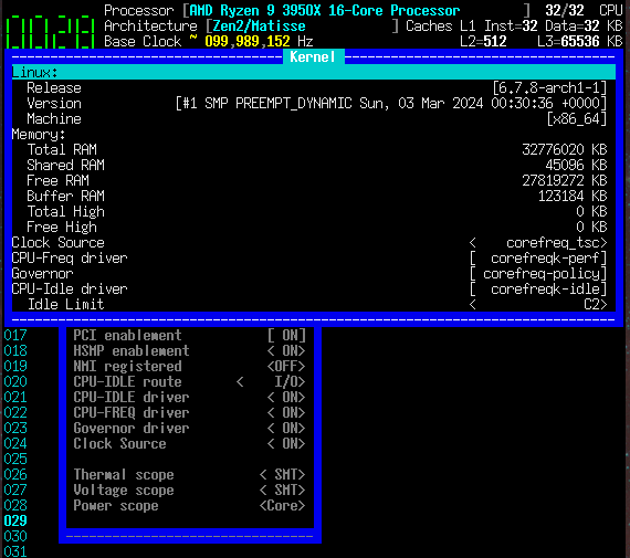

Trying to get the CPU-FREQ driver and CPU-IDLE driver to enable for my Ryzen 5 3600 to get C6 states working with corefreq-cli but when I try I get "File exists" and "Device or resource busy" respectively. CPPC shows as blue in the tech section. I have PM L1 SS = L1.1, Global C-state Control = Enabled, CPPC CTRL = Enabled and amd_pstate=passive in my Syslinux (no other options).
My lsmod is

and my current CoreFreq is
Processor                                    [AMD Ryzen 5 3600 6-Core Processor]
|- Architecture                                                   [Zen2/Matisse]
|- Vendor ID                                                      [AuthenticAMD]
|- Firmware                                                         [ 46.67.0-2]
|- Microcode                                                        [0x08701021]
|- Signature                                                           [  8F_71]
|- Stepping                                                            [      0]
|- Online CPU                                                          [ 12/ 12]
|- Base Clock                                                          [ 99.998]
|- Frequency            (MHz)                      Ratio
                 Min   2199.97                    <  22 >
                 Max   3599.94                    <  36 >
|- Factory                                                             [100.000]
                       3600                       [  36 ]
|- Performance
   |- P-State
                 TGT   3599.94                    <  36 >
   |- CPPC
                 Min    499.99                    <   5 >
                 Max   4199.93                    <  42 >
                 TGT    699.99                    <   7 >
|- Turbo Boost                                                         [ UNLOCK]
                 XFR   4199.93                    [  42 ]
                 CPB   4199.93                    [  42 ]
                  1C   2799.96                    <  28 >
                  2C   2199.97                    <  22 >
|- Uncore                                                              [   LOCK]
                 CLK   1299.98                    [  13 ]
                 MEM   3999.94                    [  40 ]
Instruction Set Extensions
|- 3DNow!/Ext [N/N]          ADX [Y]          AES [Y]  AVX/AVX2 [Y/Y]
|- AVX512-F     [N]    AVX512-DQ [N]  AVX512-IFMA [N]   AVX512-PF [N]
|- AVX512-ER    [N]    AVX512-CD [N]    AVX512-BW [N]   AVX512-VL [N]
|- AVX512-VBMI  [N] AVX512-VBMI2 [N]  AVX512-VNNI [N]  AVX512-ALG [N]
|- AVX512-VPOP  [N] AVX512-VNNIW [N] AVX512-FMAPS [N] AVX512-VP2I [N]
|- AVX512-BF16  [N] AVX-VNNI-VEX [N]    AVX-FP128 [N]   AVX-FP256 [Y]
|- BMI1/BMI2  [Y/Y]         CLWB [Y]      CLFLUSH [Y] CLFLUSH-OPT [Y]
|- CLAC-STAC    [Y]         CMOV [Y]    CMPXCHG8B [Y]  CMPXCHG16B [Y]
|- F16C         [Y]          FPU [Y]         FXSR [Y]   LAHF-SAHF [Y]
|- MMX/Ext    [Y/Y] MON/MWAITX [Y/Y]        MOVBE [Y]   PCLMULQDQ [Y]
|- POPCNT       [Y]       RDRAND [Y]       RDSEED [Y]      RDTSCP [Y]

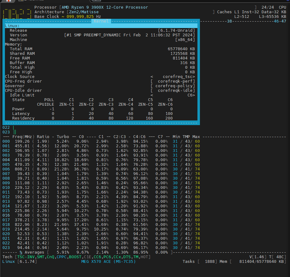

@Aubury
CPU-Freq driver                                               [      amd-pstate]
Governor                                                      [    conservative]
CPU-Idle driver                                               [       acpi_idle]
You can see here that mainline drivers are already occupying the position
You have first to unload `acpi_idle` and `amd-pstate`
With you Unraid setup, you can try:
modprobe -r acpi_idle
modprobe -r amd-pstate
But I doubt kernel will allow to unload once they have already been registered.
In that case you have to blacklist them when booting Linux by adding these parameters in the boot command line (See grub; syslinux; systemd-boot)
modprobe.blacklist=acpi_cpufreq amd_pstate.shared_mem=0 amd_pstate=disable idle=halt
When starting CoreFreq, you should then read `Missing` like my screenshot
Thus you are free to register CoreFreq in that order:
  1. Clock Source (optionally)
  2. Governor
  3. CPU-Idle driver
  4. CPU-Freq driver
If successful, you will get this second screenshot
Edited by CyrIng

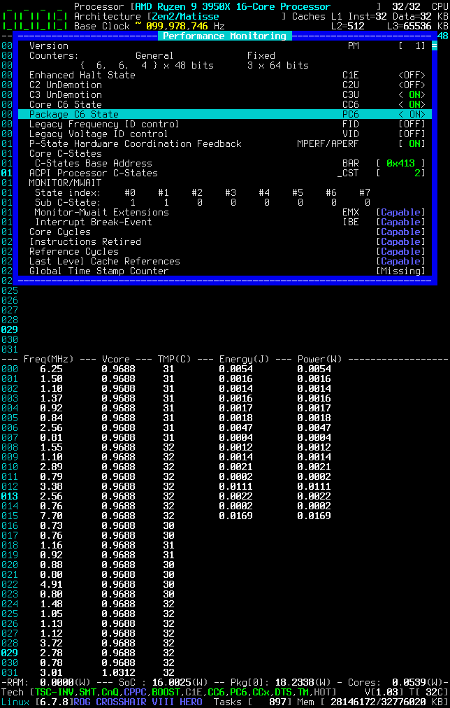

Is this basically the only way to get lower C-states with Ryzen? I'm already using amd_pstate=passive, clocks already going down to 500mhz. By using this corefreq is essentially taking over control? I'd like to lower my idle usage as with HDDs turned off and amd-pstate I'm getting around 50-54w idle. Not sure if this could help bring it down a notch?
Check BIOS if CC6 and PC6 are enabled
Next Kernel should idle with an assembly instruction like `I/O-Wait` or `halt`
(  `M-WAIT` being less efficient with Ryzen than Intel C-States )
This what you should get as a default, even using `amd_pstate`
Here's the 3950X power consumption
Edited by CyrIng
English
Thank you for the prompt response! I'm usually a tinkerer and finding out what I "could" instead of "should" be doing.

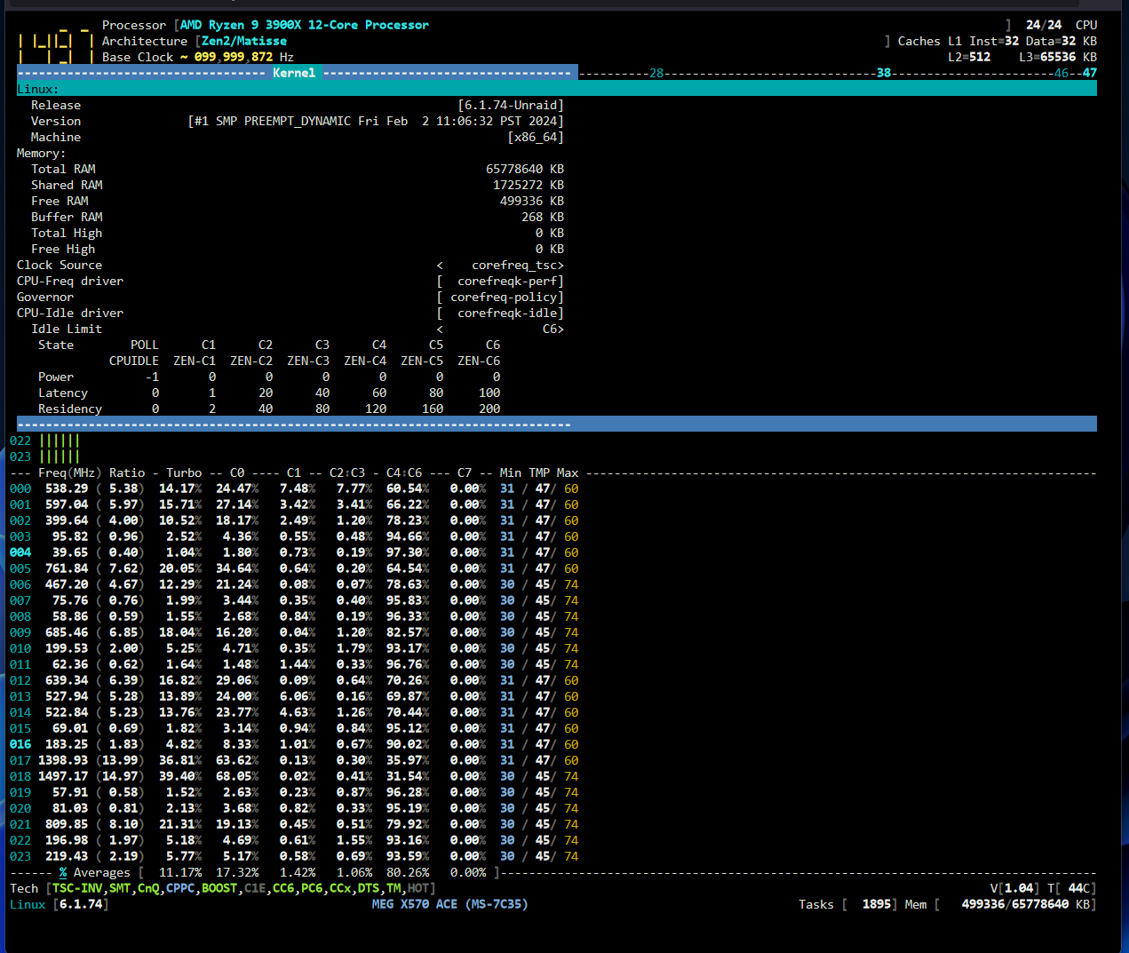

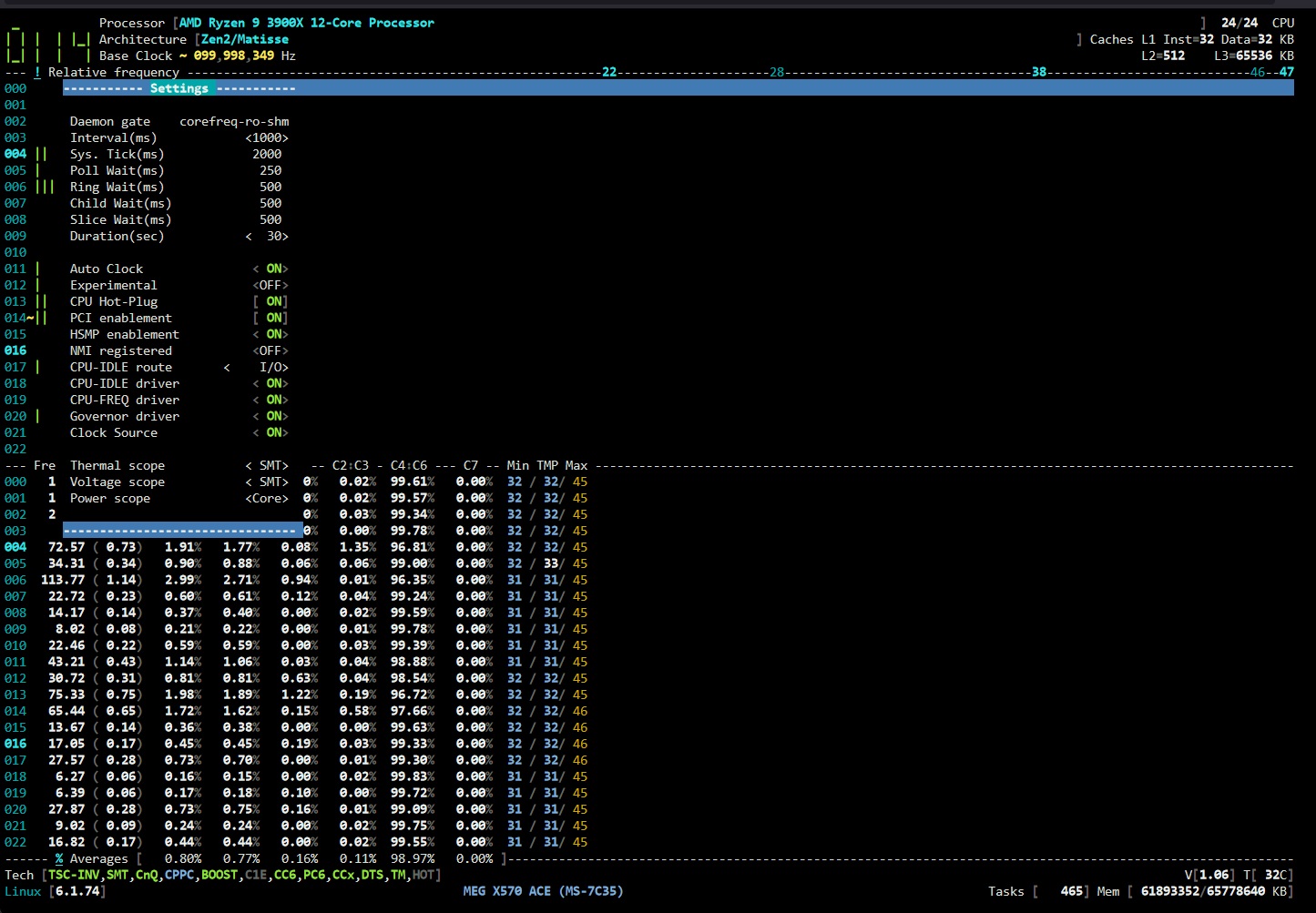

Thanks! That seemed to work and let me unlock C2 idle states. Is there anything I need to do to make the settings persist across reboots? I had to reregister CoreFreq after I rebooted and change the idle limit to C6 again.
Short answer is you need these module parameters:
Register_ClockSource=1 Register_Governor=1 Register_CPU_Idle=1 Register_CPU_Freq=1
Apply the Linux standards to add them as an `options` line into `/etc/modprobe.conf` or `/etc/modprobe.d/modprobe.conf`
Somehow, you will also switch the System to CoreFreq Clock Source: this can be achieved in system `profile` or `init` file
echo "corefreq_tsc" > /sys/devices/system/clocksource/clocksource0/current_clocksource
Fyi, you can get all possible parameters using command:
modinfo corefreqk.ko

I now have everything registered properly per your instructions to include the blacklist:
My power consumption:
Was 175-180W with most HDDs spun down. 220-230W with them spun up.
Now 110-120W with most HDDs spun down. 170W with them all spun up.
No delays, no errors.
Edited by wuudogg
wrong pic
10 hours ago, wuudogg said:
Now 110-120W
That's such an improvement.
How did you measure the whole power consumed ?
@wuudogg
There's an odd issue with the UI I'm noticing in your previous screenshot: the borders of the Settings window are missing on the sides and get width extended on the above.
I can't tell yet if it is a `corefreq-cli` bug or some side effects of the employed screenshot software (SW) tool ?
Are those issues visibly permanent on your screen ?
By which mean are you displaying the UI ?
ssh or other remote SW ?
X or console Terminal SW ?
Is the term color theme modified or default ?
Edited by CyrIng

20 hours ago, CyrIng said:
@wuudogg
Interesting. Those were taking from a host RDP'd into a VM. Was thinking maybe PEBKAC on my part.
So, I've attached another with the Kernal window this time. Straight from the Unraid GUI Window Terminal. Windows Snipping Tool. Tried it from Firefox and Chrome. I don't see those nice royal blue boxes like in your pic again.  I tried from a few different windows system thinking maybe it was a dark mode or a browser addon. Tried on a new / fresh system and no royal blue outline still. Even tried Microsoft Edge lol. No borders.
Running 6.12.8 and the plugin is installed and up to date.
Second pic, with the boxes/borders is through Mobaxterm window... Boxes are there.

About the UI glitches, I don't catch how to reproduce them.
My understanding is that Windows and Virtualization are the starting points of the issue.
To clarify, tested on Windows 11 Pro Hosts and VM Guests. Virtualization is not a requirement to reproduce.  Tried Firefox, Chrome and Edge. All give the same result of the borders missing when I use Unraid Gui and run corefreq-cli from the Unraid Gui Terminal window.  Doesn't happen if I use MobaXterm and ssh in.
