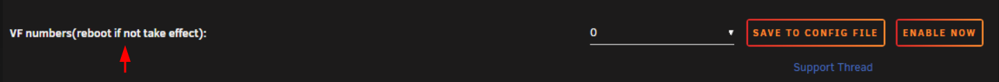

  4. Go to settings on sr-iov plugin. Set VF Numbers to “2”. Click save to config file Reboot. You need to reboot. check IOMMU after reboot. The VFs will be further down the page if all working well. *Make sure you only pass through the VF, not the physical card. More details over here:

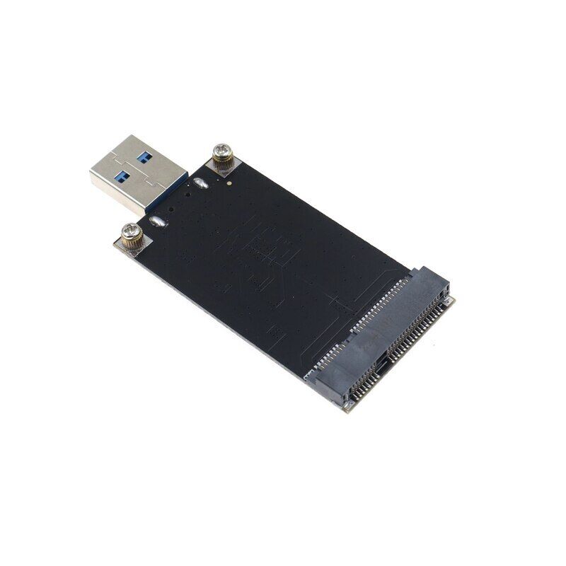

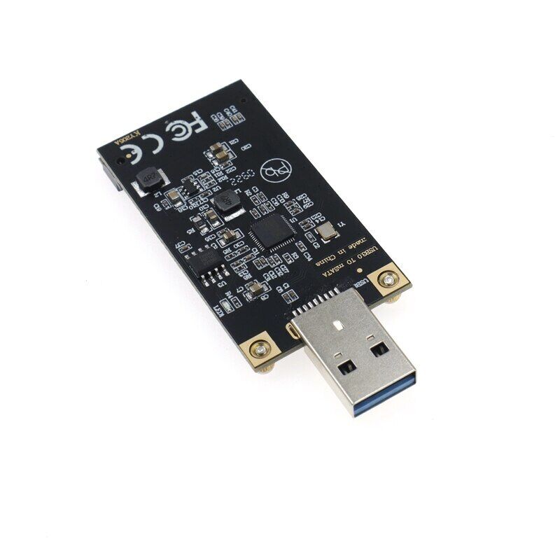

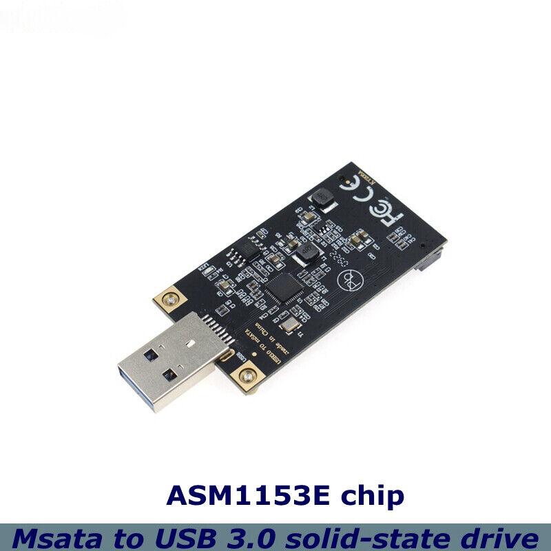

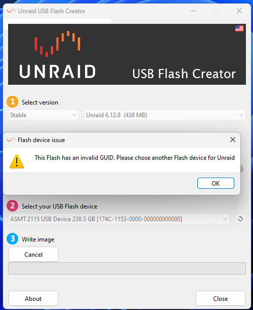

  14. This is really great. Was looking for a way to keep certain *arrs from running wild and downloading too many very high quality linux ISO downloads daily. Was trying to do this in sabnzbd as it isn't native in most of the *arr apps. This might be the ticket. Thanks
