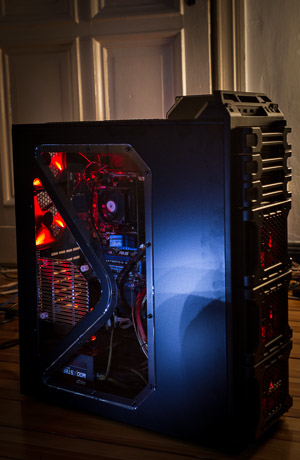

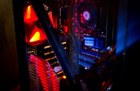

  10. Shawn, you're right, I think. The top 3 5.25" are hard to fill, it seems, so the most I could put in there would be a 3-in-2, as far as I can see. That would make it 9 internal + 3 in that 5.25 space, which means 12 total, which isn't that much considering the size of the thing. No matter, I kinda like the brash looks, and I moved my build into it. It's a high-airflow case, and even during a parity check, it almost runs too cool (low 30's). It sure looks the business, what with the red fans and all. I'll post photos in the coming days. FWIW, I also just built a Hackintosh in a Corsair Obsidian 650D case - now that's a great case, in my book. Not sure how good it would be as an unRaid server, but for a "normal" PC, it's pretty awesome. I've made a little clip, which is more about the innards and all, but still, maybe it'll give you an impression (youtube link) Sorry I'm a bit late to respond to this, I've been under the weather the past week, but I'm on the mend now. So it sounds like you went ahead and moved your server into the Antec case. How do you like it? Hey Rajahal, hope you're feeling better! I quite like the case, the hard drives just slide in, which is nice - no mounting in brackets or anything - easy. For the size, i could probably offer more drive slots, and since I'm not sure yet if I can fit a 5-in-3, that question is still open. I'll post pix & clips and a short report in my fave thread of all soon - unRaid Compulsive Design

  12. Shawn, you're right, I think. The top 3 5.25" are hard to fill, it seems, so the most I could put in there would be a 3-in-2, as far as I can see. That would make it 9 internal + 3 in that 5.25 space, which means 12 total, which isn't that much considering the size of the thing. No matter, I kinda like the brash looks, and I moved my build into it. It's a high-airflow case, and even during a parity check, it almost runs too cool (low 30's). It sure looks the business, what with the red fans and all. I'll post photos in the coming days. FWIW, I also just built a Hackintosh in a Corsair Obsidian 650D case - now that's a great case, in my book. Not sure how good it would be as an unRaid server, but for a "normal" PC, it's pretty awesome. I've made a little clip, which is more about the innards and all, but still, maybe it'll give you an impression (youtube link)
  13. Rajahal, man of all things tinkery...I have a(nother) question for you. I have my unRAID server in a Fractal Design R2, and I've very happy with it. However, I almost think it's a little too...quiet, in terms of visuals. I wouldn't mind something more machin-ey...well ok, especially with this case I'm presenting, the taste of which is definitely debatable - but so be it. I'm just wondering, from a building point of view, how many drives do you think I could fit in this thing, the Antec Dark Fleet DF-85 http://store.antec.com/Product/darkFleet/df-85/0-761345-15238-9.aspx? I was able to score one at half price, and seized the opportunity, and I am now considering moving all my stuff into that one. It is bigger than my Fractal Design - and it has blinking lights 'n stuff. I'd probably turn some of the fans off, I doubt I'll need that much cooling...but do you think I could add a 5-in-3 or something to it? What do you reckon might be the max number of HD's in it? Thanks for your kind words of advice in advance...
  14. That's not a case, that's a sculpture, reminiscent of Riva boats...amazing! oh, to be a millionaire...
