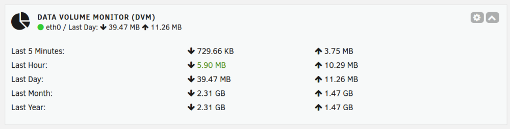

March 18, 20242 yr Data Volume Monitor (DVM) for UNRAID "A plugin that lets you monitor and act on your consumed data volume utilizing vnStat." With much pride I'd like to present my latest project - the Data Volume Monitor (DVM). Dashboards, footer information, notifications, user actions (on VMs/Docker containers) and custom scripting. These are a few of the features being offered - all centred around the data volume consumption of your server. Don't want to your Syncthing container to pull in more than 50 GB a day? No problem, DVM will stop and restart the container for you within those limits. Running a few data intensive VMs and want to pull the plug when it's been too much? No problem, DVM will disconnect and reconnect specific VMs from/to the network. Want to move around some files and folders when you've pulled in too much data? No problem, set up a custom script and DVM will execute it for you when it's time. Please report back if you are experiencing any problems! This plugin was developed with older machines in mind - it's been tested on 6.8.3 and above. Edited March 18, 20242 yr by Rysz

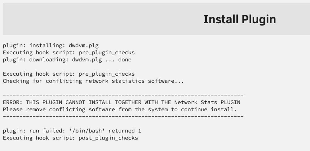

March 22, 20242 yr Just a note... Make sure to uninstall network stats plugin before installing this one. I had it installed and tried installing it. It didn't show any warnings or errors just blank installation window.
March 22, 20242 yr Author 35 minutes ago, shadowd1000 said: Just a note... Make sure to uninstall network stats plugin before installing this one. I had it installed and tried installing it. It didn't show any warnings or errors just blank installation window. Weird, it should show an error that it's not compatible in the installation window: Edited March 22, 20242 yr by Rysz

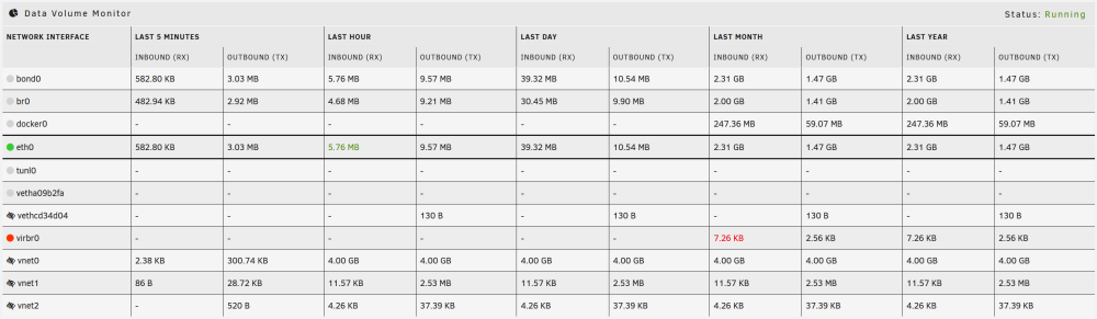

June 23, 20242 yr Author 1 hour ago, Kaizac said: I'm only seeing the specific docker containers when they are running on the Unraid host IP. Using a dedicated IP from a VLAN does not seem to show the separate container traffic. Is that as expected? I'm not sure I understand your setup, how do you set up dedicated IPs from VLANs for your Dockers? And do you still see the veth interfaces (just not matched to any Docker container names) or nothing at all? Can you provide a screenshot of your interfaces table (inside Data Volume Monitor), if possible?

August 15, 20242 yr Is it possible to have the dashboard show multiple/all of the interfaces that have been set/made active. ? I have multiple interfaces setup across a number of containers and vms which are tied to various vlans on the network. The user intact shows all the interfaces and breaks down the data stats for each one but I'm not sure how (if possible) to create threshold rules for each interface to send notifications on a per interface basis. Is this possible ? Edited August 15, 20242 yr by JNZ added further context

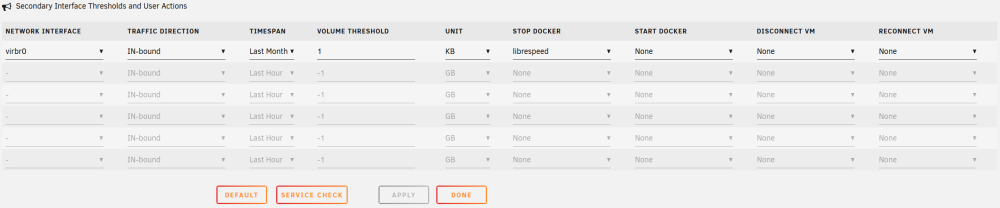

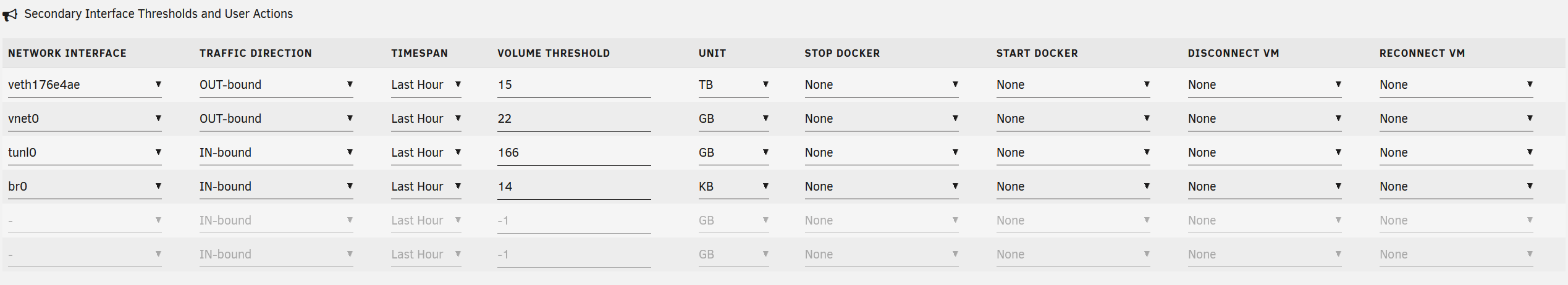

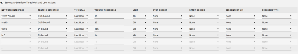

August 16, 20242 yr Author 22 hours ago, JNZ said: Is it possible to have the dashboard show multiple/all of the interfaces that have been set/made active. ? I have multiple interfaces setup across a number of containers and vms which are tied to various vlans on the network. The user intact shows all the interfaces and breaks down the data stats for each one but I'm not sure how (if possible) to create threshold rules for each interface to send notifications on a per interface basis. Is this possible ? The front-page dashboard and footer only shows the primary network interface at the moment. But you can already set limits and notifications for up to 6 other network interfaces in this section of DVM settings (see example): In this case you will get notifications for each defined interface when the respective limit is exceeded/returned to normal. Be aware these settings also control receiving notifications or executing user actions on the defined "secondary interfaces":
