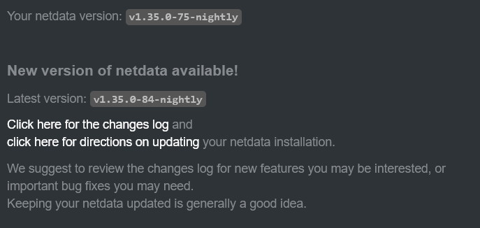

  5. Yeah, I installed it yesterday and yet even though I can see docker containers, I'm still not able to see their network activity. For some reason only cpu, ram and hdd usage is available but not network. I installed netdata from appstore which is using host network instead of bridge. Also, I can see some vnet adapters in network section.
  6. Any solution?
