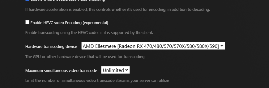

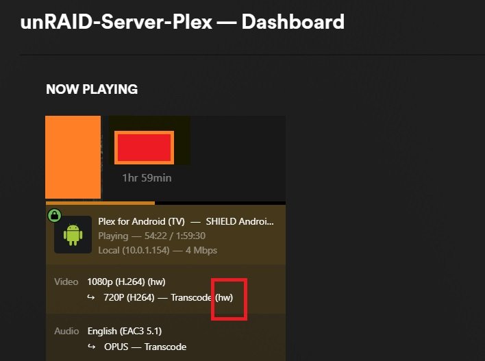

November 18, 20233 yr This is a quick post to try and help those newer to unraid like me to setup a Plex container and enable hardware transcoding using a modern AMD Radeon iGPU often found in mini PC's. I'm setting up a low power home lab to learn and get some utility out of unRAID. I was doing my initial setup and walking through the steps to get HW TC to work. Key steps below:Install Plug in Radeon TOP(Optional, but suggested) Install Plugin, GPU StatisticsInstall App, Plex-Media-Server (official from Plex) - this is only version that natively supports HW TC without other extra parameters and craziness I'm aware of. Ensure the repository is: plexinc/pms-docker:plexpass - I believe that Plex HW TC support is only available in the Plex Pass build, which I have a lifetime membership so I think the Plex server claim step ties back to that possiblyGo to bottom of page and select '+ Add another Path, Port, Variable, Label or Device', Select 'Device'Enter in Name field: AMD GPUEnter in Value field: /dev/dri:/dev/dri(*** this may be a typo, try just /dev/dri if you have any issue)Save, Done when completeGo to Plex UI, Server settings > General and Check for updates and make sure you have the latest, then make sure under Server Update Channel, Beta is selected, save ensuring you're up to date fully and have Beta selectedI tend to like cycling Docker altogether when I make major changes to ensure the instances all reflect them so I go to Settings, Docker and set Enable Docker to No, Apply...wait for things to cycle down, then change back to Yes, Apply, DoneGo to settings in your Plex server UI then Transcoder then go to "Hardware transcoding device" and then select your specific gpu. Key Step to verify: Go to Plex and start a movie, then force a transcode by changing the playback settings to a different value. Then in Plex UI go to dashboard, now playing, expose details and you will know HW TC is working by seeing '(hw)' at end of the transcode line. At this point, I think those with modern AMD Ryzen iGPUs with have hardware transcoding enabled in an unRAID Plex docker container! For reference my setup is: unRAID 6.12.4, AMD Ryzen 7 5800H based mini pc with Radeon (Vega 8 based) GPU. Hope this helps others. Edited September 25, 20251 yr by RichB Added advice on a possible typo for a parameter
November 23, 20233 yr On 11/18/2023 at 7:15 PM, RichB said: This is a quick post to try and help those newer to unraid like me to setup a Plex container and enable hardware transcoding using a modern AMD Radeon iGPU often found in mini PC's. I'm setting up a low power home lab to learn and get some utility out of unRAID. I was doing my initial setup and walking through the steps to get HW TC to work. Key steps below: Install Plug in Radeon TOP (Optional, but suggested) Install Plugin, GPU Statistics Install App, Plex-Media-Server (official from Plex) - this is only version that natively supports HW TC without other extra parameters and craziness I'm aware of. Ensure the repository is: plexinc/pms-docker:plexpass - I believe that Plex HW TC support is only available in the Plex Pass build, which I have a lifetime membership so I think the Plex server claim step ties back to that possibly Go to bottom of page and select '+ Add another Path, Port, Variable, Label or Device' Enter in Name field: AMD GPU Enter in Value field: /dev/dri:/dev/dri Save, Done when complete Go to Plex UI, Server settings > General and Check for updates and make sure you have the latest, then make sure under Server Update Channel, Beta is selected, save ensuring you're up to date fully and have Beta selected I tend to like cycling Docker altogether when I make major changes to ensure the instances all reflect them so I go to Settings, Docker and set Enable Docker to No, Apply...wait for things to cycle down, then change back to Yes, Apply, Done Key Step to verify: Go to Plex and start a movie, then force a transcode by changing the playback settings to a different value. Then in Plex UI go to dashboard, now playing, expose details and you will know HW TC is working by seeing '(hw)' at end of the transcode line. At this point, I think those with modern AMD Ryzen iGPUs with have hardware transcoding enabled in an unRAID Plex docker container! For reference my setup is: unRAID 6.12.4, AMD Ryzen 7 5800H based mini pc with Radeon (Vega 8 based) GPU. Hope this helps others. Works great! Just a small addition: in Step 5 make sure to select Device from dropdown and enter the values as explained in steps 6 and 7. Also, go to settings in your Plex server UI then Transcoder then go to "Hardware transcoding device" and then select your specific gpu. I tested on AMD 4350G. Works well!
November 28, 20232 yr Author Follow up: TLDR - The Ryzen 7 5800H mini pc can run ~4 1080p HW TC's before choking(higher bit rate 1080p original down to 8gbps, not 4k tc). 10+ direct play streams. CPU was the constraint on the HW TC count, not GPU. If you really need to do many HW TC's, go with Intel gen 12+(with quicksync) and 16 to 32Gb RAM. You can get away with gen 8+ as well and may find better deals. Good luck. I was able to fire up a bunch of streams to test out performance informally. Browser was on same local network, chrome latest version. Navigated in each window to Plex UI, picked a movie that had a rate/quality higher than 1080p 8mbps, forced to 1080p, 8mbps. Was able to get up to 4 hardware transcodes going before trying to fire up the 5th failed. Did not see any perceptible buffering, but didn't run for that long. GPU got up to about 20-30% max, so it was CPU constrained I think. CPU was showing a bunch of red and orange with overall % at 70%+ and close to 100 at times. Another factor to CPU load was new unraid build was creating parity disk and seeing s lot of IOwait on cpu? I also have around 20 dockers running and 1 VM that was off at the time, so this mini pc can handle a lot. I also tried to open a bunch in direct play to see how many streams I could get. I got close to 10 1080p streams and had to get back to work. For me, this inexpensive $330 mini pc(w/32gb ram and 1Tb nvme (gen 3) was a great little home lab pc to try things out. PS: Don't tell the fanatics, but I got a usb 3 (gen 1) 8 bay Syba DAS enclosure and am running the full array from it with smart data working and no drops or errors so far. Fingers crossed. I had 2 4bay DAS enclosures, but the drive identification in the array slots was getting confused and think splitting across usb controllers was the issue. So far no problem with that. We shall see. Good luck all. Edited November 30, 20232 yr by RichB added detail

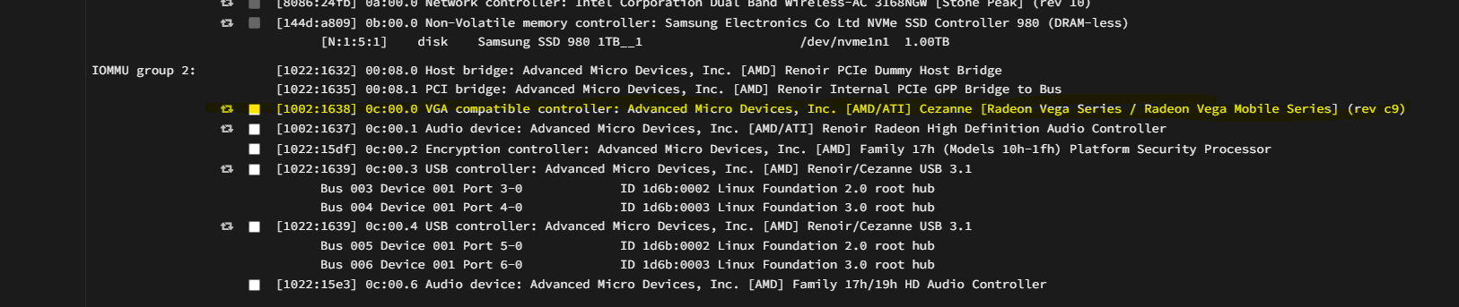

September 11, 20242 yr I've been trying to get this to work but not successful. I'm running a 5600G and when I edit the Plex docker to add the AMG GPU device I get this after saving it: docker: Error response from daemon: error gathering device information while adding custom device "/dev/dri": no such file or directory. Any ideas? Update: I fixed it - I had IOMMU enabled for the GPU, just needed to disable that. Edited September 11, 20242 yr by chaosclarity
September 21, 20242 yr On 9/11/2024 at 8:21 PM, chaosclarity said: I've been trying to get this to work but not successful. I'm running a 5600G and when I edit the Plex docker to add the AMG GPU device I get this after saving it: docker: Error response from daemon: error gathering device information while adding custom device "/dev/dri": no such file or directory. Any ideas? Update: I fixed it - I had IOMMU enabled for the GPU, just needed to disable that. i have the same issue as you. i installed the radeon-top plugin and also follow this steps. but unable to have access to /dev/dri when doing this cmd ls -la /dev/dri how do you disable the IOMMU for GPU? ``` First, I enabled the AMD drivers in Unraid like so: mkdir /boot/config/modprobe.d touch /boot/config/modprobe.d/amdgpu.conf Next, I added the following lines to the /boot/config/go file: modprobe amdgpu chmod -R 777 /dev/dri ```
September 21, 20242 yr 15 minutes ago, Alvin Leong said: i have the same issue as you. i installed the radeon-top plugin and also follow this steps. but unable to have access to /dev/dri when doing this cmd ls -la /dev/dri how do you disable the IOMMU for GPU? ``` First, I enabled the AMD drivers in Unraid like so: mkdir /boot/config/modprobe.d touch /boot/config/modprobe.d/amdgpu.conf Next, I added the following lines to the /boot/config/go file: modprobe amdgpu chmod -R 777 /dev/dri ``` You shouldn't need to add that last part in the boot config - I'd remove that. As far as IOMMU goes, you only need to disable that if you've ever enabled it. Go to Tools -> System Devices, UNCHECK the GPU if it's got a checkmark next to it. You will need to reboot for that to take effect.
September 21, 20242 yr weird thing is i was on Unraid 6.11.5 and it is not working with my AMD 8845hs igpu. but after i updated to latest unraid it work without me disable any IOMMU. I did not passthrough any of it. i guess i will try to remove the code in boot to see whether it still works Thanks for your reply

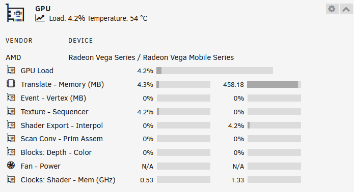

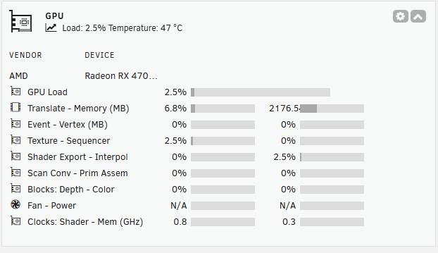

February 16, 20251 yr i can't make it work..... i do have plex pass and followed your instructions although i have linuxserver's plex docker i can mount the drivers and choose the GPU profile in Plex, but the gpu utilization isn't much. (max 4% for a second or so). any ideas? Edited February 17, 20251 yr by gotomato removed redundant screenshot
February 17, 20251 yr Ellesmere based GPUs are not great transcoding cards. Seeing only an occasional 1-2% GPU Load is not uncommon. Most of a GPU is not used during transcoding (just any dedicated transcoding hardware in the chip). Most of a GPU is for calculating what is to be drawn on the monitor attached to the GPU (as when playing games, etc), so is unused. Your screenshots show that it is hardware transcoding. Not sure why you have such a load on your CPU. Try some other media files, maybe without the need to audio transcode or that are using subtitles. Try to determine exactly what is causing the issue. Baby steps...
February 17, 20251 yr Author 35 minutes ago, gotomato said: i can't make it work..... i do have plex pass and followed your instructions although i have linuxserver's plex docker i can mount the drivers and choose the GPU profile in Plex, but the gpu utilization isn't much. (max 4% for a second or so). any ideas? Must be plex official docker

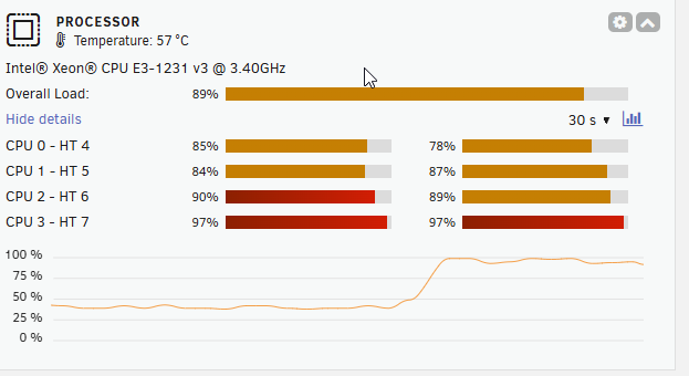

February 28, 20251 yr On 2/17/2025 at 1:00 AM, ConnerVT said: Ellesmere based GPUs are not great transcoding cards. Seeing only an occasional 1-2% GPU Load is not uncommon. Most of a GPU is not used during transcoding (just any dedicated transcoding hardware in the chip). Most of a GPU is for calculating what is to be drawn on the monitor attached to the GPU (as when playing games, etc), so is unused. Your screenshots show that it is hardware transcoding. Not sure why you have such a load on your CPU. Try some other media files, maybe without the need to audio transcode or that are using subtitles. Try to determine exactly what is causing the issue. Baby steps... Thx. i bought a cheap i5-4690 but there is no change in transcoding capabilities. i realised too late that quicksync != quicksync. i guess i simply need newer Hardware with a modern Media Engine.…. And more ram
February 28, 20251 yr Author 1 hour ago, gotomato said: Thx. i bought a cheap i5-4690 but there is no change in transcoding capabilities. i realised too late that quicksync != quicksync. i guess i simply need newer Hardware with a modern Media Engine.…. And more ram This thread is specifically for amd which does not have quicksync at all and leveraging GPU to hw transcode can be a benefit vs cpu transcode. Intel quicksync capability across their cpu generations is a completely different topic.
