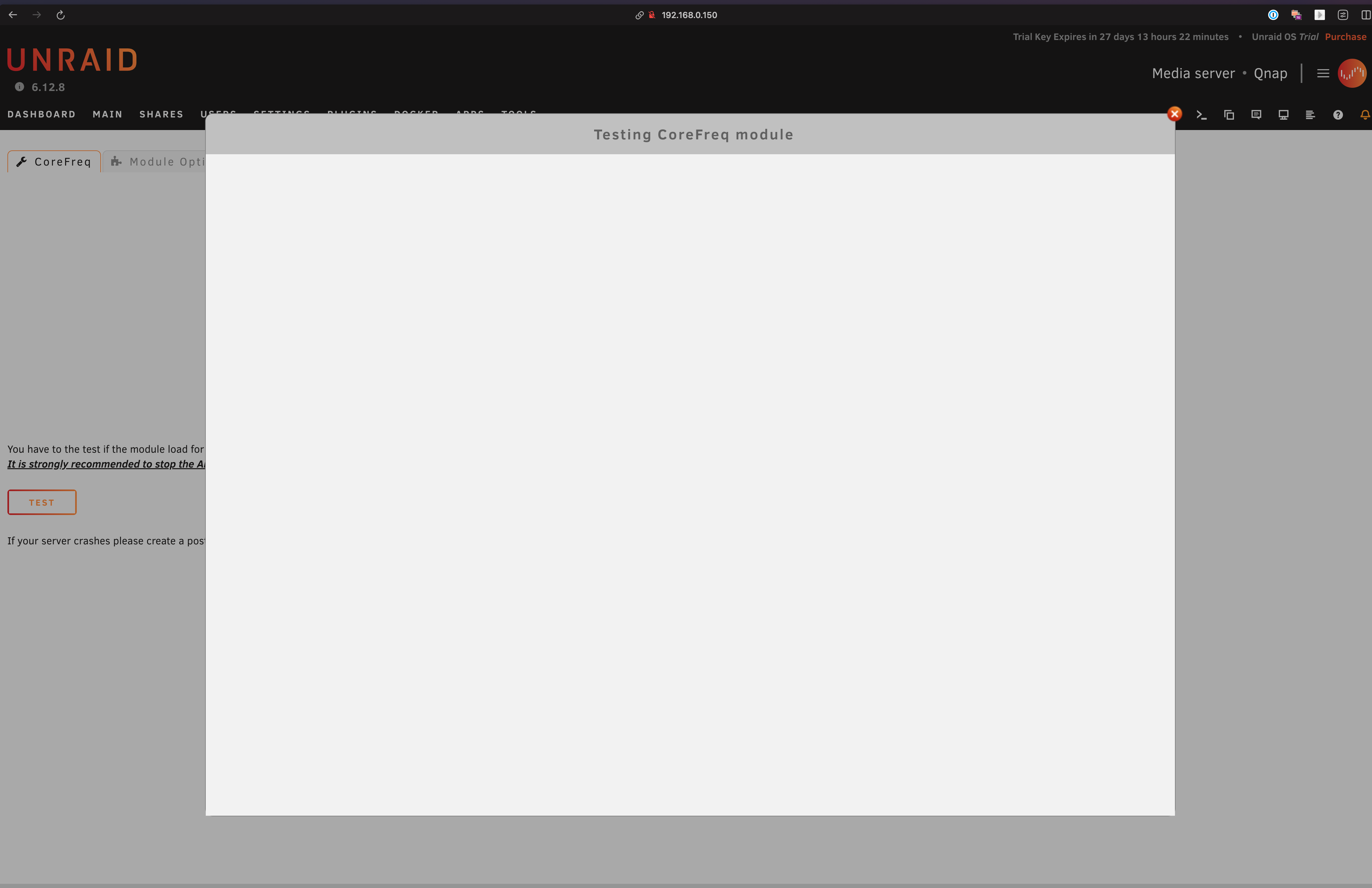

Sorry for a dumb question, but I'm trying to find where the instructions are to enable the module and not seeing them. I'm getting the daemon connection error but can't see where in the plugin description on CA or the description of the plugin on the plugins page in UnRAID it says where I need to enable a module or how to do so. Is it the "test" button within the plugin UI page?
Yes, you have to click test, if that went well you can enable the module on the plugin page. :)
Will do once my regularly-scheduled parity check is complete!  As a question, why is it suggested to spin down the array before pressing the button?
Because on some systems it caused a Kernel Panic when I created the plugin but that should not happen anymore and that's why it's recommended to stop the Array first (you can actually cancel the Parity check if you get a crash).
Nothing to worry about when the Array is Stopped. :)

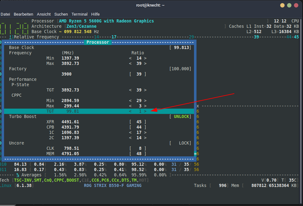

On 8/9/2022 at 11:54 AM, CyrIng said:
Indeed blue means capable, and green, enabled.
In your case CPPC is capable but not in function.
You can enable it in window "Performance Monitoring", item "Collaborative Processor Performance Control"
Remarks:
CPPC appears to be a firmware implementation, I can't tell what BIOS is going to do when enablement bit is set.

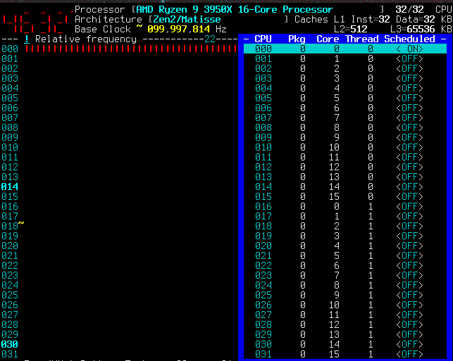

@CyrIng I can't get CPPC to be enabled even though I set it to "Enabled" in the BIOS of my ASRock B550 Taichi. Corefreq shows CPPC as capable (blue). I tried to activate it in Corefreq but it's not possible. I can't change anything in the "Performance Monitoring" window.
Is there any way for me to force it? I'm really trying hard to force my system to load the AMD_PSTATE driver, however, I think CPPC is the key to this first.
Edited by Hiko0

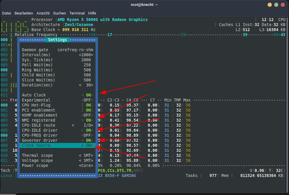

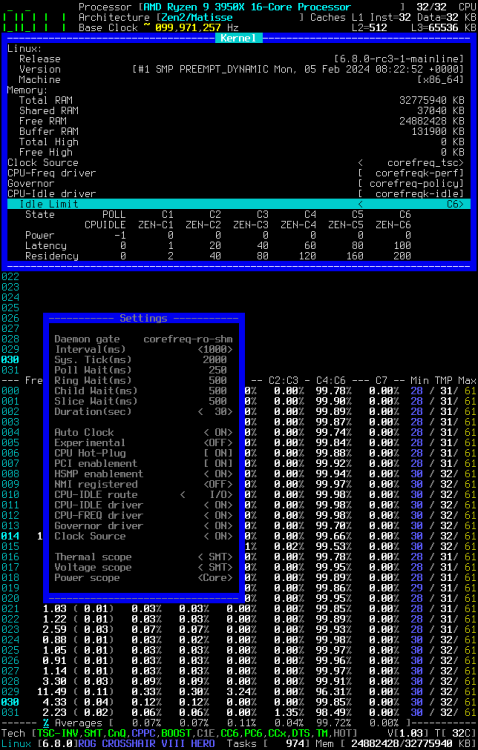

On 8/28/2023 at 3:04 PM, Bernd Matthießen said:
Hello,
I think I'm too stupid!
I can't manage to set the whole thing via corefreqk.conf so that the settings are already loaded at boot time.
Here is an example:
options corefreqk TurboBoost_Enable=1 SpeedStep_Enable=1 Register_CPU_Idle=1 Register_Governor=1 Register_ClockSource=1
Now comes the problem, I can't find all the options I want to set. For example, "NMI registered". In the Gui I can set it to "on". Which parameter should I enter in corefreqk.conf for this? According to the parameter list, there is only one "NMI_Disable". Should I enter this and set it to =0?
Sorry if I'm being too stupid!
I have attached scrennshots of my settings below.
Maybe someone can help me to enter the correct values.
Thanks in advance!
Greetings Bernd

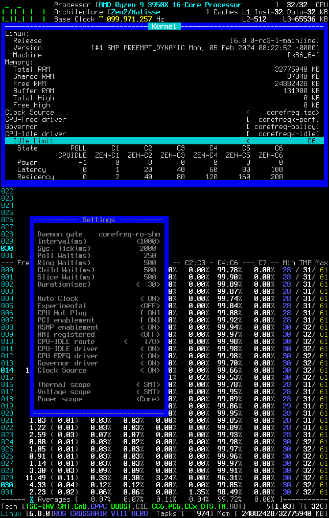

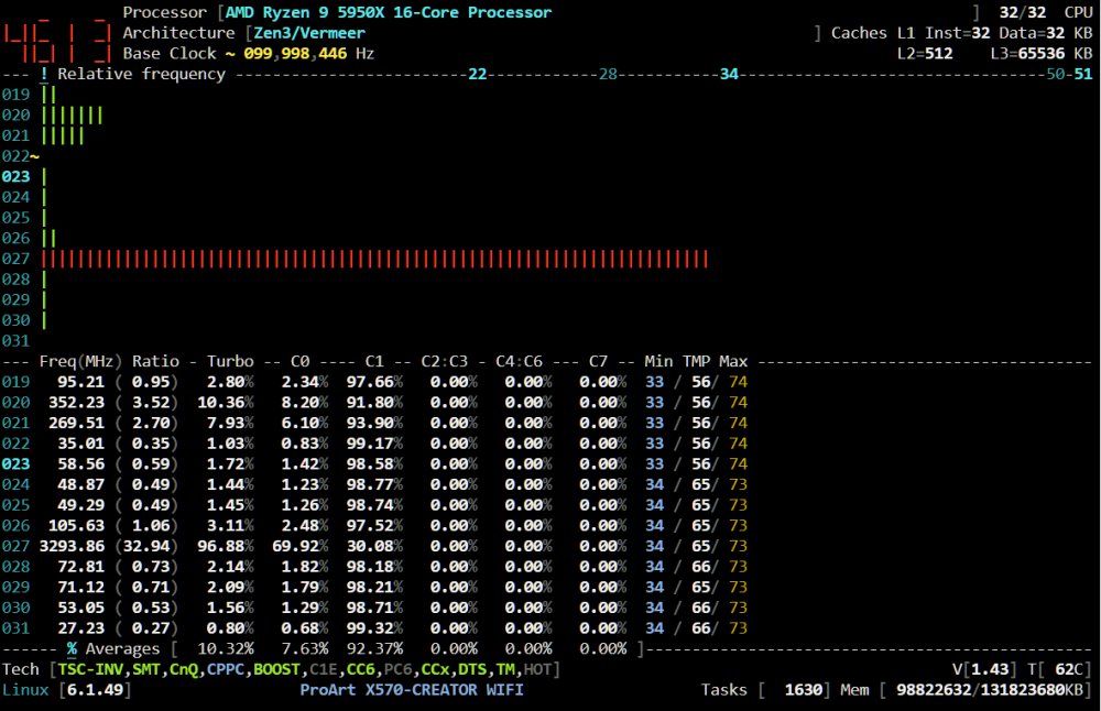

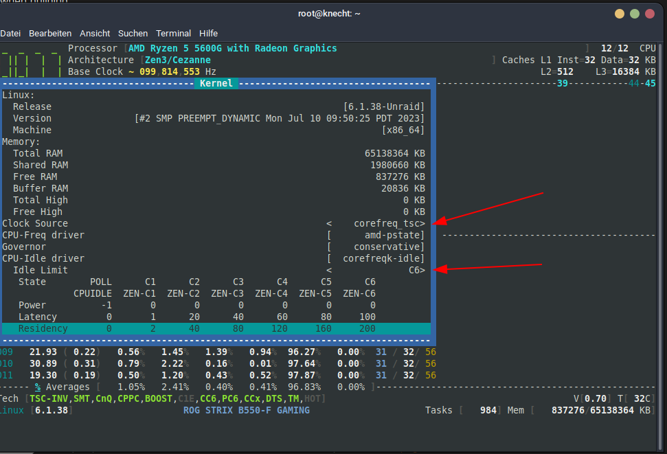

Ive got the same chip, how are you getting your c states so low mine only goes to c1?
Changing C-States happens in the "Kernel" window (k) but there are prerequisites like making CoreFreq the "CPU-Idle" handler.
Once confirmed in the Settings window (s) that "CPU-IDLE driver" is "<ON>" and a "CPU-IDLE route" is selected to one of the preferably Intel: M-Wait or AMD: I/O then you can select the C-States in "Idle Limit" selector

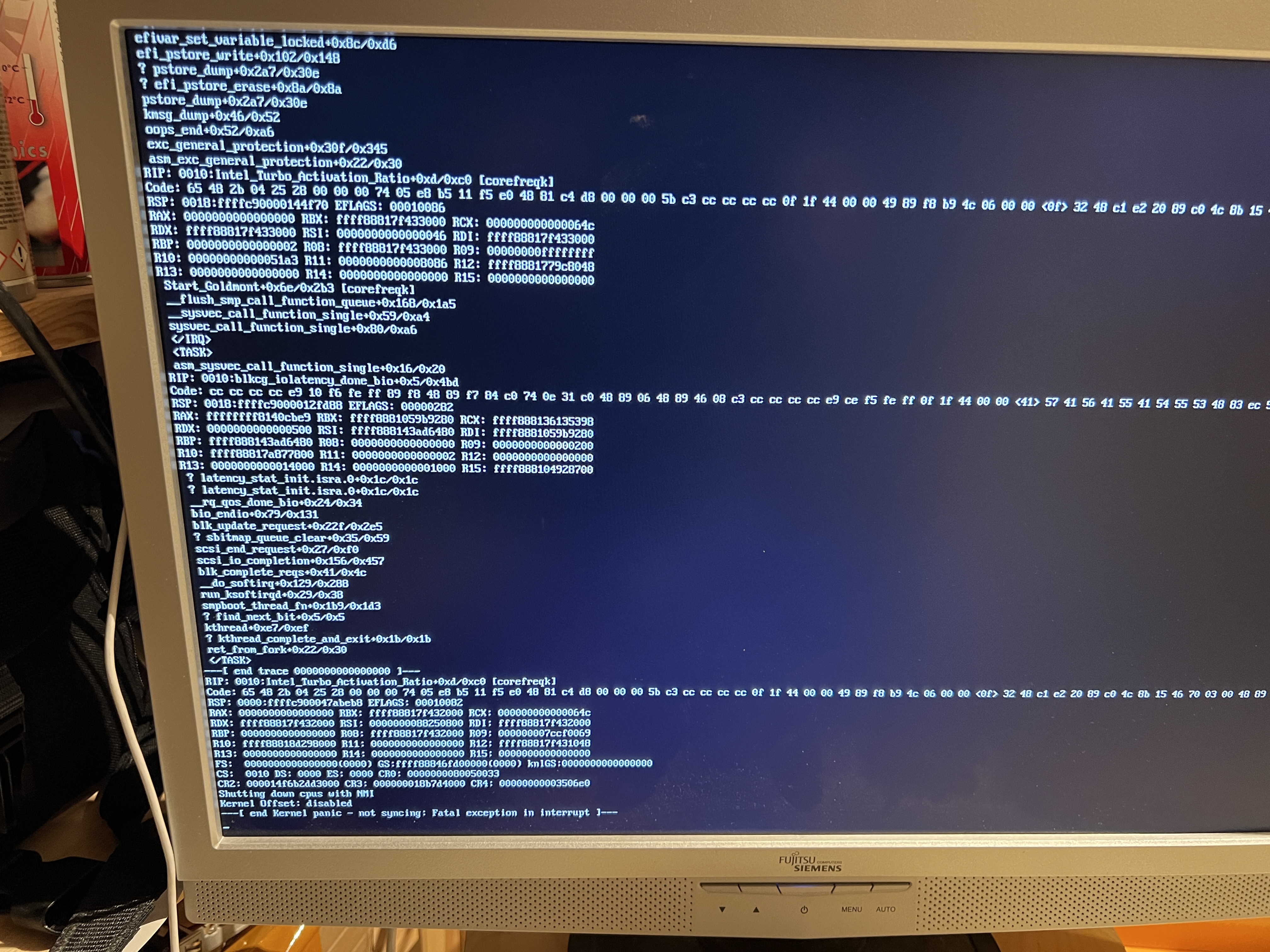

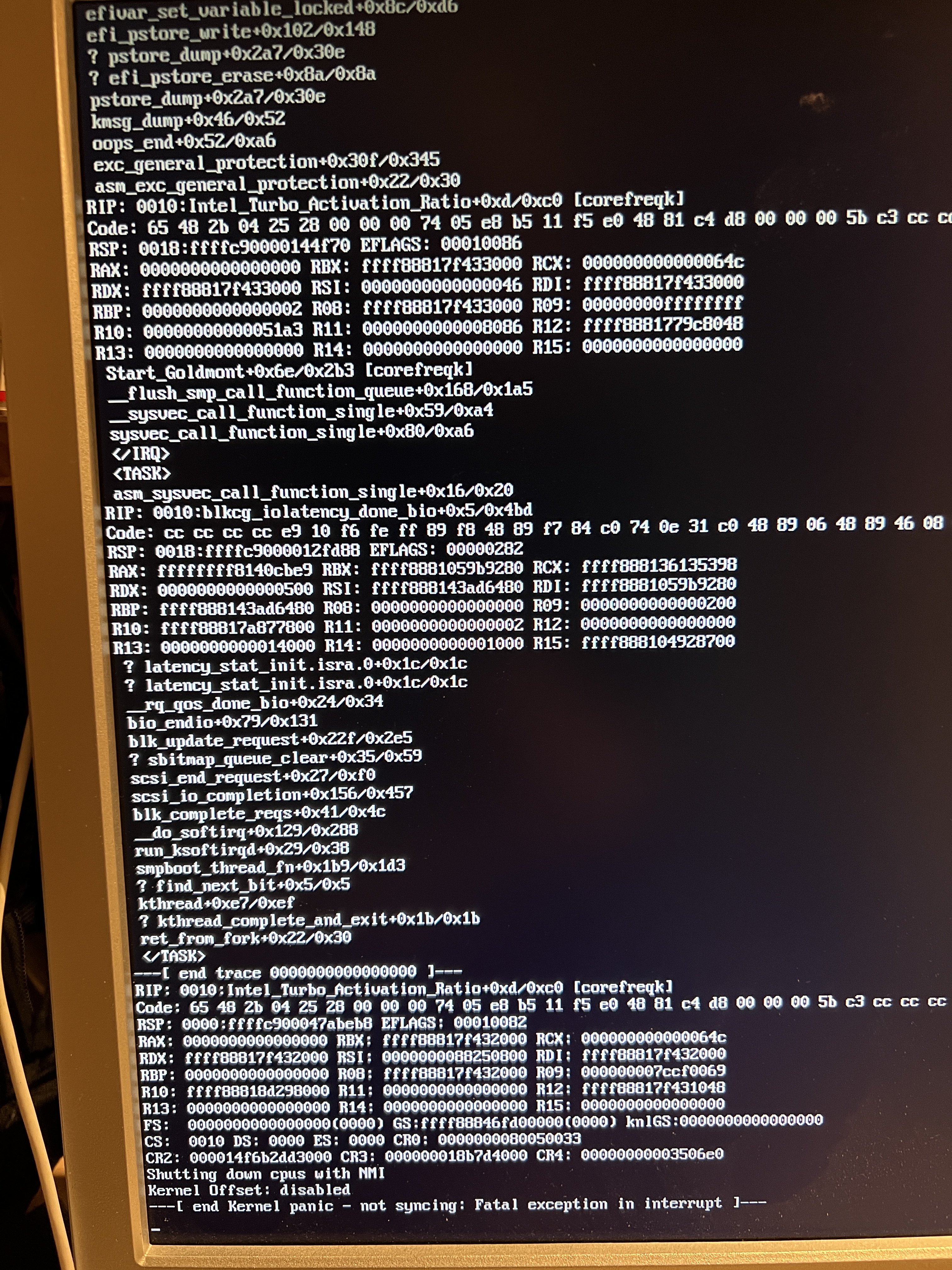

Hello,
Good advice to test the plugin with stopped array.
Unraid crashed. But I am not suprised, I installed Unraid on a QNAP TS-453Be as it got redundant.

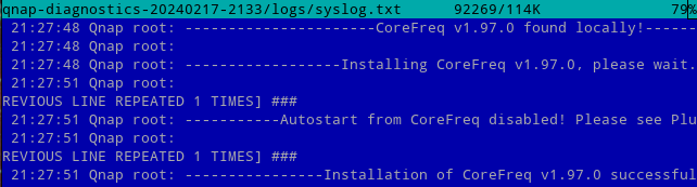

Here is the diagnostics:
qnap-diagnostics-20240217-2133.zip
Thanks for sharing
I don't find any issue in kernel log ?
The issue is if a crash happens it won't be logged because the syslog is not persistent between reboots.
@KaitsuN6 do you maybe have a monitor attached to your NAS where you can take a picture when the crash happens or enable the syslog server and post that here?

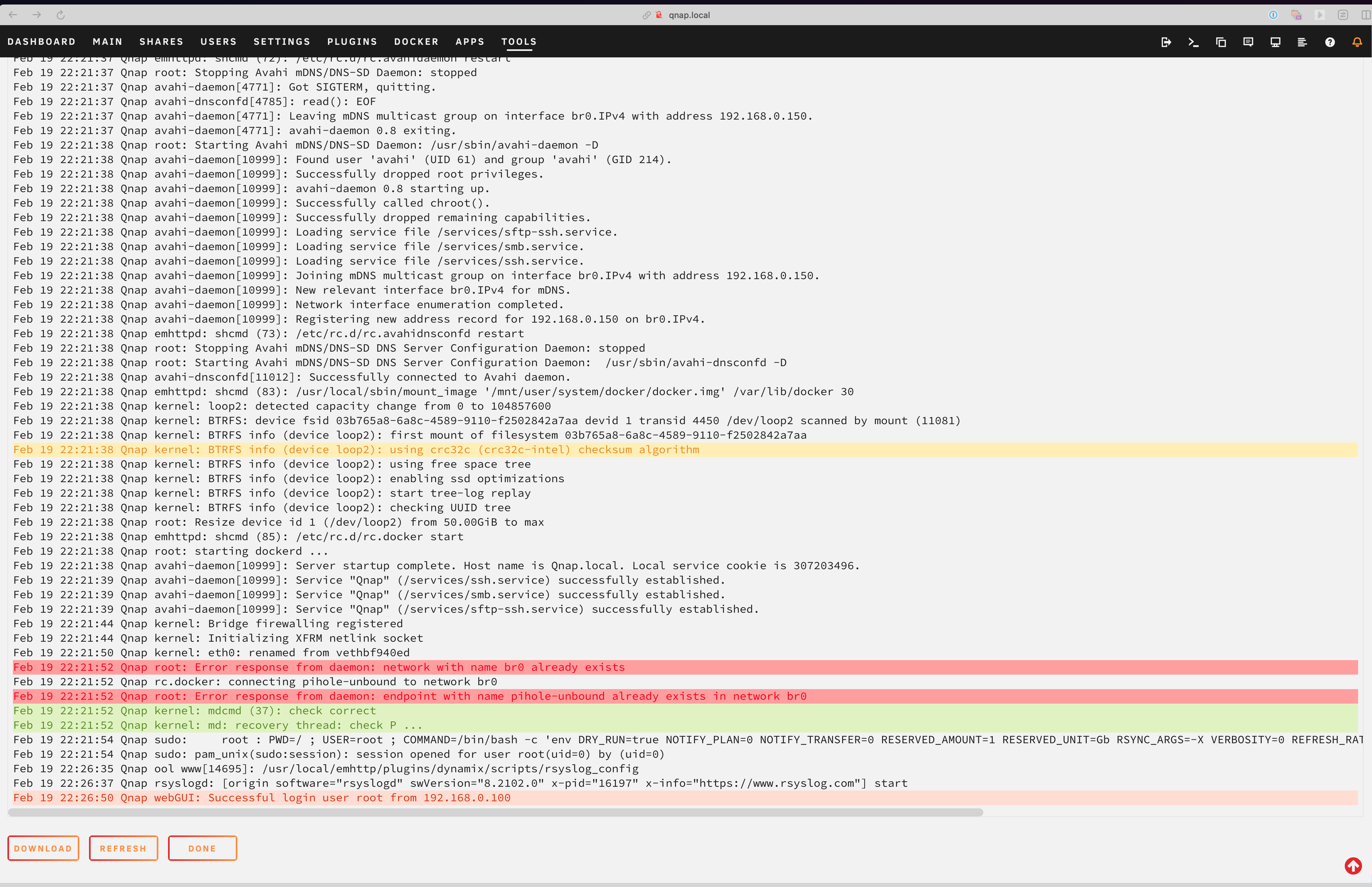

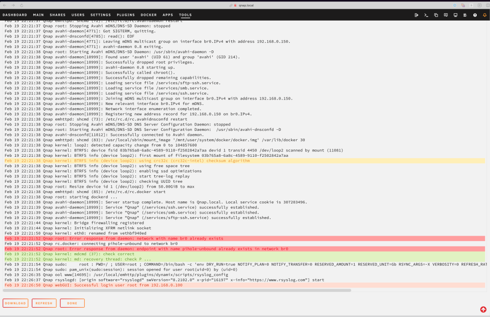

Hello,
Here are the "BSOD" of the test and screenshot of the syslog just before testing, and syslogs captured to the flash drive. I don't see any logging of the happening itself.
Just ask if there is some more I can test.
syslog syslog-previous
Ahh, stupid me. That was not the screenshot you wanted.
Maybe these are better?
Thanks I see the issue in MSR register 0x64c
Let's continue this issue on the GitHub.
