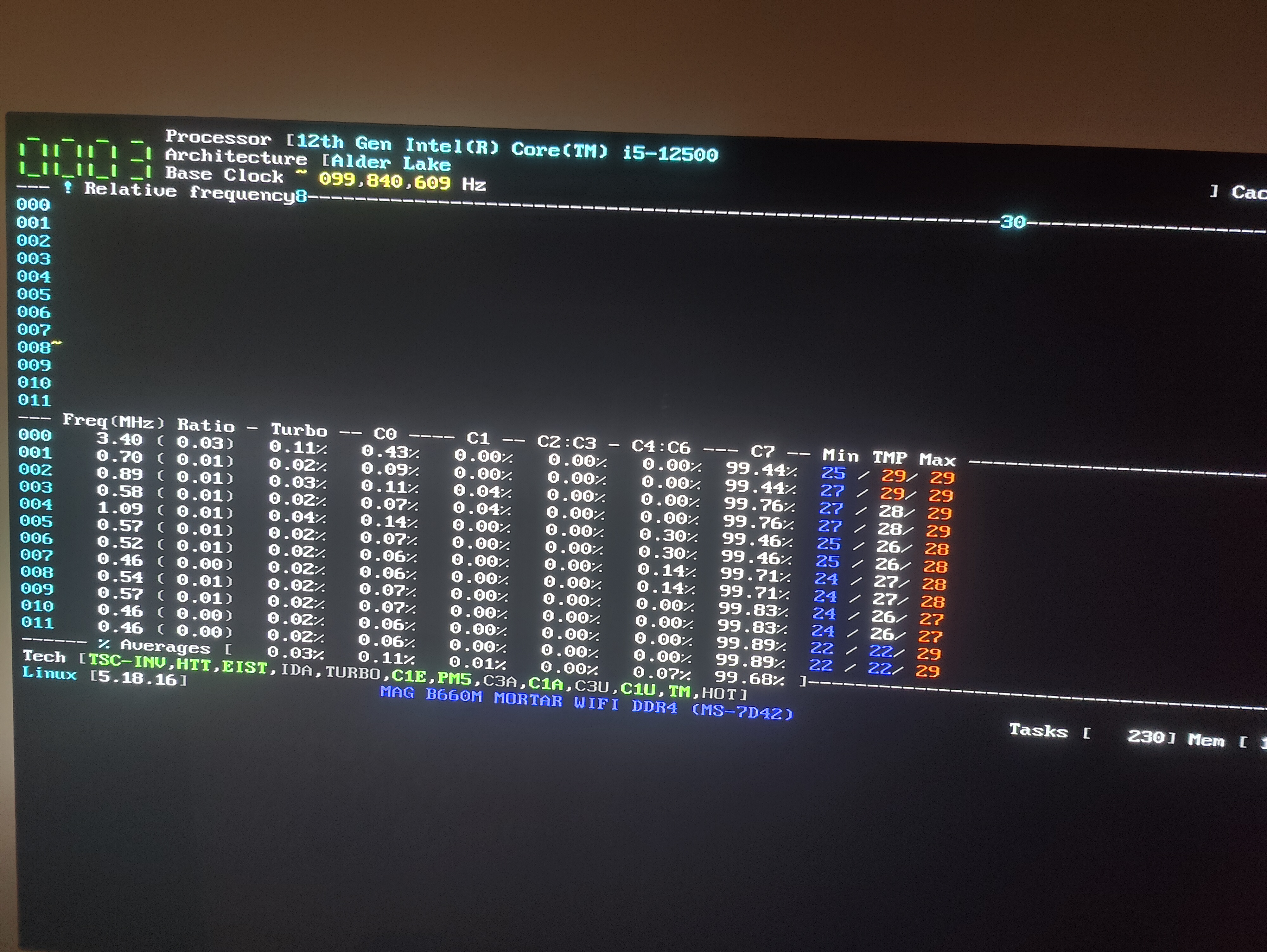

@ich777 Version 1.91.7 is fixing the Monitoring issue with Pcores only Alder Lake
Already saw that my server built it for the stable branch from Unraid, I've now also triggered the build for the next branch from Unraid and it's already built now.
@chchiyan to update your CoreFreq version simply reboot Unraid and it should download the newer version on boot (as long as if you have a active internet connection on boot), if not uninstall the plugin and reinstall it from the CA App and it will grab the new version.
@ich777 i've updated CoreFreq to newest version but still there is no data in CLI
From what I see it has pulled the latest version, on what Unraid version are you.
It is now built for 6.10.3 and also for 6.11.0-rc4 and should have all changes that @CyrIng implemented.
Version: 6.11.0-rc4
After CoreFreq is installed I'm just enabling autostart (deamon is already enabled) and type "corefreq-cli" in command line.
This is the commit of master branch which fixes i5-12500 monitoring.
@ich777 can you confirm if that change is part of the plug-in ?
Edited by CyrIng
Hmmm, seems it went something wrong with the build itself which is a little bit odd because it can't switch to 1.91.7 when building:
error: pathspec '1.91.7' did not match any file(s) known to git
Anyways I've rebuilt the packages again for Unraid 6.11.0-rc4 (and made sure that it switched successful to 1.91.7 this time) and it should now work.
@chchiyan please remove the plugin once more and re-download it from the CA App.
Triggered the build for Unraid stable 6.10.3 just now, will take a bit.
@ich777 ok, now it works :)
Edited by chchiyan

Jan 26 19:27:59 tower root: plugin: checking: /boot/config/plugins/corefreq/CoreFreq-2022.07.21.txz - MD5
Jan 26 19:27:59 tower root: plugin: running: /boot/config/plugins/corefreq/CoreFreq-2022.07.21.txz
Jan 26 19:27:59 tower root: plugin: creating: /usr/local/emhttp/plugins/CoreFreq/README.md - from INLINE content
Jan 26 19:27:59 tower root: plugin: running: anonymous
Jan 26 19:28:04 tower root: plugin: corefreq.plg installed
Then I have to remove and install it again and it finally works:
Jan 26 19:29:20 tower root: plugin: running: anonymous
Jan 26 19:29:20 tower root: plugin: corefreq.plg removed
Jan 26 19:29:25 tower root: plugin: running: anonymous
Jan 26 19:29:25 tower root: plugin: creating: /boot/config/plugins/corefreq/CoreFreq-2022.07.21.txz - downloading from URL https://raw.githubusercontent.com/ich777/unraid-corefreq/master/packages/CoreFreq-2022.07.21.txz
Jan 26 19:29:25 tower root: plugin: checking: /boot/config/plugins/corefreq/CoreFreq-2022.07.21.txz - MD5
Jan 26 19:29:25 tower root: plugin: running: /boot/config/plugins/corefreq/CoreFreq-2022.07.21.txz
Jan 26 19:29:25 tower root: plugin: creating: /usr/local/emhttp/plugins/CoreFreq/README.md - from INLINE content
Jan 26 19:29:27 tower root: plugin: corefreq.plg installed
Jan 26 19:29:37 tower  emhttpd: cmd: /usr/local/emhttp/plugins/CoreFreq/include/test.sh
Jan 26 19:29:38 tower kernel: corefreqk: loading out-of-tree module taints kernel.
Jan 26 19:29:38 tower kernel: CoreFreq(3:-1:-1): Processor [ 06_9E] Architecture [Coffee Lake/S] CPU [6/6]
Very easy for you to test this, boot your server without an active internet connection. Its 100% repeatable for me.
2 hours ago, Interstellar said:
Still getting the issue where I have to manually install it after start.
Thank you for the report, I pushed a fix for this, please update the plugin to version 2023.01.26
Have rebooted many times and it’s been spot on every time, thanks for the update 👍
