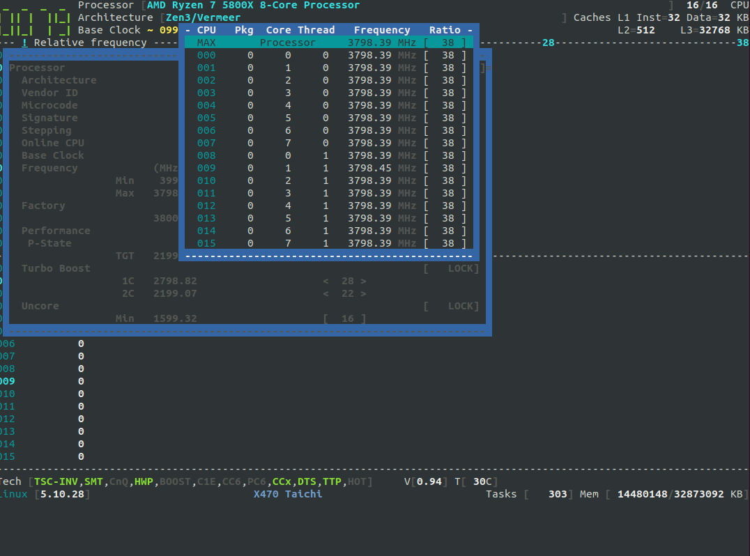

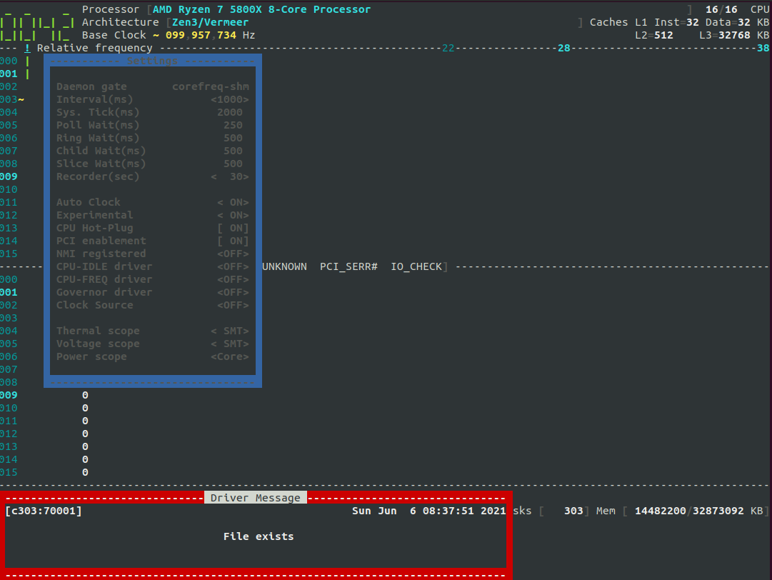

Set BIOS OC back to AUTO, only have RAM OC applied.  I am unable to change my CPU Freq past 3800 Mhz on my 5800X.  When I attempt to load the CPU-FREQ driver or the CPU-IDLE driver, I get this following message:
Here is what my Max Freq option looks like
The rest of the freq options looks similar, they all show the same freq even thought i have disabled turbo through the plugin.
Uploading diagnostics...
hammsandwich-diagnostics-20210606-0843.zip
This would be something for a Github issue: Click
