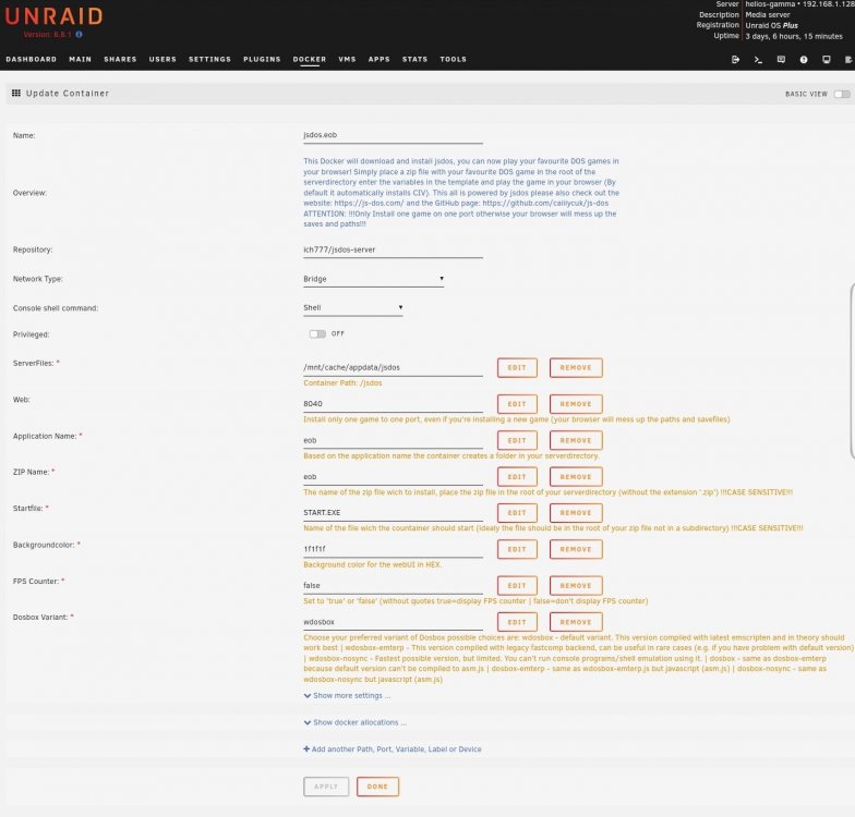

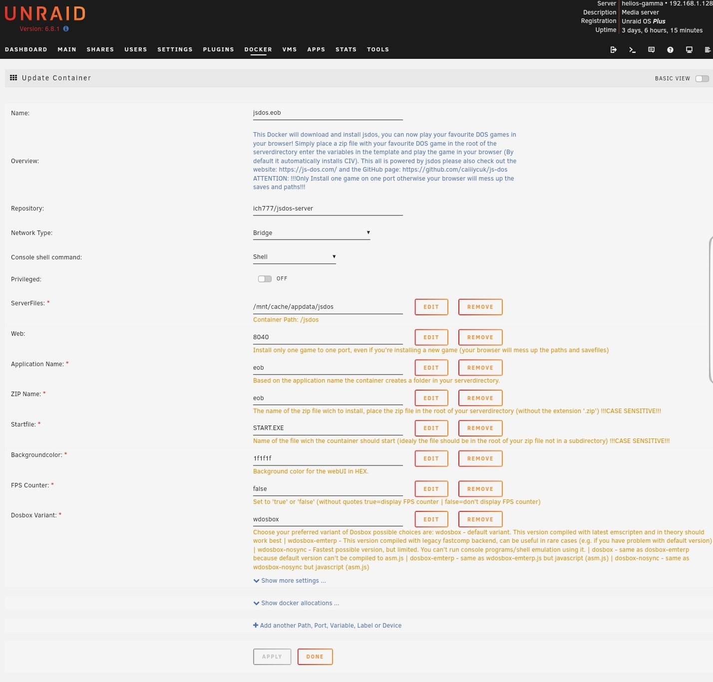

  8. Found the issue. I tried three games, Xanth, Buck Rogers (Matrix), and Eye of the Beholder. Xanth worked, but others did not. The difference with XANTH.zip? No sub directory. I removed the subdiretory from EOB and MATRIX and they worked (after refresh of the web page). Case closed. Thanks! This is so awesome!!!!
  9. Hey ich777, I tried out your js-DOS container and I can't get it to work properly. I'm trying to load my Eye of the Beholder. It seems to work in a web browser on this site - https://www.retrogames.cz/play_456-DOS.php But when I load it, the "fullscreen" button doesn't work and it doesn't load the game like it looks on retrogames.cz. First run logs read: and the website flashes loading some files but then nothing, and (as stated) the "fullscreen" button doesn't work (where it does work on the retro site). Let me know what else I can provide to assist. Thanks!
  10. No problem! Thanks for your time on it!!
